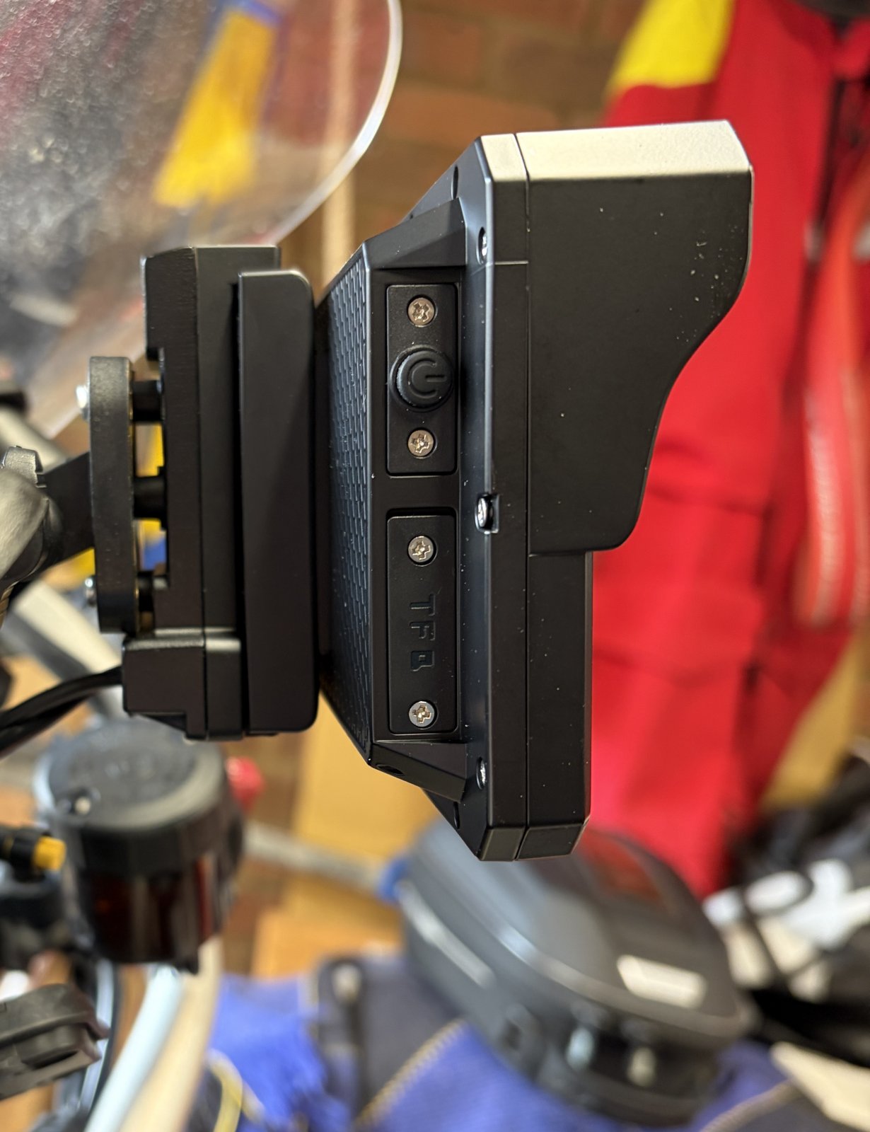

  1. I’m not sure that’s what I need, well the one I’ve seen as it adds to the distance.https://evotech-performance.com/products/evotech-carpuride-interface-plate-1
    im looking to minimise the distance as that reduces the wobble and stress on the fixing. For the time being I’ve modified the Garmin mounting plate, but I’m not really happy with it as the unit is hung on only two screws, previously it was four.

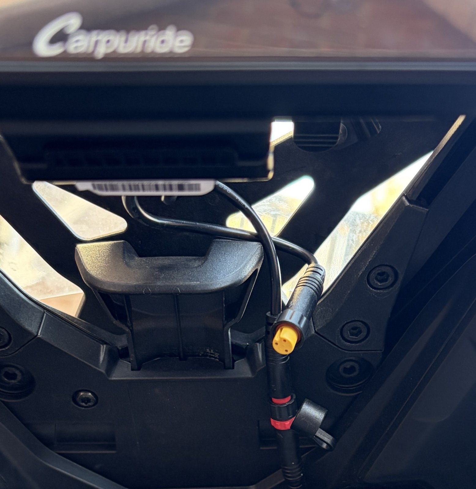

  6. It’s on and working, the mount needs finessing.
    What do people do with the unwanted remote control lead that needs terminating so it’s water proof?
  7. The temporary mount
  8. I can’t believe how easily it paired and worked, it may have taken 30 seconds. I haven’t attempted to customise it, but it’s not going to take much.
