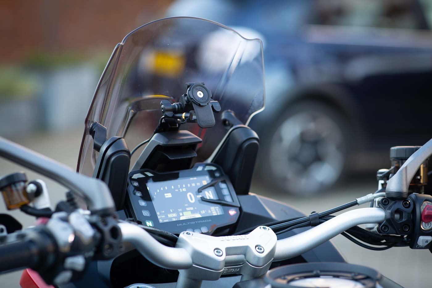

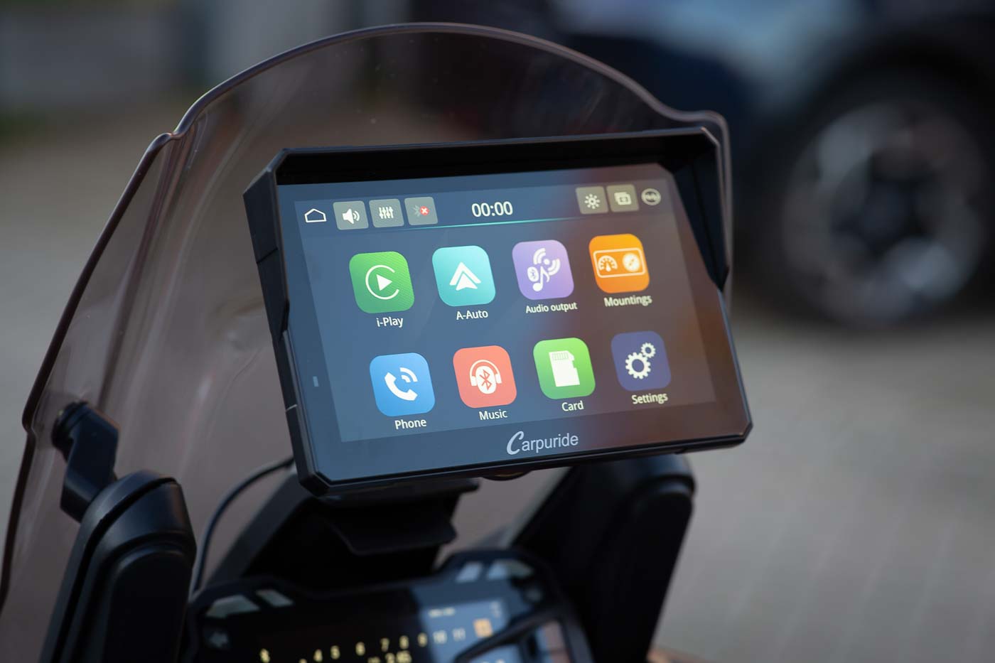

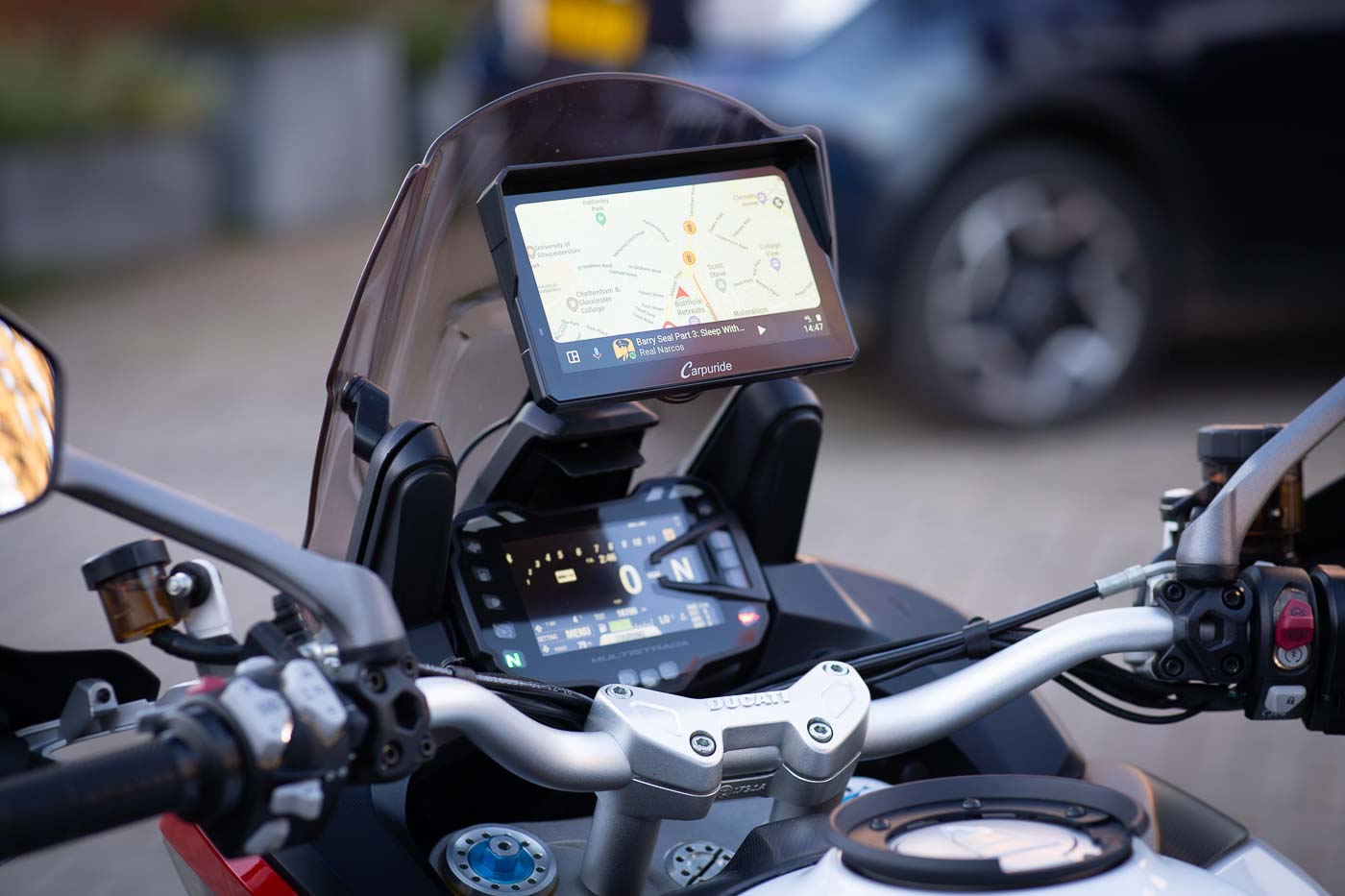

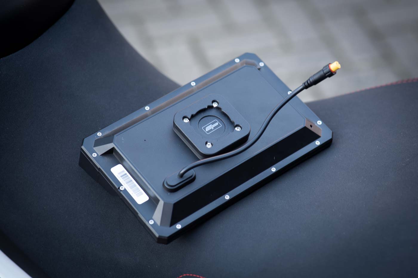

  10. I agree with @Veetwin, using the bike's Bluetooth is pretty pointless. Sure you might be able to control your media player and answer calls using the switchgear but for me that's too fiddly. It also adds another connection into the process, just asking for trouble. The Carpuride and its touch screen work better IMHO and connect directly to the phone. I'm using MRA mainly but also Google maps when I'm lazy. My phone is powered in the tank bag via a 12v USB charger that plugs into the DIN socket on the right side of the cockpit. This maintains the phone's charge.
    The Carpuride I have powered off of the GPS power source to the left of the headstock. Mount is an Evotech one with the QuadLock system as well as one of Evotech's QuadLock plates for the back of the Carpuride.
    Since the above photos I've created a custom boot screen and installed it onto the Carpuride. Create your own by using an image of the correct proportions (1024x600 for the W702Pro) and then using the generator here to create the installation file. You then put this onto an SD card to load onto the Carpuride.
    I've used this setup on a few rides so far, testing in earnest over the course of this year with at least one European tour already planned.

  11. Thank you very much I have got the iconic mount just ordered the evotech interface plate
    can I ask is there a way to scale the logo or photo you want to use to fit correctly thanks again

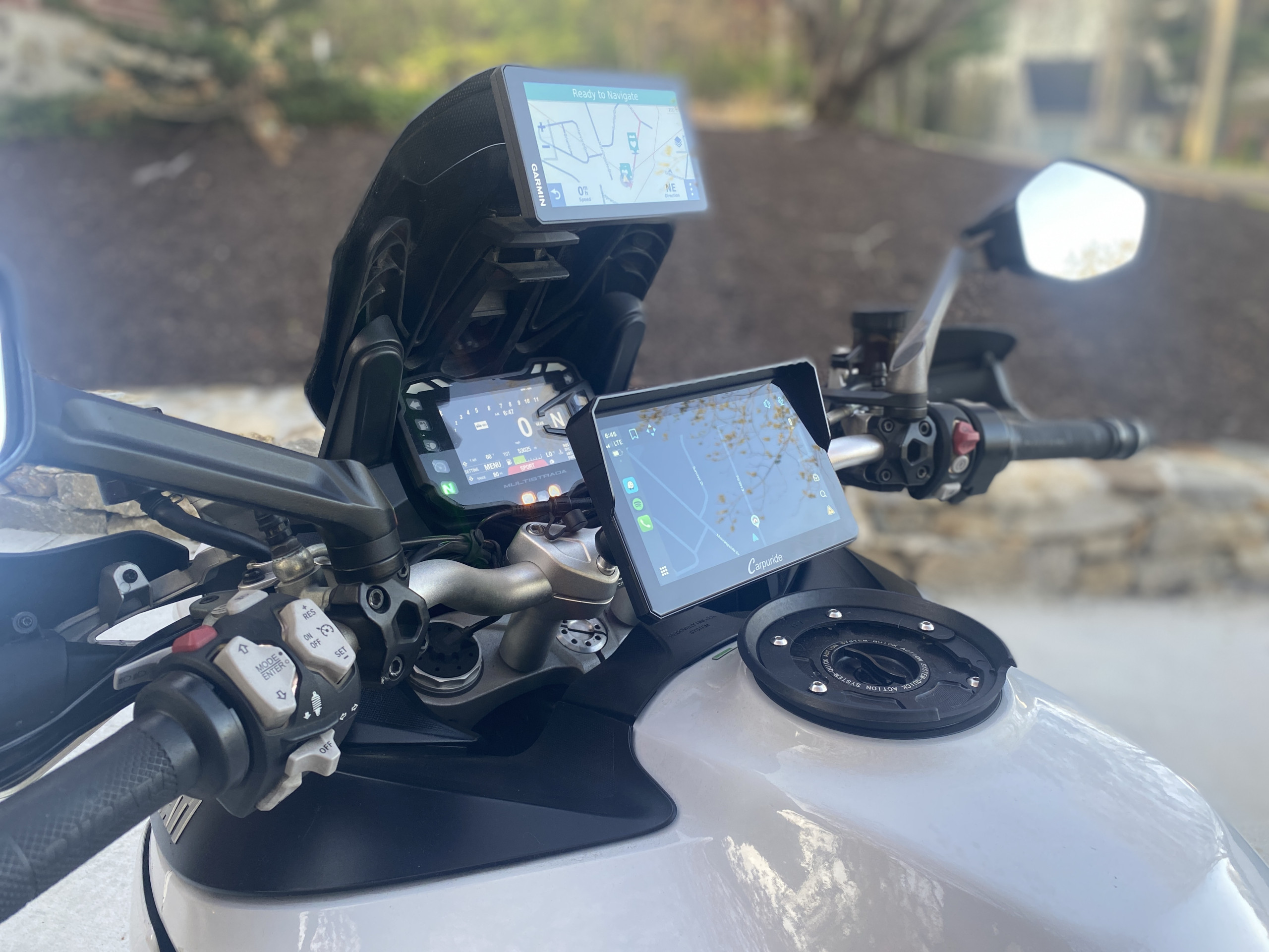

  12. I'm running iPhone in my pocket, Carpuride for music, Waze, Rever, text and calls, Zumo XT for GPX and creating rides, and Sena 50 for listening to music and speaking with others in ducati group I ride with. I don't use the Ducati integration.
    I'd suggest staying with the carpuride. Essentially, it’s CarPlay. I like that I can hear and see "Police Reported Ahead" using Waze, and a larger map for exploring is beneficial. If you have a iPhone, you'll want it in your pocket, otherwise, it may overheat, shutting everything down on you. Like someone else said, at lunch break, put your phone on a quick charger in your pocket, and you'll want to quick charge your comms. Get in the habit of doing at lunch and you'll always be good. The phone stays in the pocket because if in a crash, and you are separated from bike, you'll still have your phone on you to call for assistance. I ran carpuride straight to my battery. I can leave it plugged in and it doesn't drain the battery. My two cents.
    I was so impressed with Bumpkin’s photos, I tried to emulate them to share a different lineup view. Great photos Bumpkin! I’m not sure if having the Capuride at the top would appear to intrusive, or “in your face”?

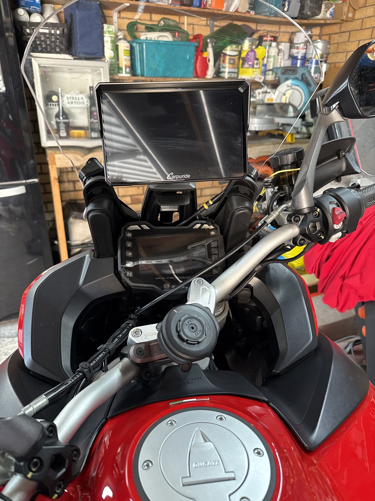

  13. I decided confirm the carpiride w702 pro wired into the nav connection on the last hand side really pleased with how it turned out I have also fitted a quad lock charge mount for my phone along with a phone poncho if there’s a shower and a MagSafe power bank so I put my phone in my pocket if there’s rain is really bad so think I’ve covered all bases I have attached a photo to be honest I’m just a bit unsure of the quad lock charge mount I don’t know if it looks a bit clustered image.jpg

  15. I think for it to work the image needs to be the correct size. I used Photoshop to do this, any halfway decent image editors will do the same.

    Having run a Garmin in that position for years and more recently my phone, I don't have a problem with it. Yes, it's a bit larger. I did consider the 5" version but my closeup eyesight isn't that great so bought the 7". As I almost always ride with a tank bag a lower mount doesn't work for me, also moves the screen further from my line of sight.
