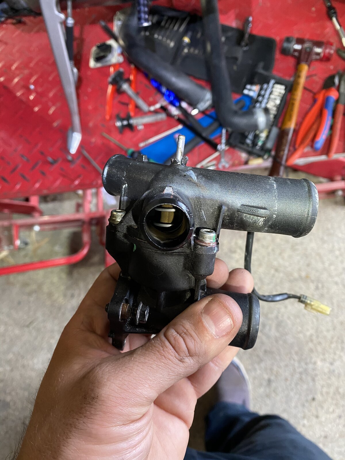

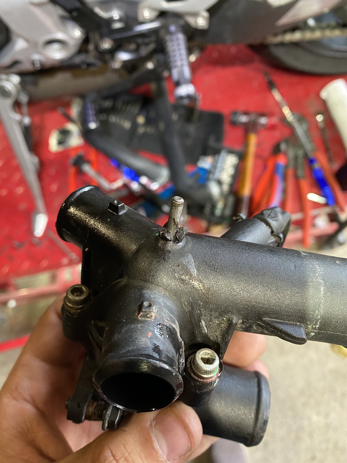

    My 2015 1299s started overheating due to a recent and sudden coolant leak.
    I think I may have found the problem
    Anyone seen a failure quite like this ? Centre pin of the thermostat appears to have fired itself through the roof of the plastic housing
    Anyone know anything about upgraded / metal versions as this seems a ridiculous design and choice of materials
    Or any good quality supplier selling robust / genuine parts
    Cheers
    Moose

  7. Looking at the design, the pin is what keeps the t stat seated. using a plastic housing with no load bearing surface.
    this was just waiting to happen.
    Unless Ducati have modified the original design, this will happen again.
    Take it to a dealer, and E mail Ducati UK, there may have been a recall for this fault.
    Also might be worth asking for a new housing as a goodwill gesture, for a crap piece of design.

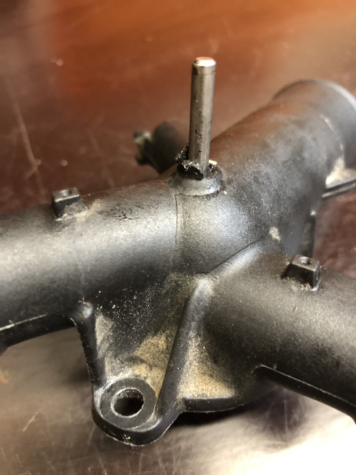

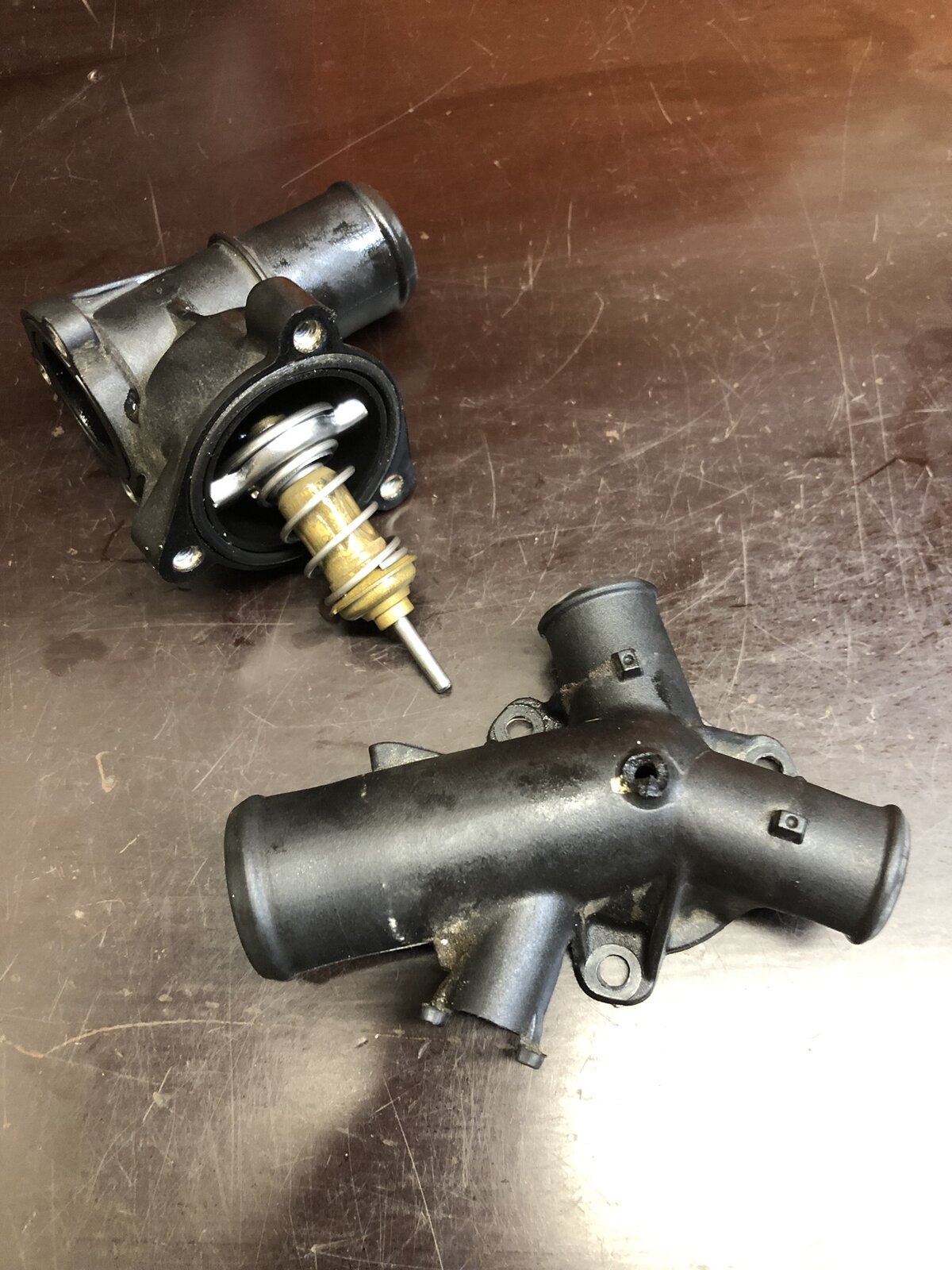

  8. yes, crazy - a "before" shot below.
  9. Yeah seems quite strange they decided to have the pin rest on thin plastic like that. I might enquire to find out what changes were made to the updated thermostat! It’s interesting this happened on a recent track day where the temps were very warm. And the bike was running at 102c. It never went above that though. And it appears that as it gets hotter the thermostat extends as designed to close off the passage to allow all the coolant to run through the radiator fully. My theory is when it gets too hot the thermostat just keeps applying more pressure where that pin is seated and just pushes through the casing. When I boiled the thermostat in hot water to test it near 100c it actually shot the pin out!
