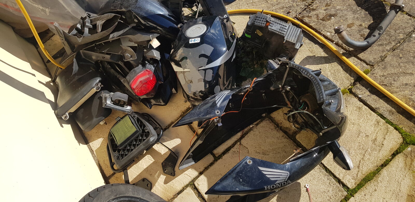

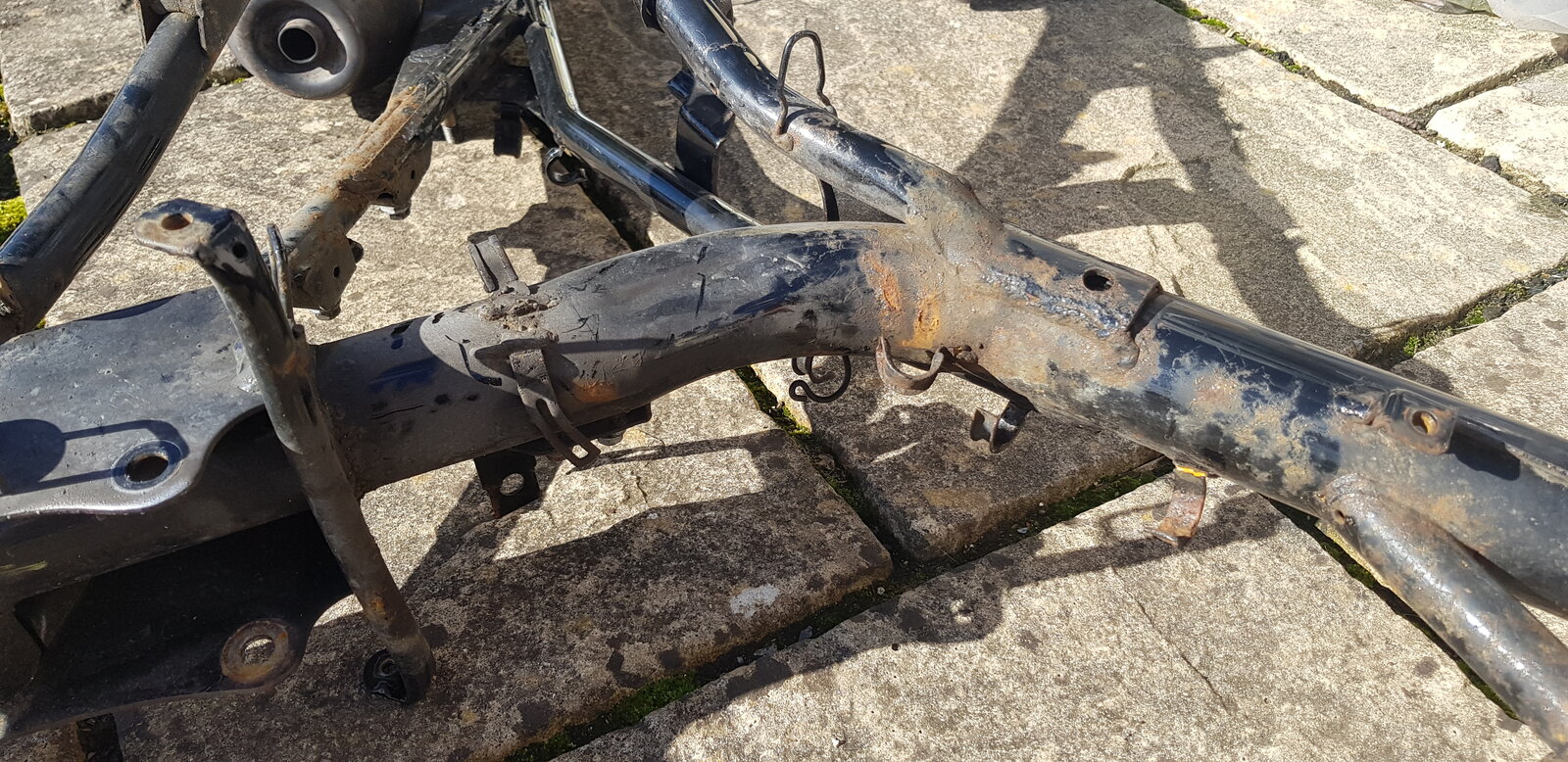

  1. Never expected to be doing anything like this (well, not to something thats not mine!). Ive said in a few other posts but a lad i work with got totally shafted by a local bike shop. At the time i never really looked that close at it but the more and more stuff started to stop working on it the more and more i stepped in to try to help. He has no garage, literally no tools and its his first bike, and being the sort of person i am i cant stand idly by when i have a lot of resource at my fingertips. So, after various odd saturday mornings in my garage weve gotten to this point. He's not mechanically minded as such but is happy to try. The rocker cover was pissing so much oil it starved the mains so, we took the decision (well, the point where i put my neck on the block) and offered to help strip the thing to the frame and get everything sorted out. Its also a cat C (i think thats the one - panel/light damage)

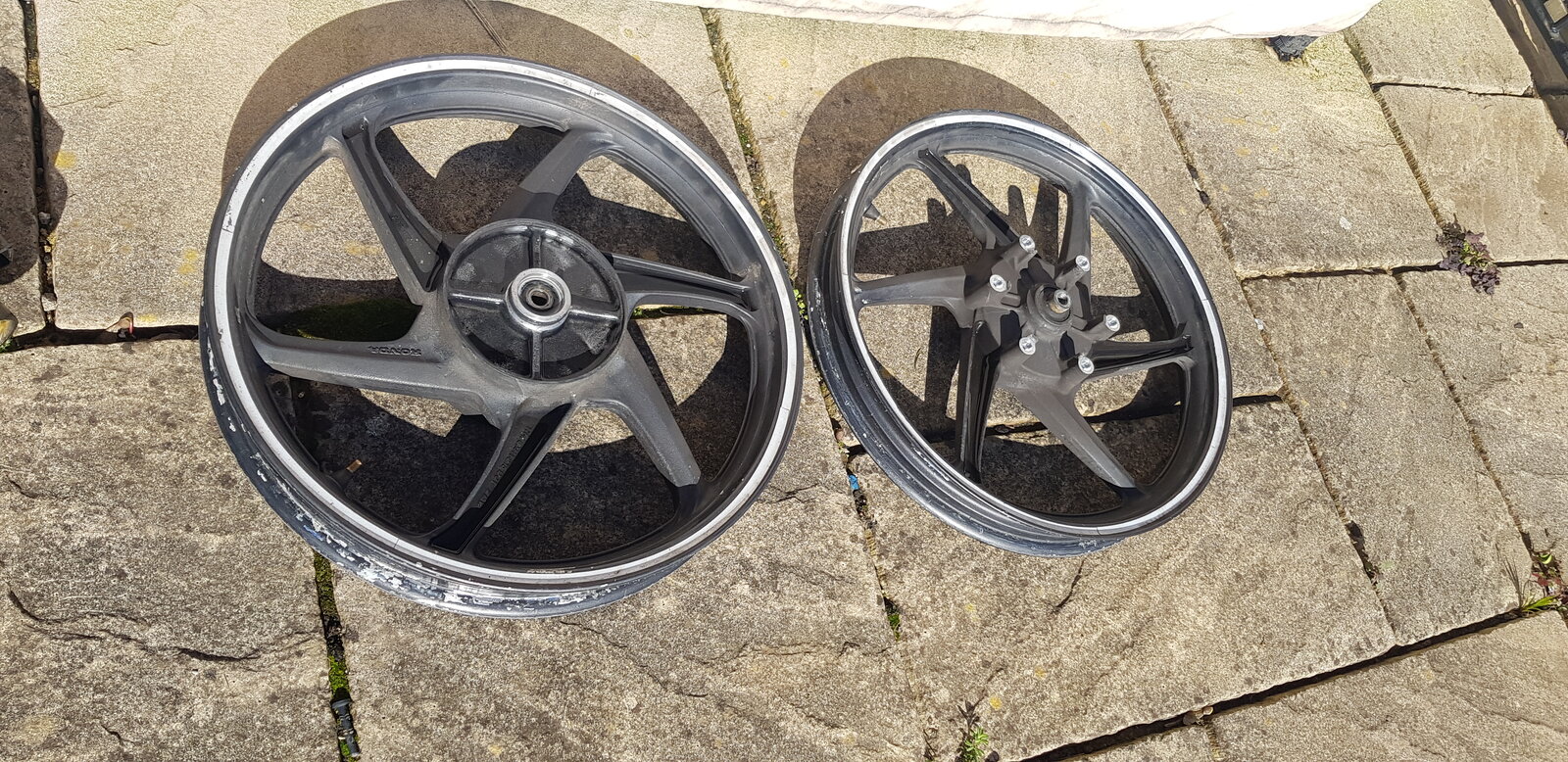

    Today, this morning we started. 10.30 the first spanner loosened its first nut. By 4.30 we had stripped the bike to the frame, took the wheels down to the tyre fitter to get the tyres taken off. Dropped the motor round to my mates house to have the engine split.
    Finally sorting the bike out in to piles for...
    Coating - frame, swing arm, wheels, loads of small odd parts like headlamp mounts, brackets etc etc
    Cleaning - pretty well everything else as its all covered in shit from the road, grease, oil etc etc from the last 7 hard years of its life.
    Storage - Bodywork, tyres, electrical etc etc
    I should have got a starting pic but didnt really think about it...kinda just concentrated on getting stuck in as it were...

    Ill take a load of photos tomorrow of the carnage...

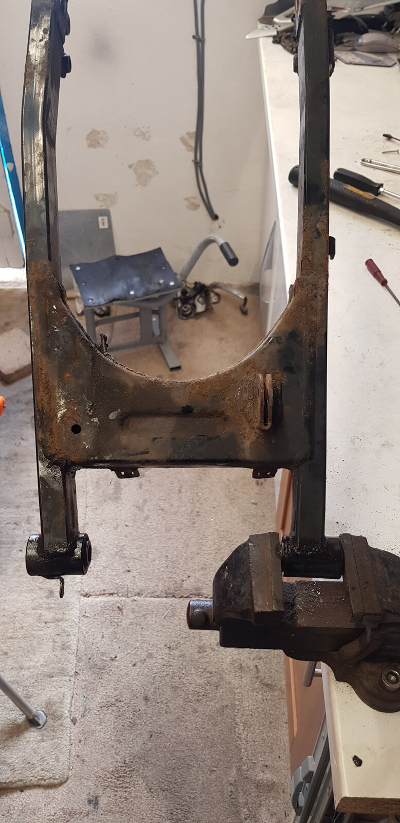

  7. Had a couple of hours in the garage this morning....
    Bearings pulled from the wheels
    Put some waste bolts in all the stuff that's going to coating
    Stripped the footpeg hangers
    Various pics...
  8. Swing arm is a bit of a conundrum... The bushes are in there solid.... Ive not got a very large vice so I can't grip the bushes... The fiche on the fowlers spares site list the bush but nothing else.... Think I need a bigger vice..!

  16. Boot currently full of bike bits (Frame, swing arm, wheels and a washing up bowl full of assorted bits) ready to drop down to the powder coater at lunch time.

  18. yep - theyre made out of pig iron...this particular one i dont think has seen a bucket of water, or a bike cover - ever....it literally looks like a pile of scrap in the back of my car...
