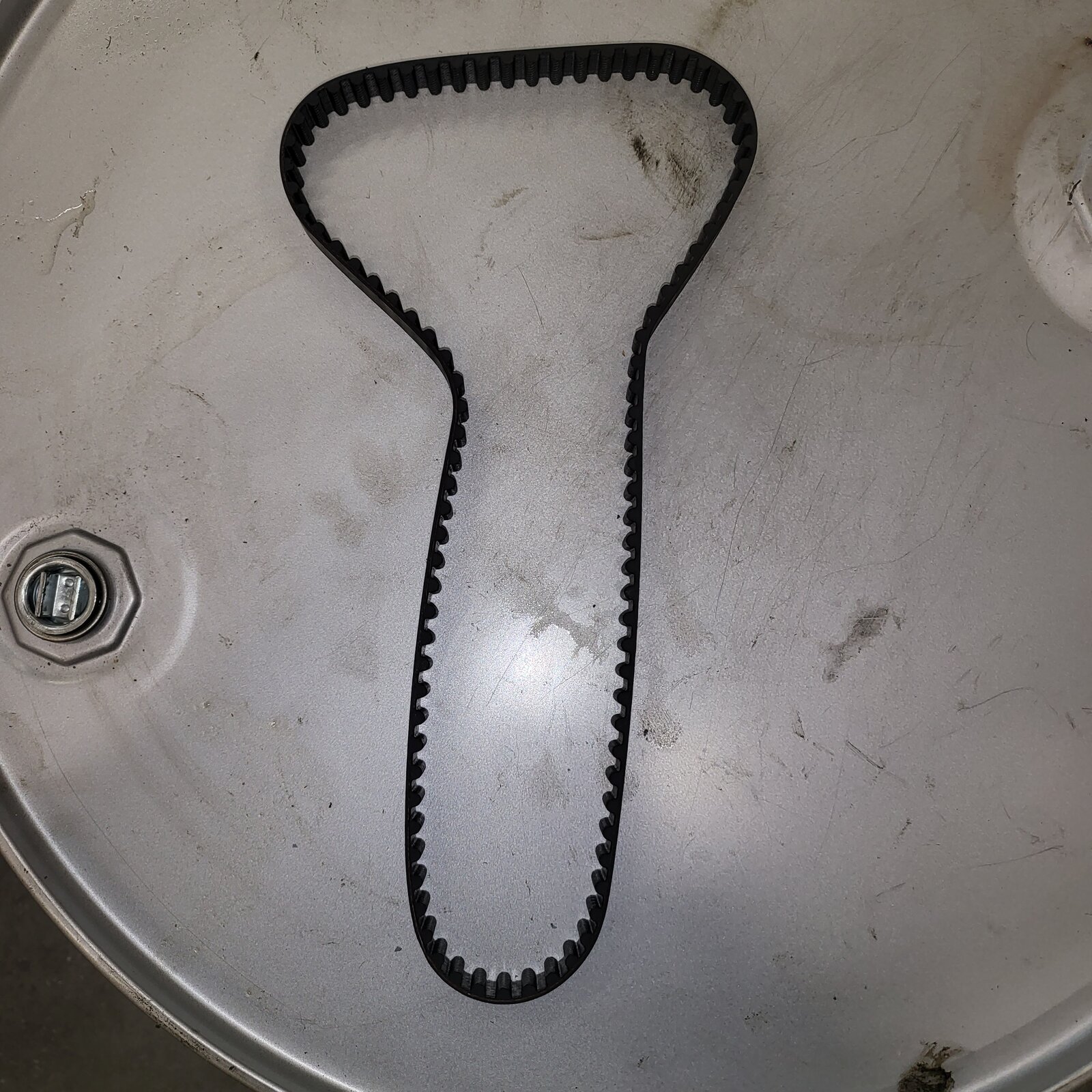

  5. I have been using CCW belts on my 999 since I bought it in 2015 without issue. The last ones I fitted had only done a couple of runs on a Dyno and due to a head gasket failure I had to remove them again. The marks on the outside of the belts showing the teeth positions had appeared already so I wouldn't read too much into that as an indication of belt integraty. As for service intervals, I replace them myself so the cost of belts against the cost of failure is a no brainer for me, 5000 miles or 24 months.
    Each to their own.
  6. Just got 4 years from a set of Ducati belts on my 998.
  7. Might be ok, might not :thinkingface::thinkingface:
  8. Mmmmm, perhaps not.
  9. I don't think it takes long before a belt will take the shape it sits in.
    My 5 year old belts looked like that when I removed them but now that they've been languishing on a shelf for the last couple of weeks they have returned to (almost) a normal roundish shape.
