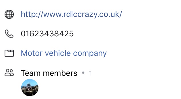

    I couldn’t find any prices on the Zeeltronic website (Slovenia) but above is the UK agent’s details and phone number.
    • Useful Useful x 2
