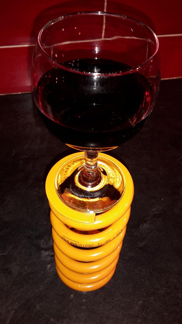

  1. Saw Glen at MotoV last week and he tweeked the stand up a touch but could not see anything majorly wrong. Recommended I visit FTR (Beazley End) about 15mins from me:) I visited James and Pete at FTR today and they measured sag etc. Diagnosis was I need a heavier spring. Up from 95 to 105. Will be fitted next week so I will report back on that. 10 housepoints to @johnny and @bradders :upyeah:

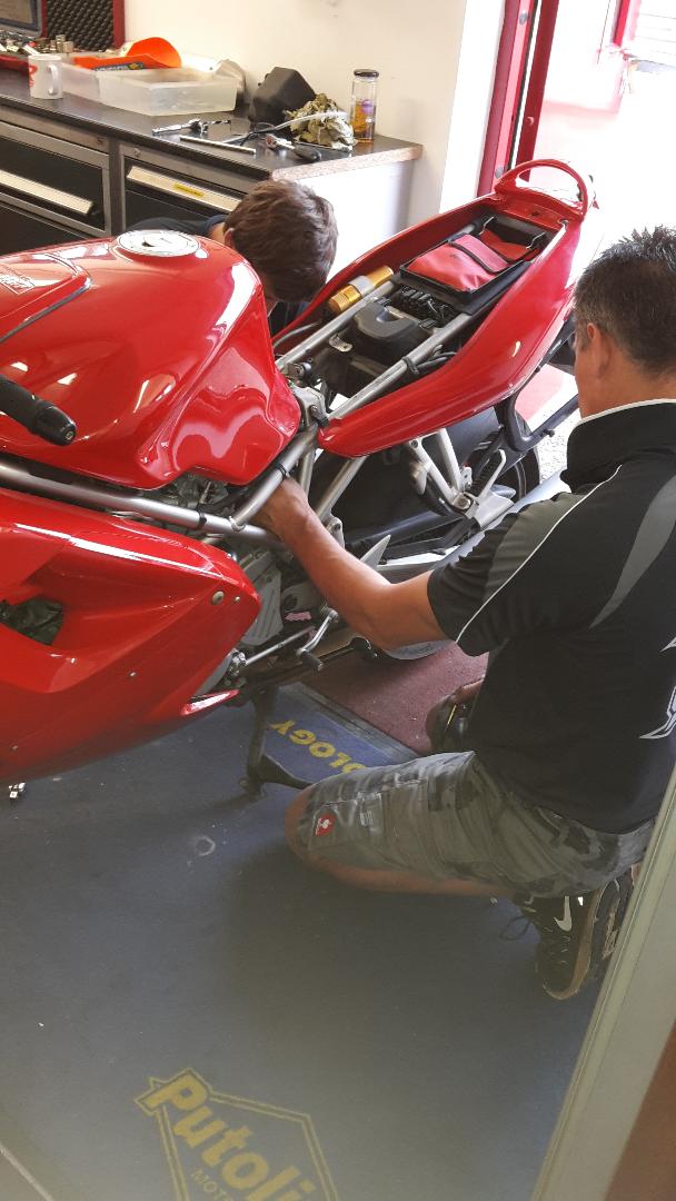

  2. Visited FTR today for the spring change.
    James and Pete got on with it whilst I had a cup of tea and made use of the wifi to do some of my less interesting work. Much appreciated as it saved me taking time off,
    With the new spring in situ the sag with rider onboard was set to 41mm. Previously it was 60 with the preload wound all the way in.
    The shock itself, at the back, was given a clean bill of health but James spotted the front set-up was out half a turn from one side to the other so this was matched.

    With the baseline set-up I now have, I am happy things are going the right way and with FTR still available for advice and assistance I am glad I took the trouble to sort this. Spare spring is being put to good use this evening
