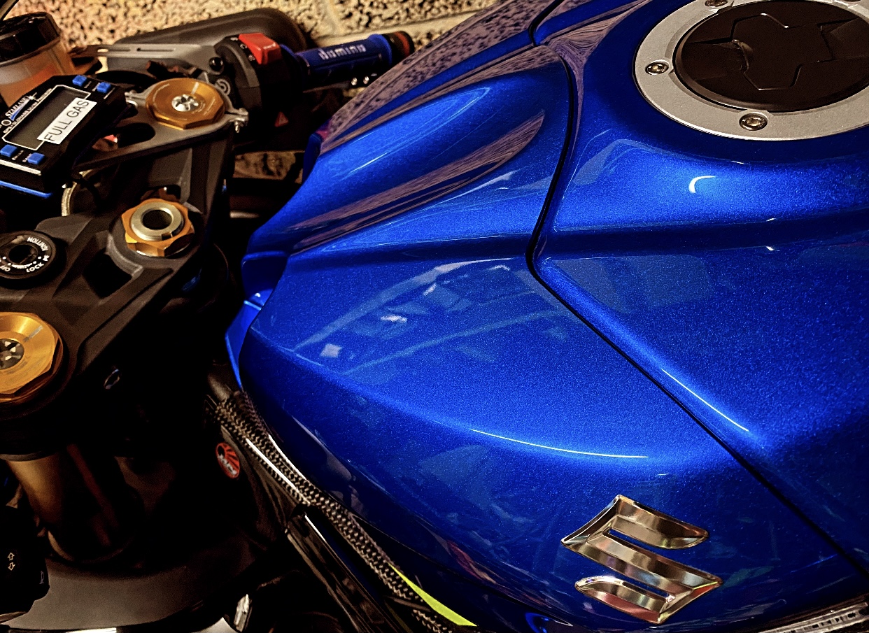

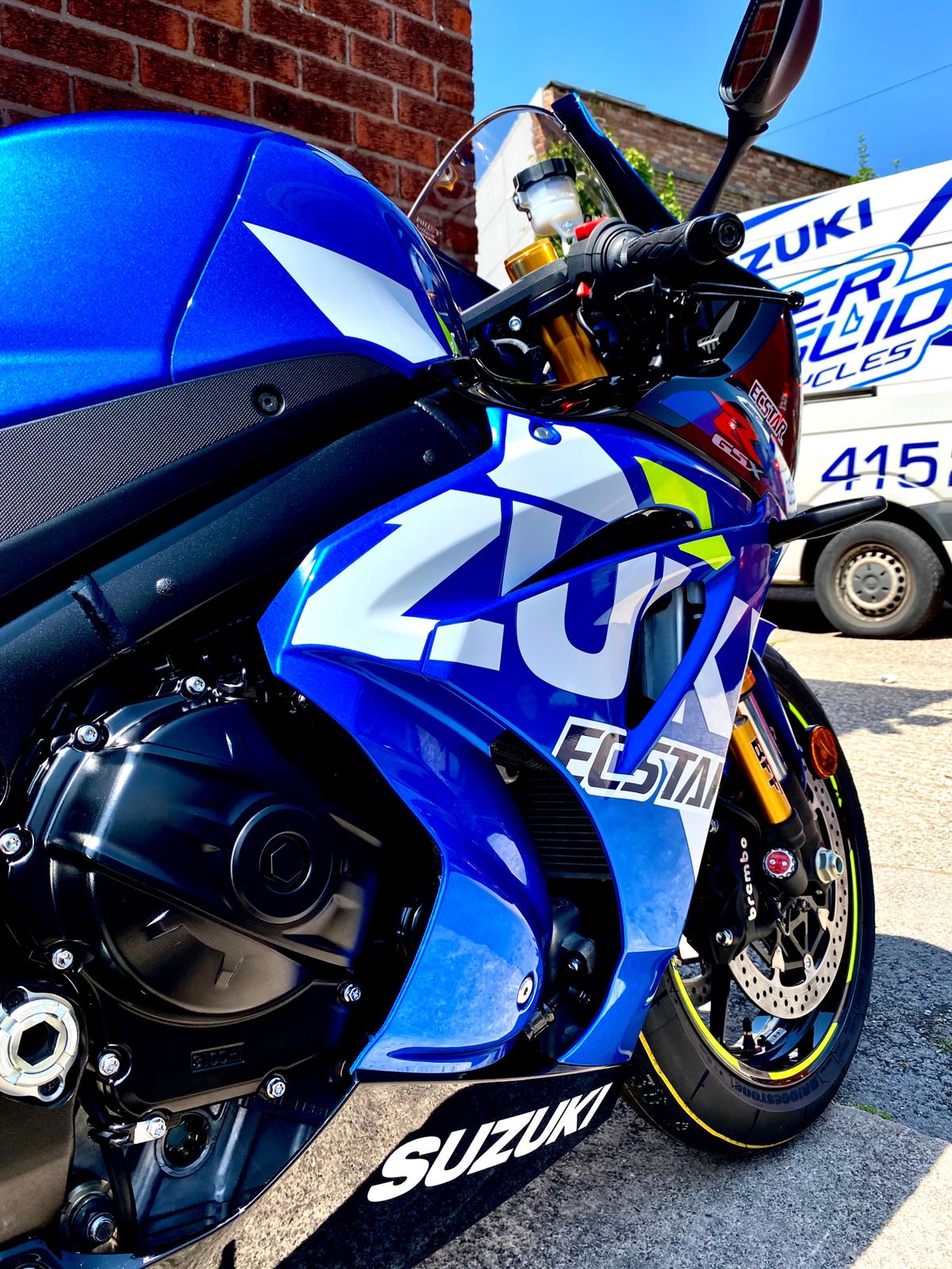

  4. B4B84025-5326-4B08-939E-2AB330D35CCE.jpeg 68B424EF-1BFF-47F8-A402-DC978D94FC66.jpeg
    Yes. My gsxr was done by my good friend. He’s an ex professional racing driver and does a lot for Mclaren etc (I’m always happier when I know my stuff is with a fanatic)
    I can put you in touch with him if you’d like

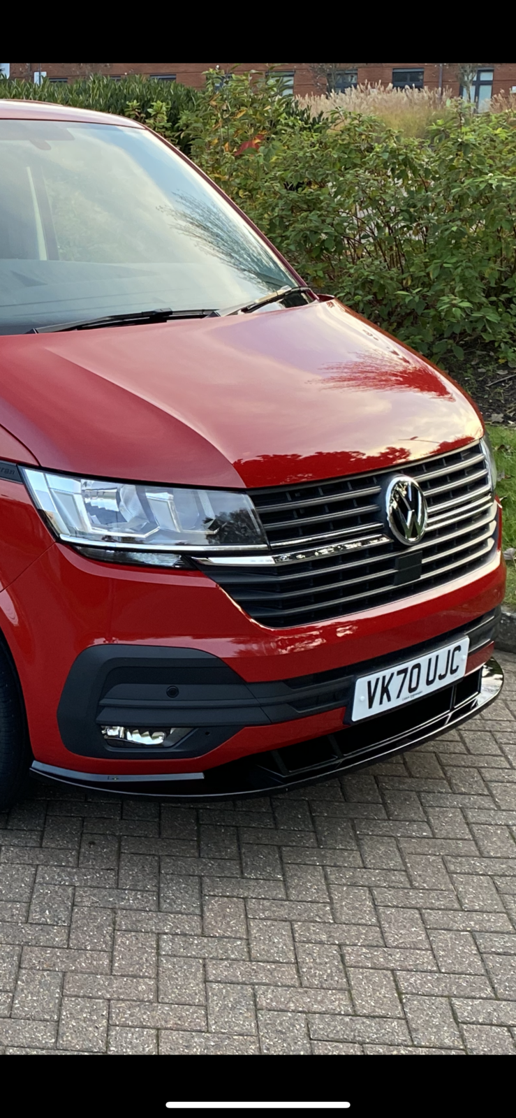

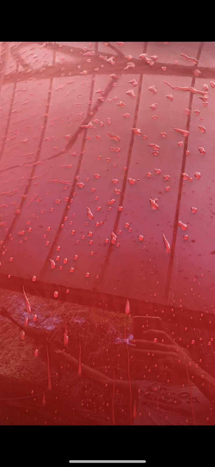

  6. My van that I recently sealed

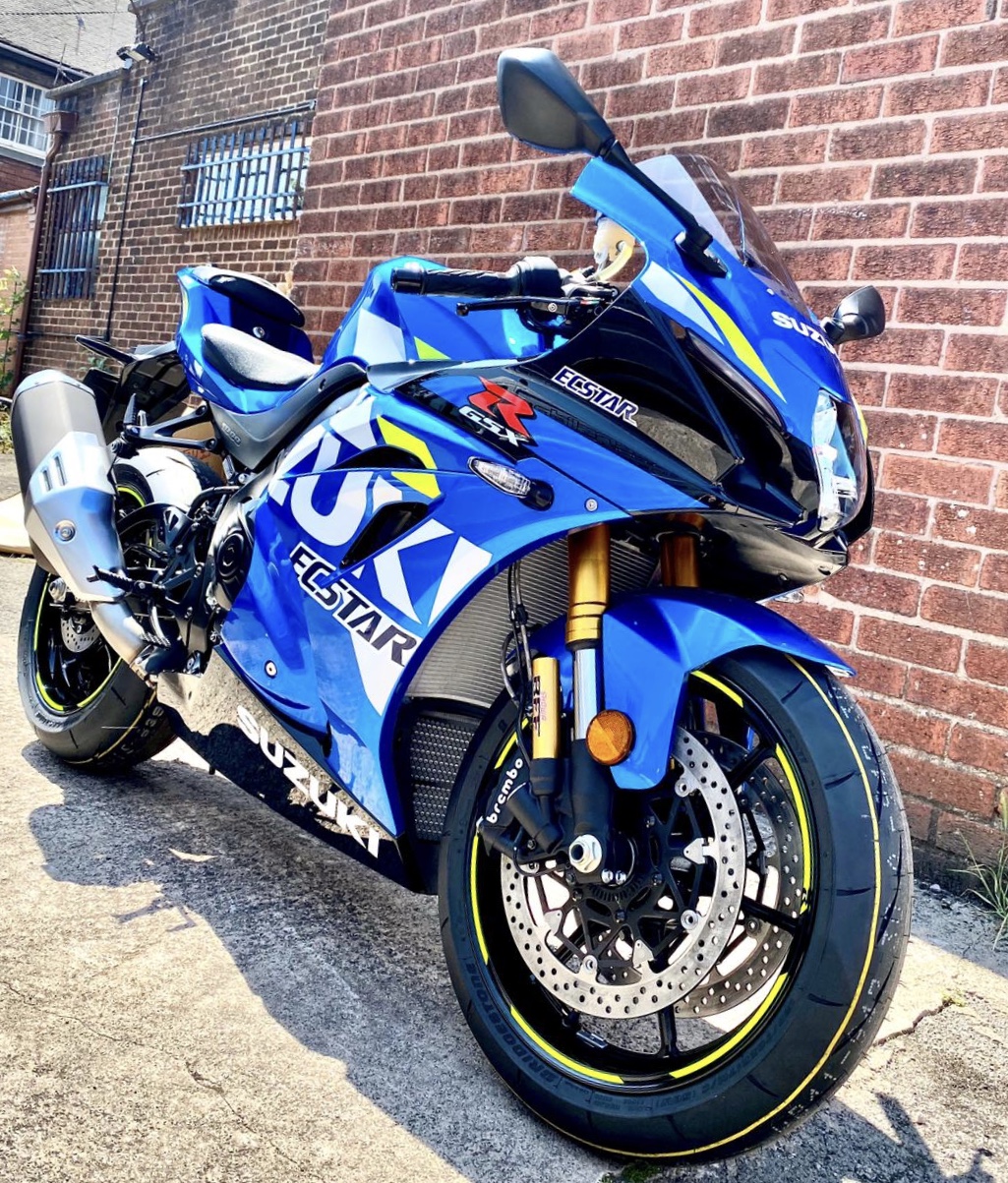

  7. Got this done a few years back and still looks too notch

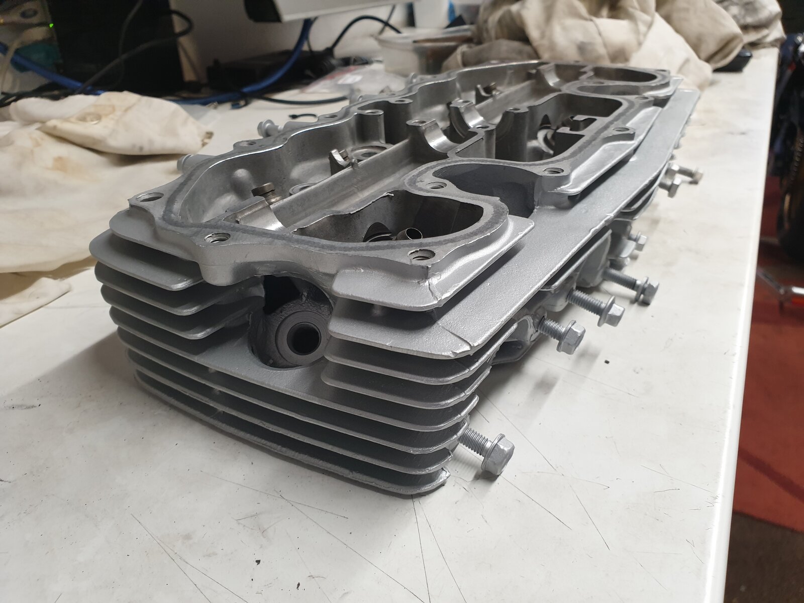

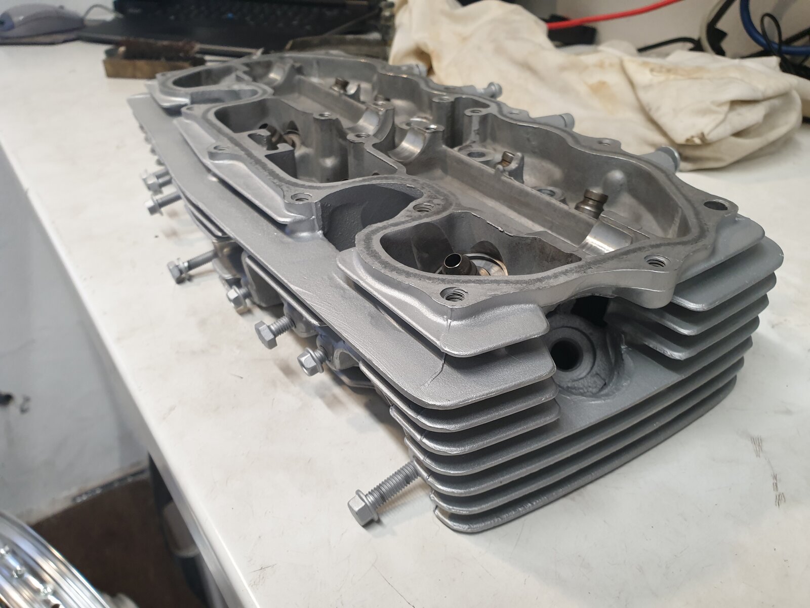

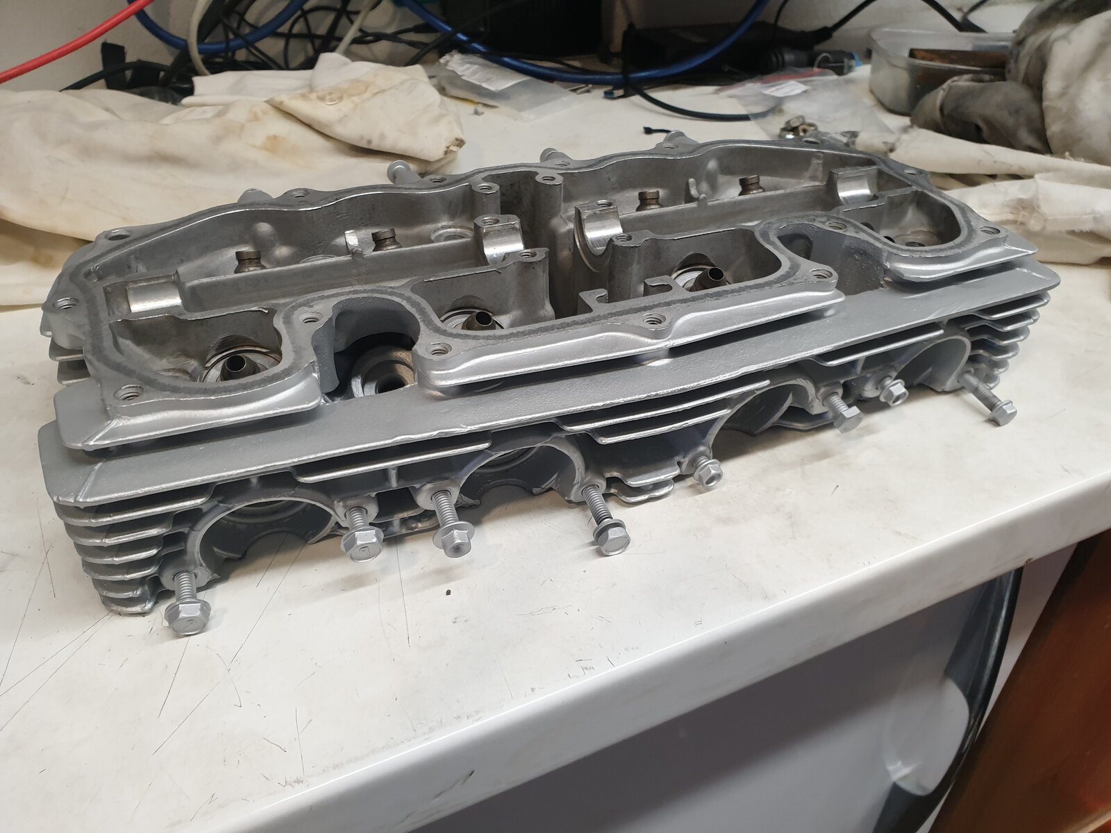

  13. I think were talking about 2 different types of ceramic coating....i had the header pipes coated on my RSV4 which lasted about.....an hour...as soon as some road dirt/oil/whatever stuck to them it got baked on and never came off....total waste of money....i think the above lad is talking about some sort of bodywork coating....of which ive never tried anything apart from a can of Mr Sheen or WD40 silicone wax....
  14. Ah. What's the coating you put in your bikes then?
  15. Cerakote and Xylan (when i can afford it).....in fact here the head from my old mans 400/4....
    Picked it up earlier this week...
