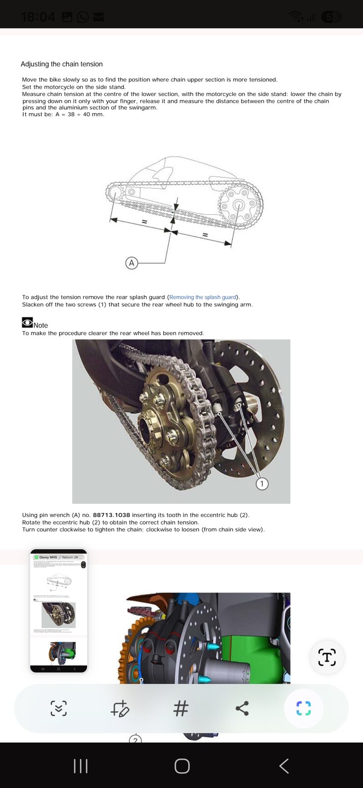

  8. "Mine is a 2018 1260s"
    So is mine (with 51,000 + miles on the clock).
    Page 353 of the owners manual has the details you need.

  14. Suspension setting on the PP makes no difference, the rider/rider and pillion options aren't in the menu, as on that model it has the manual Ohlins, not the electronic Sachs Skyhook. Urban mode just effects the engine mapping so in this case is irrelevant.
    I've had both 1260s and now a Pikes Peak.
    The owners handbook, IIRC, states that chain adjustment should be done on the sidestand. I think that this is because the centre stand is optional TBH. There is a difference but having got it adjusted on the side stand I've marked the gauge with a sharpie on the centre stand to make life easier.

  17. I also have manual suspension , I use the tool but tend to go slightly (1-2mm)above the line to be on the safe side and mine also feels slack.
    Has worked for me at least
  18. #18 Bounce, Jun 28, 2025
  19. I use a tape measure to do mine and instead of the 38-40mm recommended I try to get mine around 32-35mm, still plenty of slack and seems to work for me but who am I to argue with manufacturers lol
