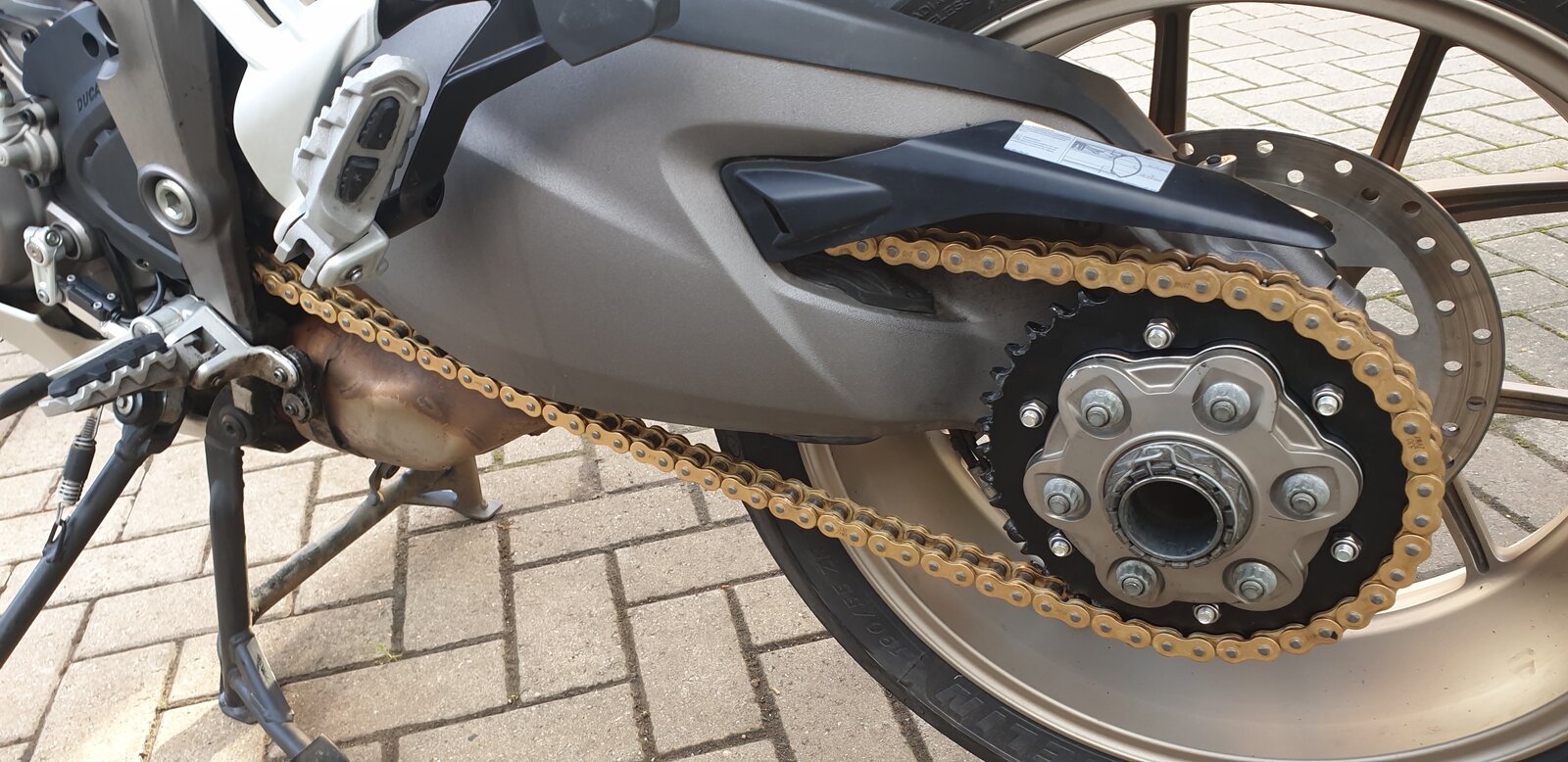

  3. It's normal and sufficient to just change the front sprocket to a 14, or the rear sprocket to a 42, not both at the same time. So 14/40 or 15/42, and that avoids your conundrum.
  4. It’s done 14t to the front bit of a pig to get off nut came of easy but getting the sprocket off the spline with the chain is awkward lost 30 mins before I realised I had to take the slave cylinder off :D even with it off it’s a bit fiddly but it’s done servo eliminator tomorrow then I think I’m done thanks all for all your help and input it’s much appreciated
  5. Having stuck with the 15/40 ratio with the Pikes Peak, more out of laziness as I have 14T front on the shelf in the garage ordered with good intent before I collected the bike (the dealer had fitted a new OEM chain a sprocket set), the time has come after yesterday, and ahead of Dolomites trip, to swap it out. Yesterday's ride in Wales with numerous 20mph limits highlighted the improvement this brought when I did this with my old 1260 Multi. Was frequently swapping between 1st and 2nd and then on the B roads finding I was mostly in 3rd or 4th. The 14/40 setup would improve both of these scenarios, enabling more of 2nd and 4th respectively.

    There is a requirement to do a tyre calibration after fitting new tyres but not after changing the gearing and a tyre calibration will have no affect upon the functioning of the DQS.

  20. Swapped 15 to 14T this afternoon. Quite a struggle TBH. The stumbling block being the protrusion on the casing for the clutch push-rod blocking the chain. Due to this the tip of one of the teeth on the OEM 15T sprocket wouldn't clear the inside of the links. Finally fed enough of the chain into the area forward of the vertical frame spar immediately to the right to get enough flex to make it work. Removing the chain from the rear sprocket, I realised, was a must. Supporting it on a platform (an old 4l oil tub) prevented the chain being pulled back under its own weight. The chain being an almost new DID x-ring gold number had, to all intents and purposes, no lateral movement. The new JT 14T sprocket went on easily. Obviously should have done this when fitting the new chain...
