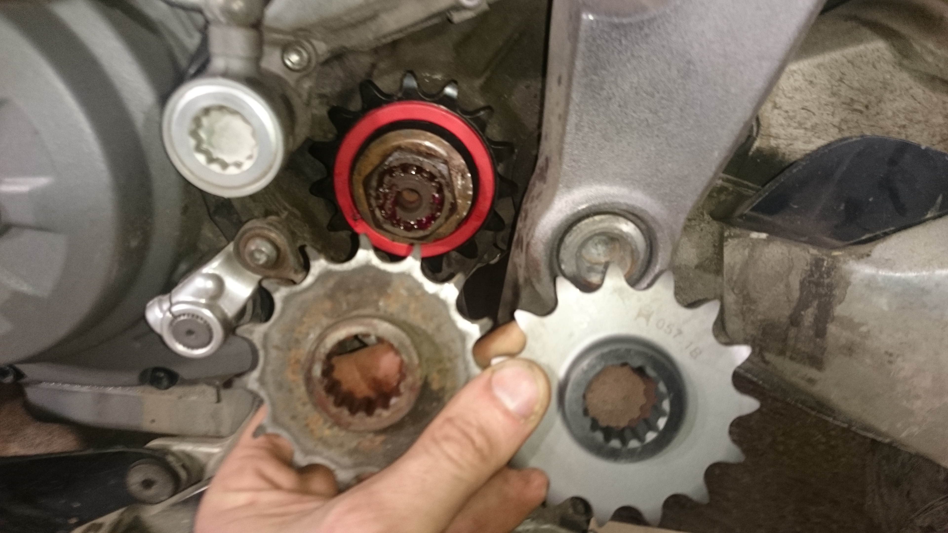

  2. The front sprocket usually hooks first & that's well worth checking & literally £40 to replace. Might be worth doing it to make the new chain last. What mileage has the current sprockets got on them? How long did the chain last?
    Highly recommend D.I.D 530 ZVMX (114link for multi-enduro) 116link for normal multi I believe from memory.
    Image shows; Hooked old & new sprocket side by side. With new version for multi (red sound reducing thingie) fitted. Worth getting new 1260 sprocket is my recommendation'
    ps: Front sprocket locking washer did get bent over after this image was taken.

  3. Mileage I do not know, I recently bought the bike. But I think it will be the best to change the hole package. The bike have a diffuse history so I will went over the engine in time.
    Thanks
  4. Buy a set, front & rear sprocket & chain Ken, at least then you know what’s what for the future.
