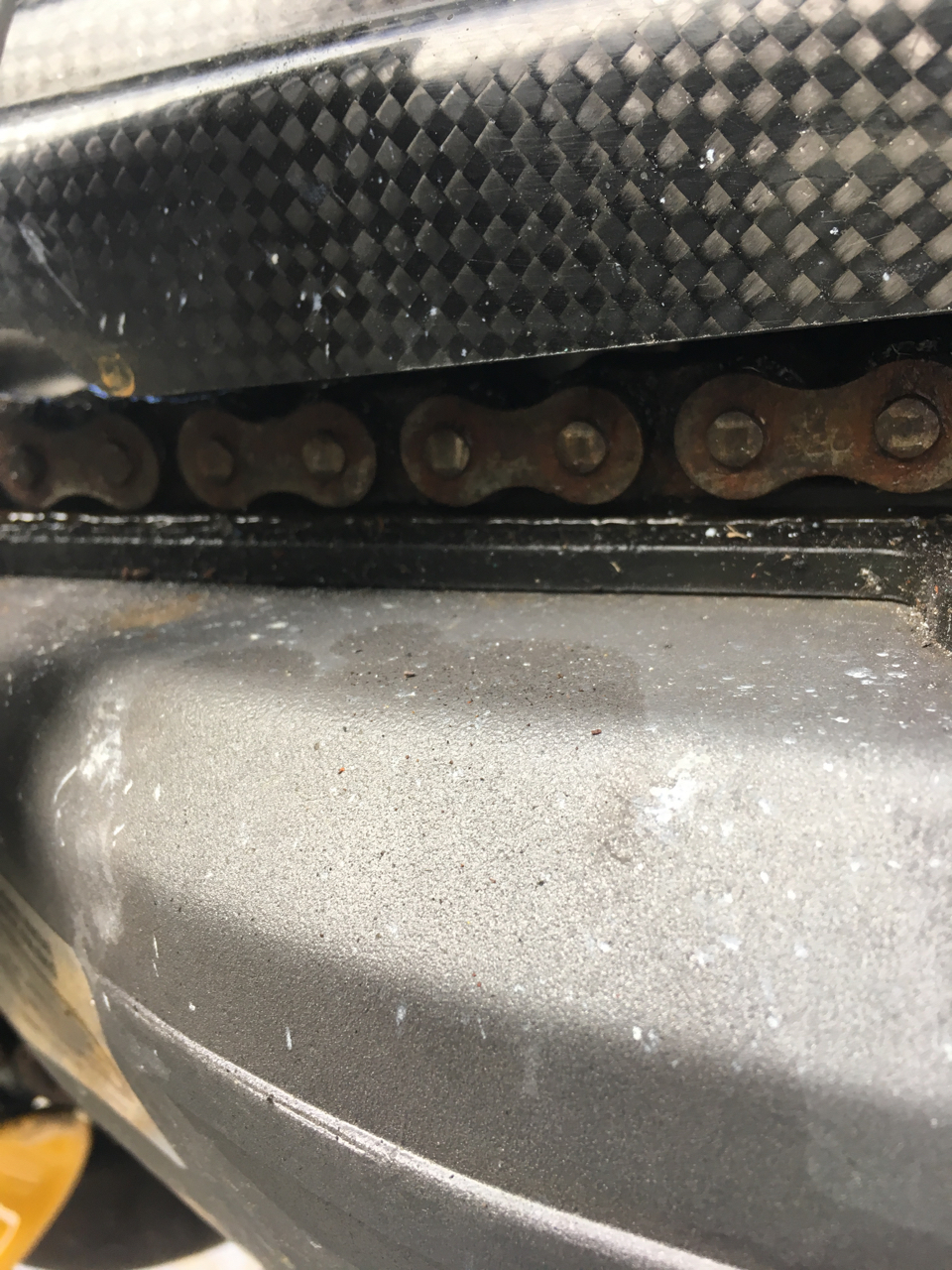

    I just want to check, is it normal that the chain on my 748 rests on the nylon rub strip on top of the swing arm when the bike is stationary? It looks to me like it will rub on that guide when in motion. Is that OK? Chain tension is correct underneath the swing arm at 25mm minimum of travel.
    ps. I know the chain is rusty but that's aesthetics there are no seized links, no tight spots, no kinks, it's only done 2700 miles but has been stood, unused (but well lubed) for 7+ years.
    Thanks.
  2. That’s what the guide is for. Remember when on the move slack is reduced, as sitting and adding power Takes it up
  3. Thanks very much. Nowt to worry about there then.
