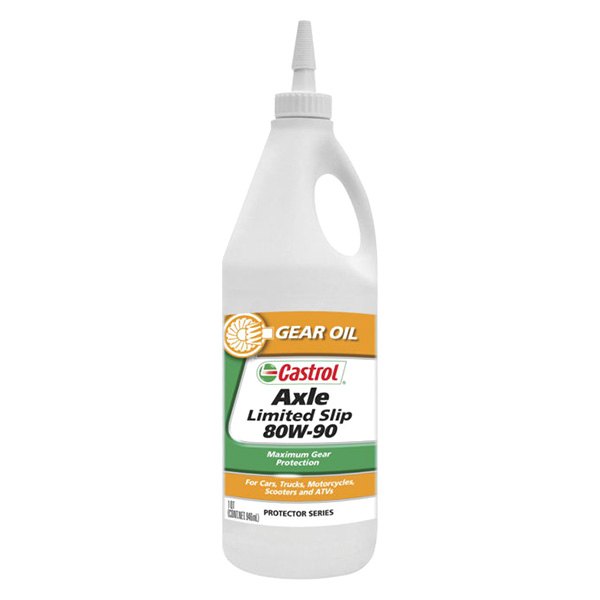

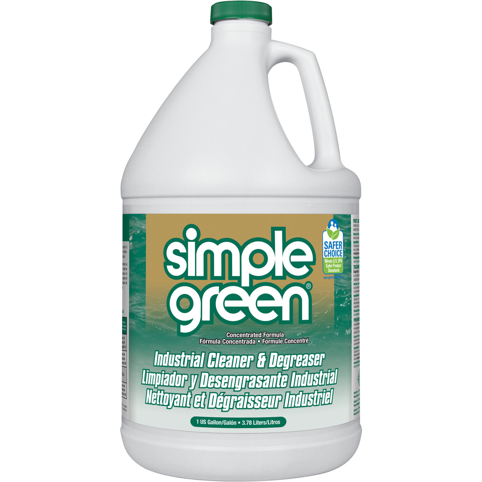

  7. BELIEVE IT OR NOT
    Bottom line ( from the pros ), cleaning takes precedence over lubing although one does not replace the other.
    Modern chains have internal grease. Next to no lube is required and only enough to prevent corrosion and keep the O-Rings fresh.
    Apply it from a rag. That's it. Anything more is a magnet for road junk. Clean after each ride day.
    Each night after you removed the bugs with a hot water shammy, clean the chain. It only takes a couple of minutes.
    Keep it simple and fast. That's the recipe.
    1) Hand spin a rag doused with a mild de-greaser such as Simple Green around your chain a few times,
    2) wipe it dry,
    3) repeat with a third rag that has lube on it.
    A micro film of gear oil (such as SAE 80W-90) is best and all your chain requires to prevent rust and keep the rubber seals moist. Not only is oil recommended by the manufacturer, it's much cheaper and less messy than spray cans. If you use paste, apply only a little and spread it with the rag by hand spinning the chain/wheel. Save those three rags for the next day.
    Keep it clean and your chain and sprockets will last a lot longer with fewer adjustments than a filthy yet fully greased chain that will just invite road grime and premature wear. Moreover, your bike will stay cleaner longer as well.
    On that note, products like Simple Green or equivalent can also be used to remove grime from the bottom half of your bike and will not leave your garage smelling like a military hanger.
