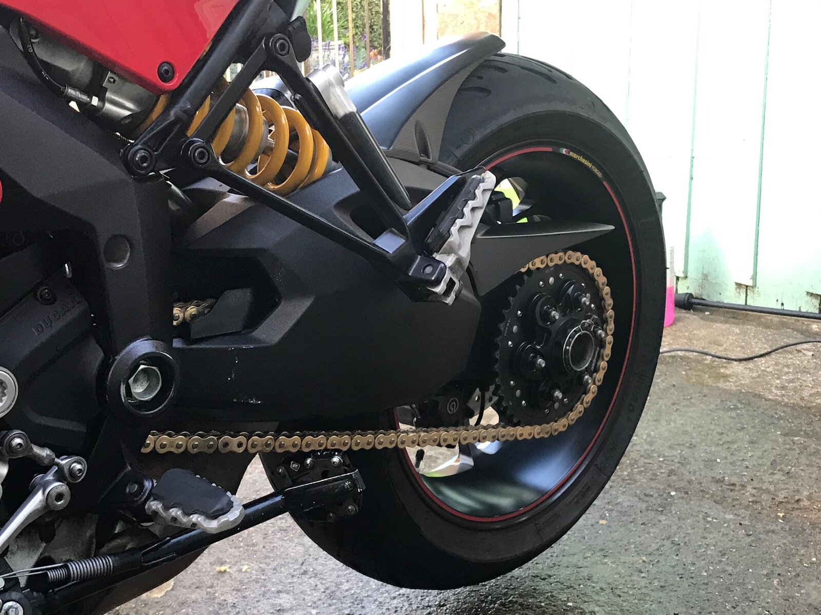

  13. Different model (2013 PP)but just done mine at 16,000 miles did chain and a supersprox rear sprocket with a renthal front sprocket IMG_9164.JPG
