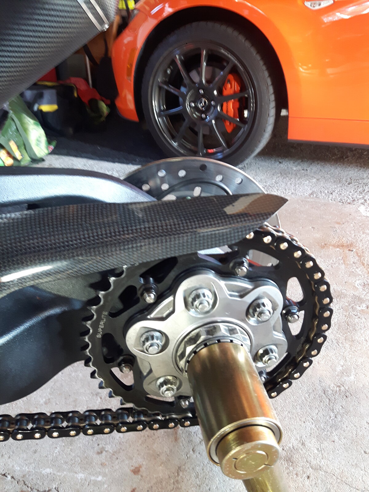

Hi Bumpkin, My thoughts exactly. The nickel is a happy medium that's better than OEM grey without being over done. However, I'm not immunised to the enchantment spell as I waved the bling wand a few times on the Monster 1200R.
Had a cursory look and it appears that the nickel finish isn't widely available in the UK. Will give it a serious search later this week when I have more time. The black finish looks OK but not sure about its durability in comparison.
Hi Bumpkin, Found this for you: The color code is actually Silver not Nickel. (My bad) https://www.motorcyclespares.uk.com/did-x-ring-s-and-s-530zvmx-120-open-chain-with-rivet-link.html Part numbers shown on my box are: OEM# 530ZVM-XSSx120 DESC# 530ZVMXx120S/S For the Monster, the Black/Gold was an EK 525 ZVX3 Series Supersport Chain.
