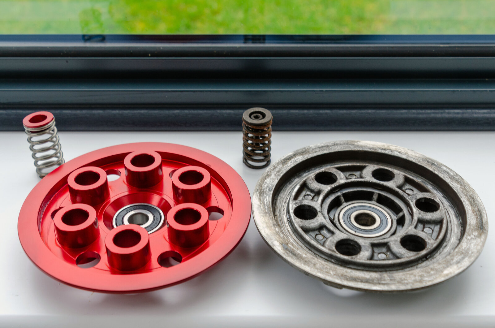

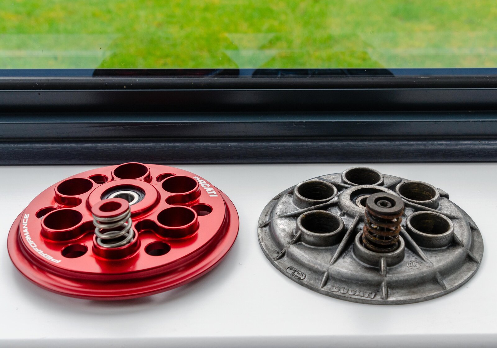

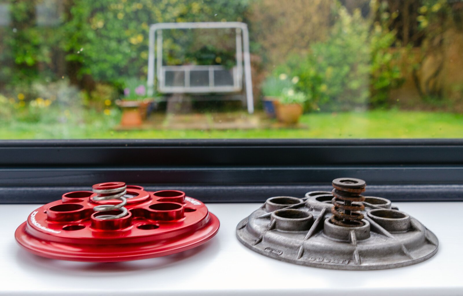

  6. So pressure plate removed (I had a small puller that the legs fitted through the holes in the plate so just popped off). Before I fit the new plate I just wanted to check it was the right one as it is a different design (spring recessed) and find it doesn't work!
    Thanks!!
  7. I see that both the old and new plates are flat on the inside without teeth to engage with the hub - therefore I conclude you have a slipper clutch?
  8. Thanks - it's a 'R' so yes it should have a slipper. :)
  9. Ok, ignore my advice about aligning the post with the slit in it with the triangle on the plate - slippers do not have this requirement.
    As it’s a slipper - have you considered regressing the spider spring and ramps etc? This would be a more involved job if you don’t have the holding tool etc.
    Otherwise, the plate looks fine.
