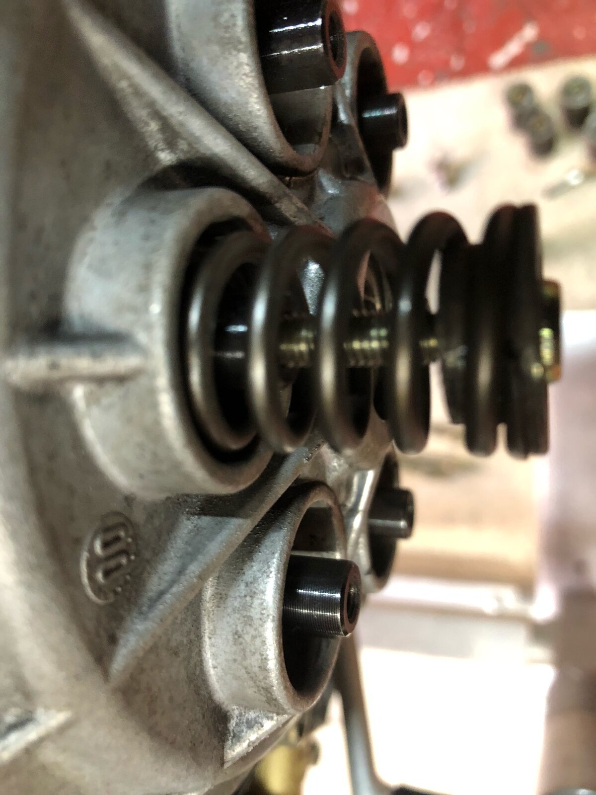

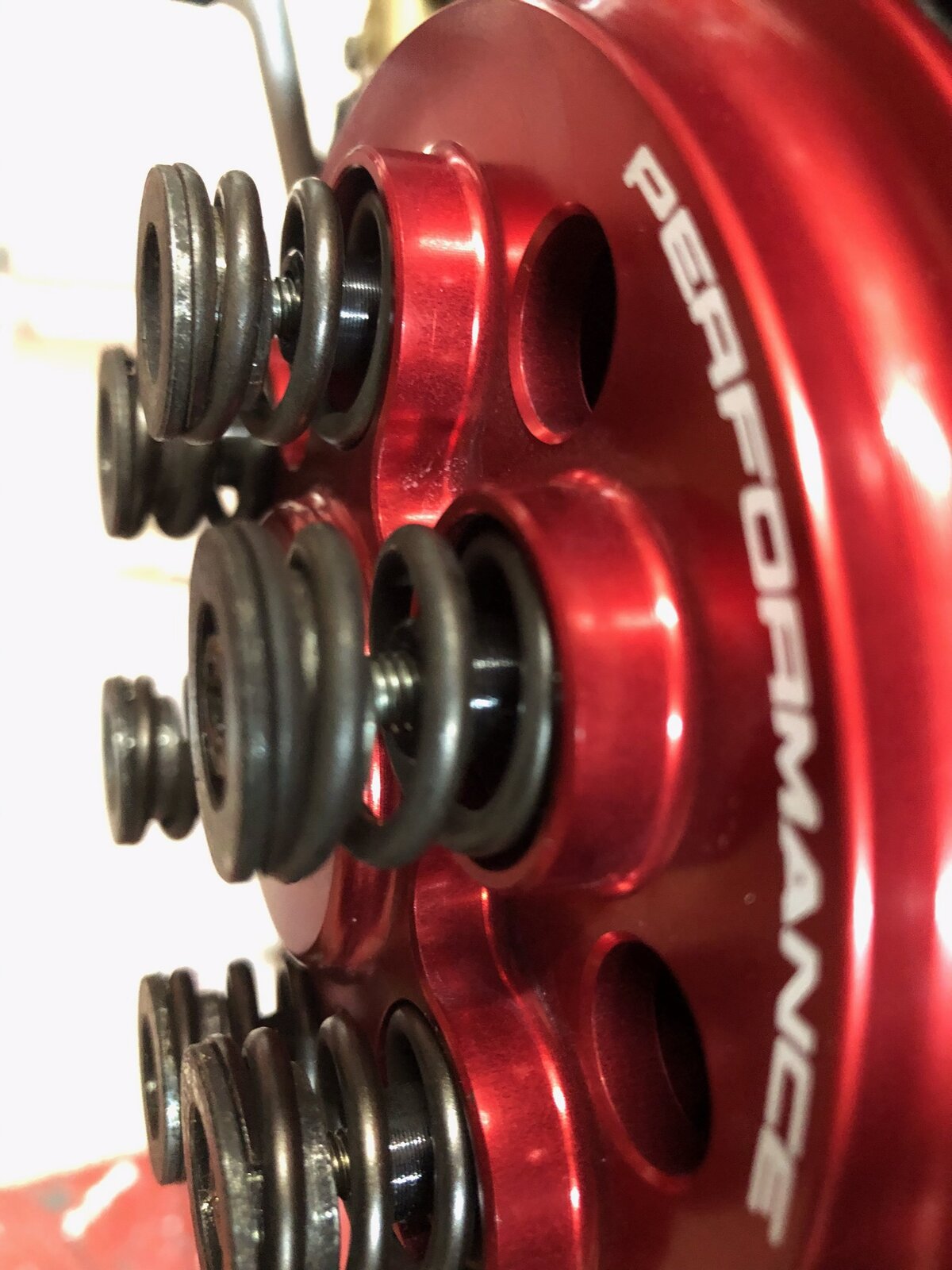

  2. Just changed my old pressure plate out and replaced with same as NeilH. With normal springs 38mm there does not seem enough pressure to stop the clutch from slipping ? In fact they only compress about 10mm before hitting the barrel. Any help

  8. The insert hitting the post. On the OEM plate you need to apply slight pressure for the 20mm cap head screw to start in the thread of the post. On the new plate with the deeper recess the screw enter about 12mm before taking up the spring slack.
  9. As you can see from the top picture the springs can only compress about 6mm.

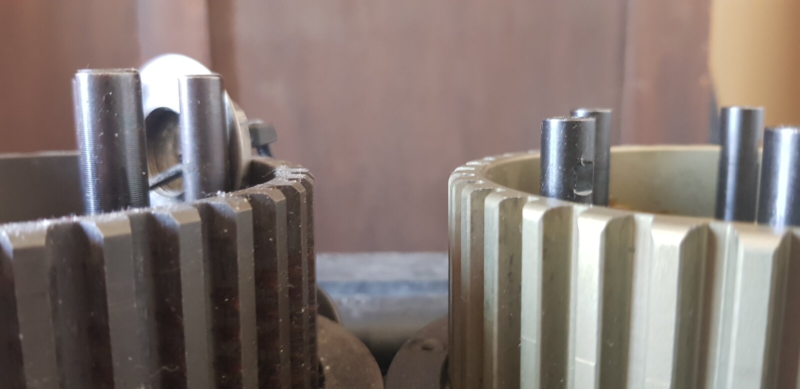

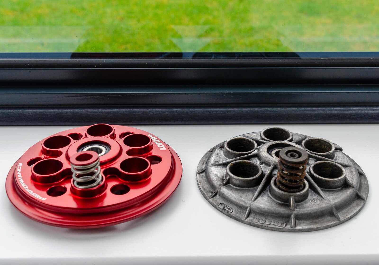

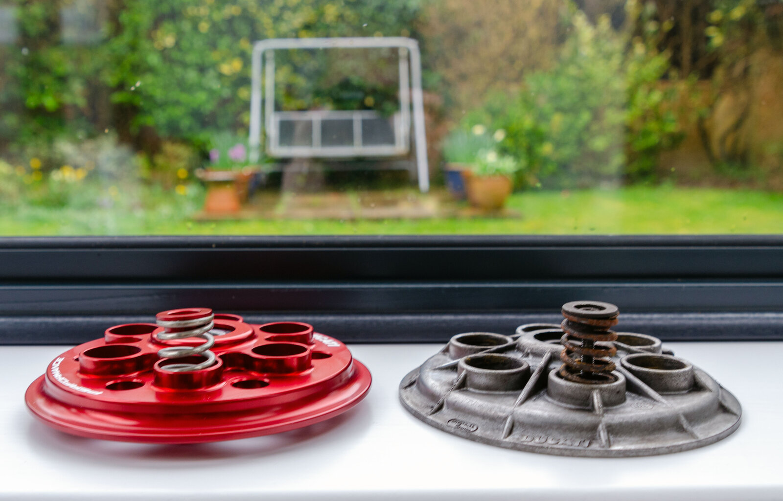

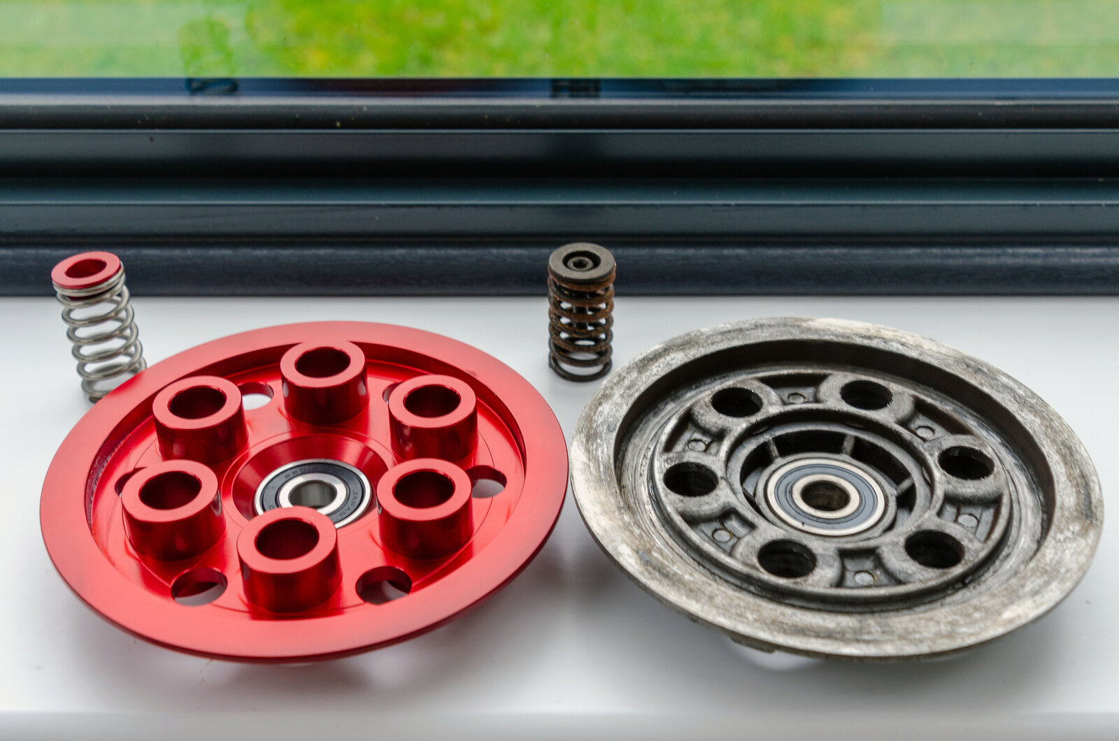

  16. There you go, what @Chris said is the answer, looks like the shiny new DP pressure plate won’t be compatible with the OE clutch without some modification to the spring posts. I’ll try and get a photograph. Andy
  17. Here you are, OE centre on the left, DP on the right.
    Andy
  18. you're a star Andy, taking the trouble with pictures. :upyeah::)
  19. No trouble, fortunate to have the bits to hand and always happy to help if I can. Although not sure there are many people fortunate enough to have a 748R and a 1098R :D Andy
