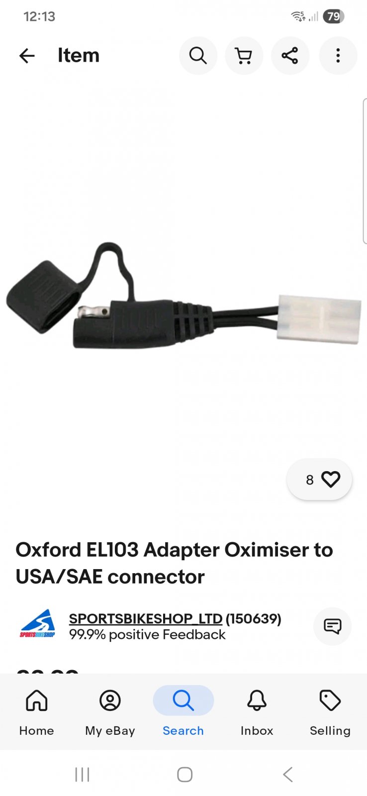

  2. Simply get lead converter thingy that means you can switch to whatever charger you have :upyeah:

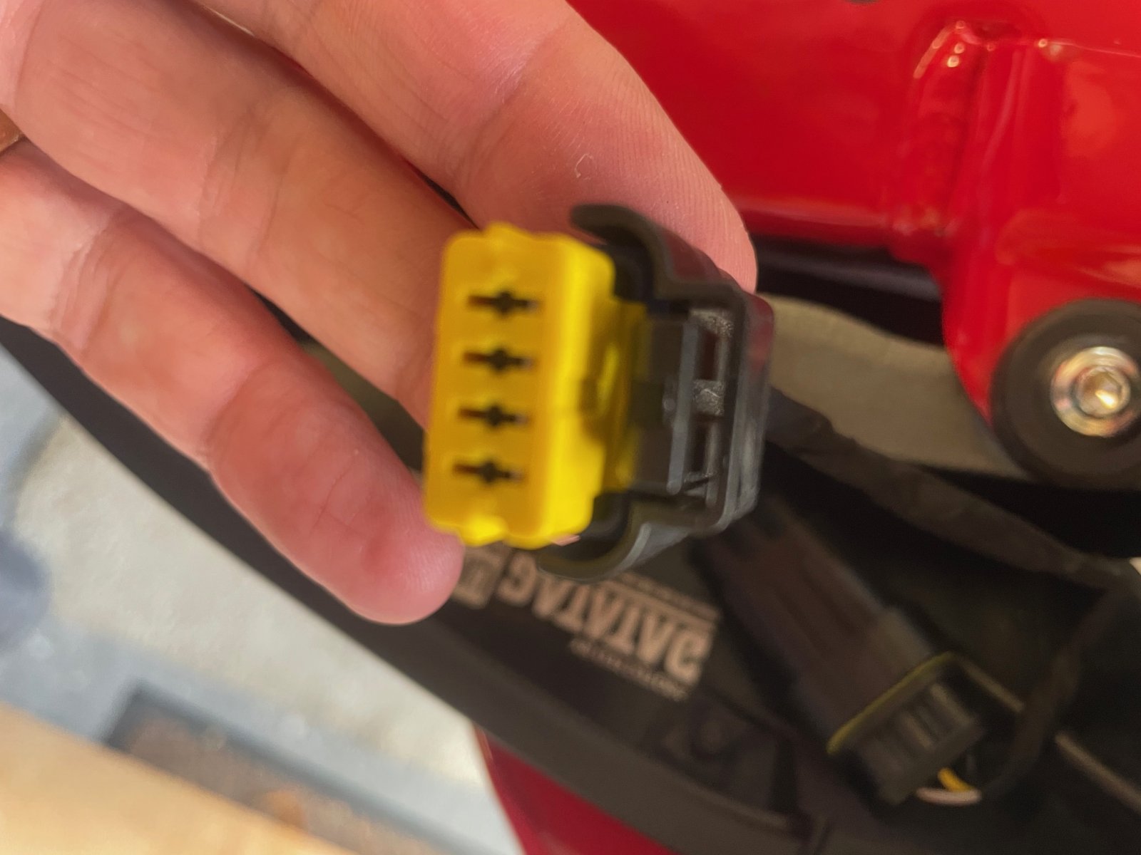

  3. @AndyF, post a picture of the connector, someone on here might have an adapter. Andy
  4. Good idea - thanks. See below
  5. Thanks Fraser, never heard of that, but I'll have a look.
  6. I don’t recognise that connector as a charging pirt unless it’s the DDA socket. If it were me, I’d use the battery pigtail in your new Optimiser, connected directly to the battery terminals. Andy

  8. This sort of thing depends on your connections. All out there
  9. I’d go straight to the battery. That socket is the diagnostic socket. It can be used, and you get an adapter to do so, but the circuit isn’t fused to highly. I see bikes with blown fuses due to charging, quite regularly.
  10. Thanks Nelly, maybe I read the handbook wrong. I’ll check it again, maybe just connect the leads directly to the battery as you aay
  11. The handbook will tell you that you can connect under the seat……. Don’t always believe everything you read though ;)
    Go for a direct connection to battery and you’ll be fine. If the fuse goes on the diagnostic wiring, first thing you’ll know is that your bike won’t start because the battery hasn’t been on charge
