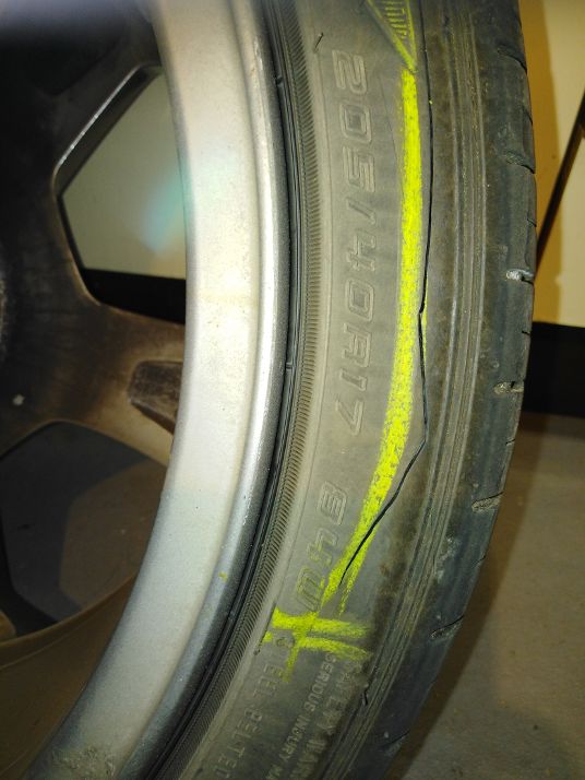

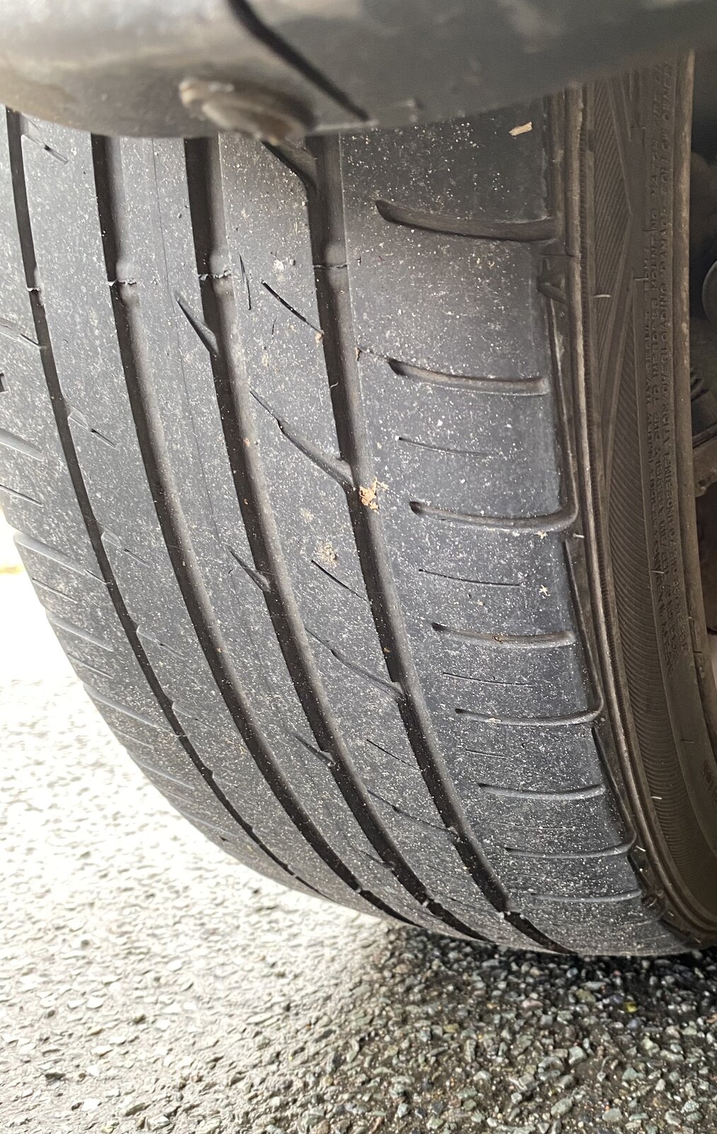

  5. There's some nonsense in your post. The original Bridgestones fitted to the rear of our Fiesta ST are 7 years old, which is usually when the performance of tyres has dropped off. The Falkens fitted to the front are less than 3 years old, and they're in much worse condition. Added to that they're surprisingly inferior in the wet and the dry. As for tyres relying on you, WTF does that mean. Do you remove all 4 wheels monthly to check the inner sidewalls? I've got several pictures that show 2 Falkens have failed in the same manner, So rather than just an opinion, I have actual proof that it does happen.

  7. Well OK. if you read my OP you'll see this is a car that's had a very easy life. Probably 90% of which is driving 10 miles along a dual carriageway and 2 miles along a bypass, twice a day. Falkens are marketed and priced as mid range tyres, not ditchfinders. If I have to pay £100 a tyre now, to get something safer/better so be it.

  9. I don't think it's lack of use, the car is used 5 days week and has done 30k in 7 years. I think the sidewalls are soft, add that to a car that's stiffly sprung like a Fiesta ST, and that is the issue IMO. But that's a design not use issue. My Daughter bought a Fiesta Zetec 2 or 3 years ago, that had 2 fairly new Toyo's on it. Turned out there was a large egg on the inner sidewall of one of those. And a bit of research suggested the sidewalls on the Toyo's are soft too. You may have different Falkens fitted. I've just remembered, one of those Toyo's blew out too.

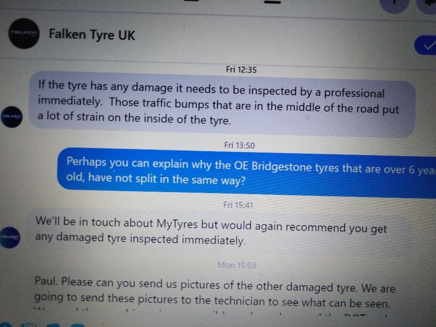

  16. The previous MOT just over a year ago, was done at F1 Autocenters. They are in the business of selling tyres, and I watched the tester carefully inspect all of the tyres, probably looking for a sale. So I know there was no issue with any of the tyres then. We moved house just under a year ago, and my Mrs hasn't needed a car since. So I'd know if I'd hit any potholes in the meantime. And the tester for the recent MOT said there's no damage on the wheel rim. Add to that the tyres fitted on the rear have no damage, so in this case I don't think your points are valid. 2 new Falken tyres would cost £160 fitted, which is F all really. The issue is the tyre is dangerous, and neither Mytyres or Falken will accept any responsibility for that.

  20. Just to update this, after months of dialogue, Falken have finally replaced the 2 tyres and paid for them to be fitted.
