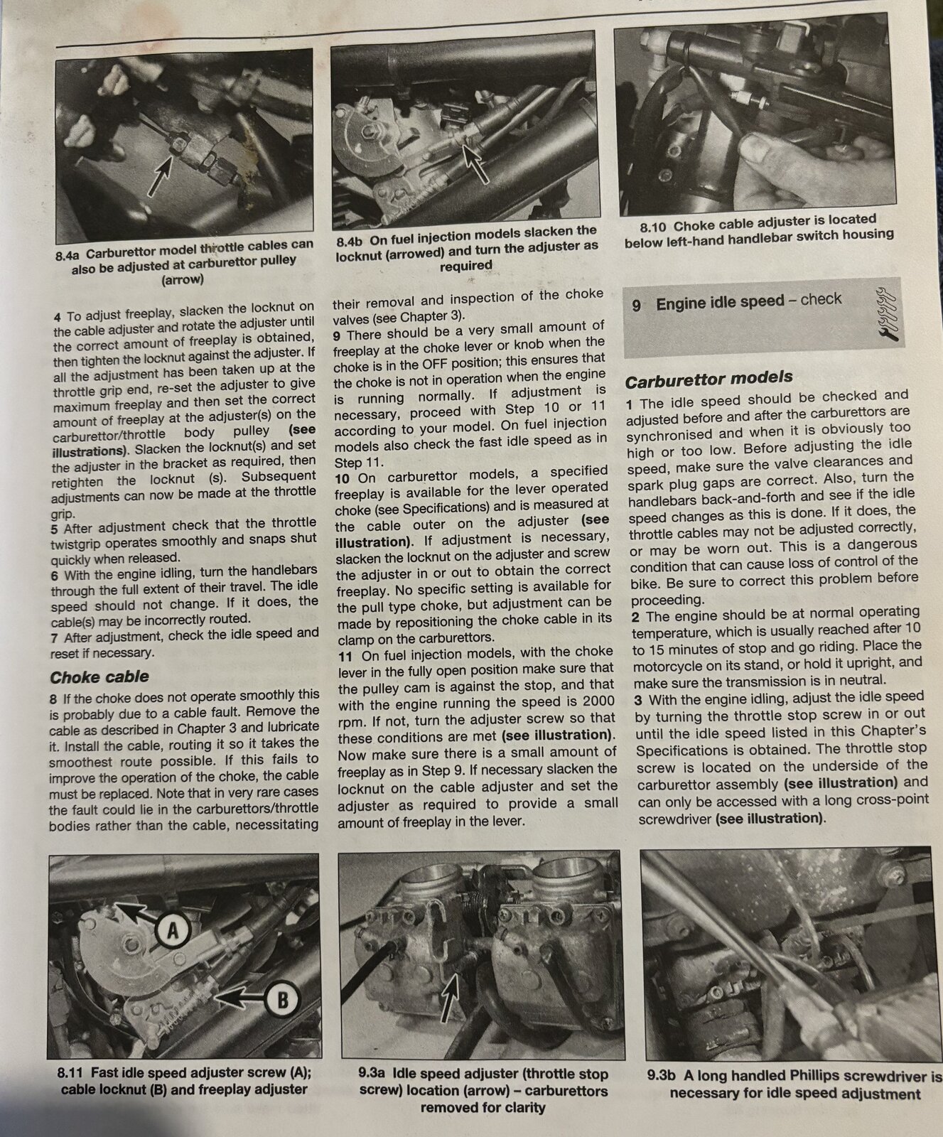

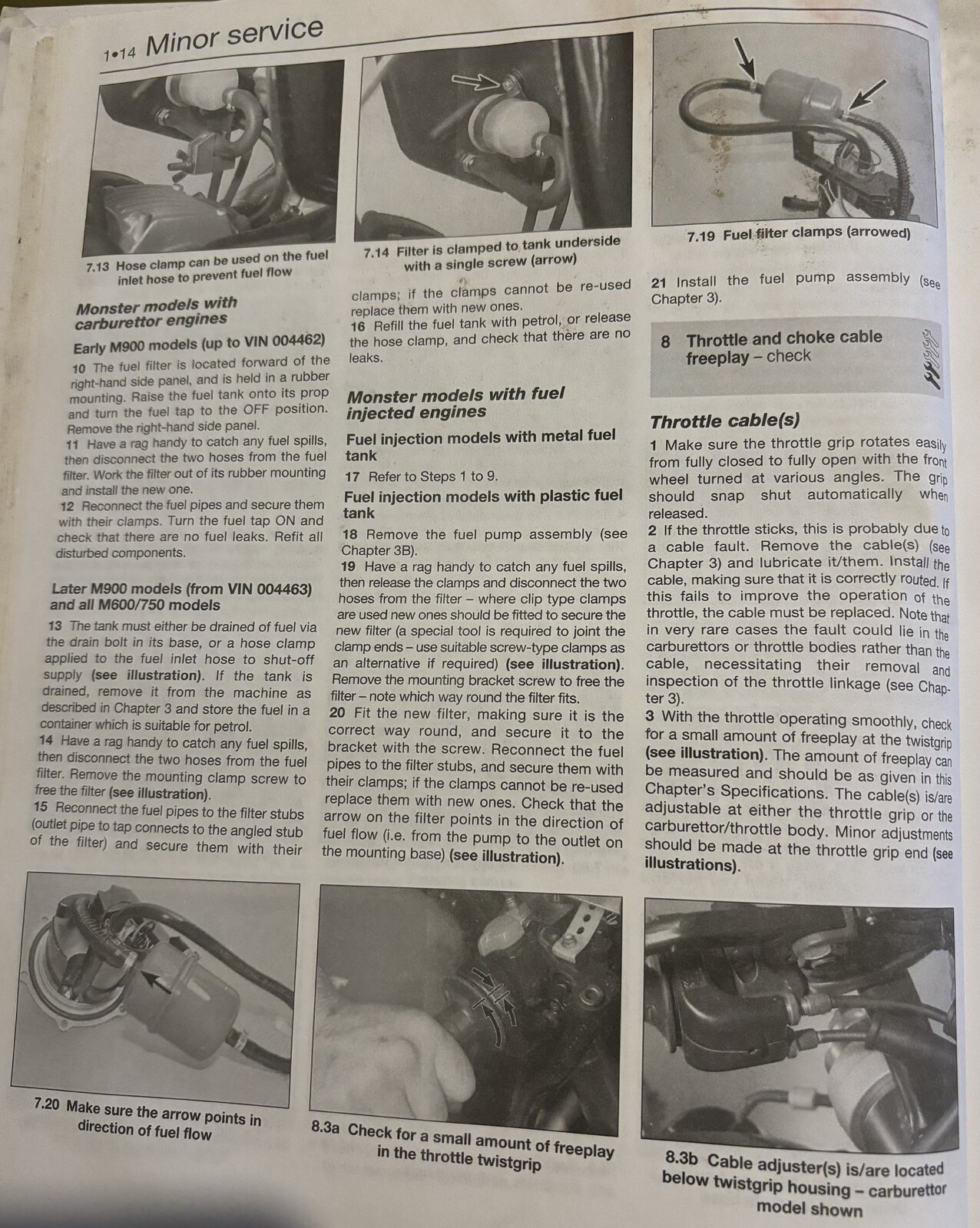

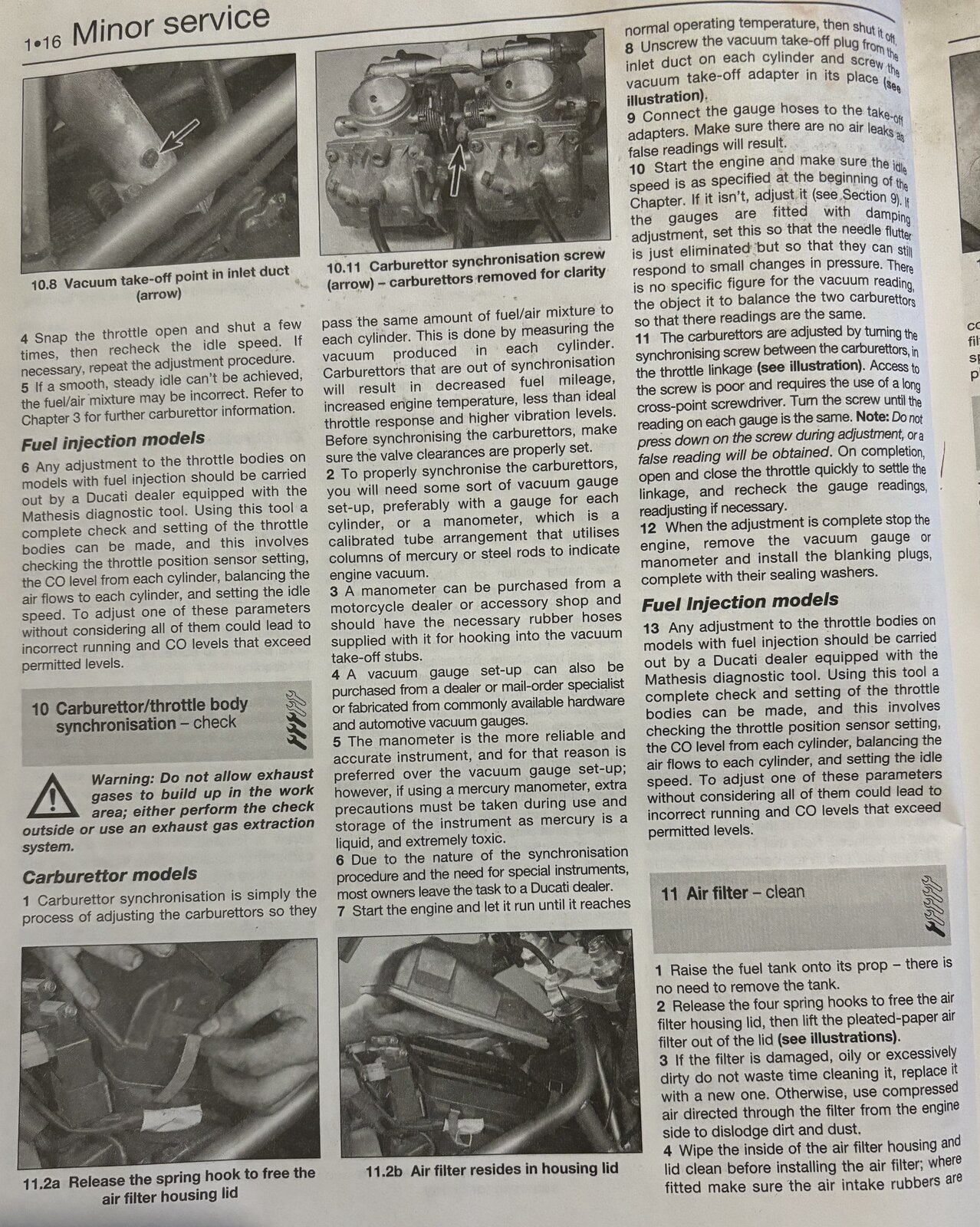

  5. @Vader Had a look in my old manual
    Is this any help
  6. I would try cleaning the carbs first, in particular the pilot jets then set them up again as far as throttle play, idle speed and balance.
    If disassembling, note down how many turns each fuel screw takes to seat, makes reassembly easier. Also recording the jet sizes is handy info to know.
  7. Started the bike today as he weather is a little warmer, started straight away on choke, after a while of running it was smoking which looked like a fuel issue, it also smelt “fuely”Took the plugs out and they were black. Cleaned them and the bike fired up and ran ok off choke, still hints of smoke when I rev it so I’m thinking it needs a good ride out as it hasn’t been used for 3 years? I feel a bit better about it especially as it ticks over without choke which it wasn’t doing before.
