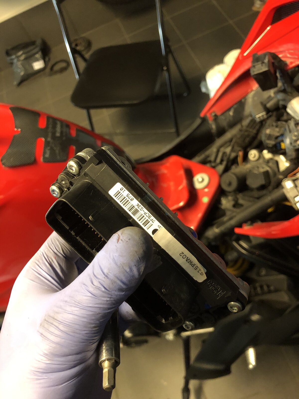

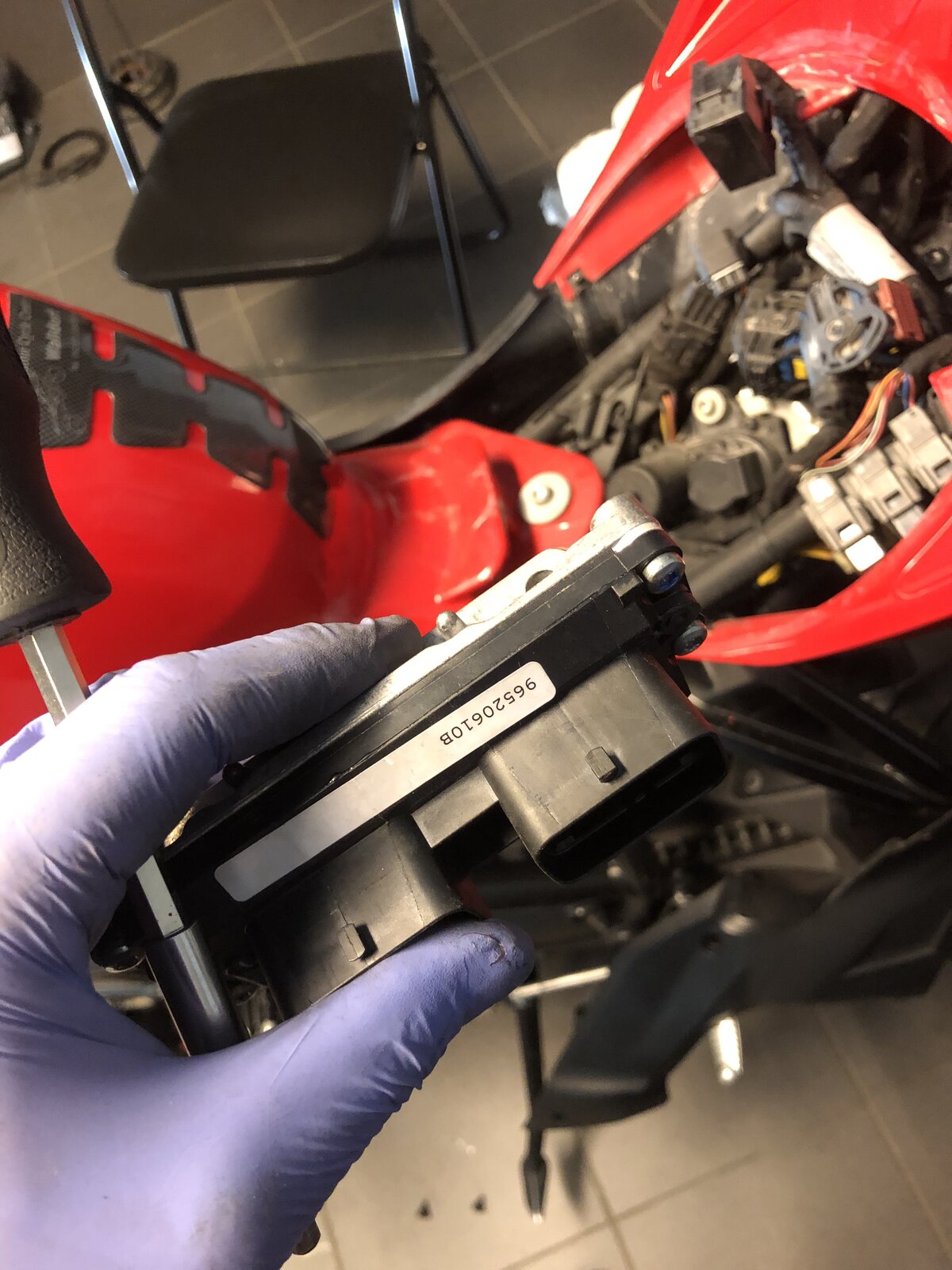

    I have a 2010 Ducati Streetfighter 1098 which i have installed Termignoni slip ons. I bought a race ECU that was supposed to fit the bike, but when i install it, the bike won't start. In the display it says ''Racing'', but nothing happens when i try to start. With the original ECU, the bike isn't running properly on lower revs.

  10. It is not an immobiliser problem as the Immo on your bike is just in the clocks. When you installed the RACE ECU are you certain you fitted the small black earth fly lead that goes under one of the bolts. That can cause the bike not to start. Can you post some images of the labels on the RACE ECU.
  11. Ok, i will have to check that later, i’m currently at work offshore. I have somre pictures from when i tried to install it, not sure if its the correct labels

  13. Ok. I've seen that some say you have to link the ECU to the bike, or something like that. Is there any way to reset the ECU?
  14. The ECUs for your bike are virgin and plug/play. They are not like the earlier ones as fitted to the likes of the 749/999 where the ECU was paired to the clocks. The only thing recommended for your set up is a TPS reset but that is not essential.
  15. Ok, I will try to fit the racing ECU again when i'm home again. Do you know if i could run on the standard ECU with Termignoni slip ons and just have the TPS reset to make it run clean?
  16. The bike will run but it will be running lean with the stock ECU. The DP ECU gives better fuelling (not perfect like a custom tune) and also disables the lambda(s) allowing them to be removed/blanked. It also allows the CO to be adjusted. Useful when balancing the throttle bodies and getting best idle speed. TPS just tells the ECU when throttle is closed, throttle is wide open and all points in between.
