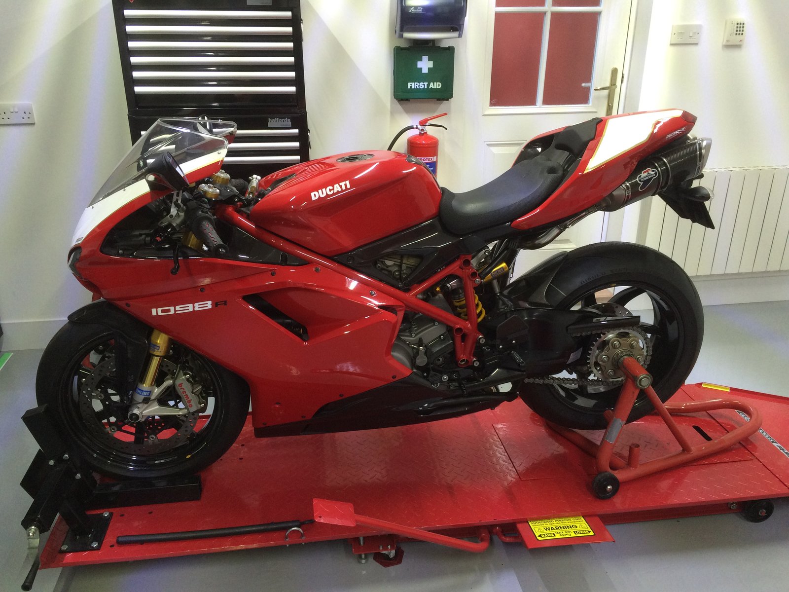

  1. The first one that I bought was collected from a store in Bristol with a people carrier with all of the seats removed. The second one was delivered whilst I was out and left outside.
    I must be stronger than I think!!!

  4. Likewise, well worth the small premium for the air lifting. Because if not you'll be pedalling the thing up and down all day, much easier just to let the compressor do the work. With regards to the size, it's long enough and strong enough to fit my old Guzzi (considerably longer and heavier than any Ducati!) and can also be used for ride-on mowers, quads etc. with a little imagination.
    Had mine a few years now and really don't know how I managed before where, even checking valve clearances was a major PITA (lying on the garage floor to see 916 front cyl. exhaust shims anyone?). I did have to replace the hydraulic seals though as it stopped working a couple of years back due to a leaky cylinder/ram - fortunately you can buy a a seal/overhaul kit, think I used fork oil for the refill.

  11. My 999R is sat on one now - it's 35" to the swing arm pivot from the floor :):upyeah:
  12. Higher than the hydraulic table lift could!
    You can also raise just the front or just the back wheel to chest height if you want.
  13. Not sure how you work that out. My 853 (748R rolling chassis) swing arm pivot is 1.190m off the ground with the lift platform fully raised and the bike on a rear paddock stand which on my ruler is smidge under 47”. Andy

    • I find that you can roll any bike onto a bike table with no adaptors needed. I've used it for all my bikes and scooter with no need to adapt it. How many professional garages are using ABBA Skylifts in their workshops?
    • I'm assuming kits and adaptors are needed for the Skylift plus the time to clamp it to the bike.
    • The Clarke table is very stable.
    • You can keep your tools on it while working.
