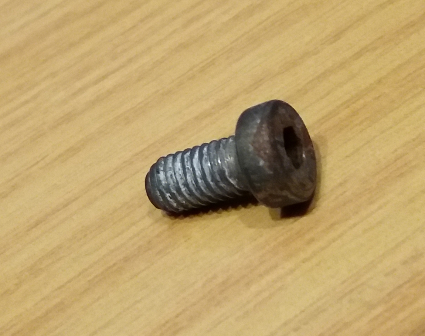

    I do have one small issue outstanding though. When dismantling I make notes and take photos but when near the end of the taking apart process I was interupted and didn't make a note of where this M6 allen screw came from (photo). It's clearly been exposed to the elements so isn't internal. Does anyone here know? I could be going mad but I don't remember it and I usually lose parts rather than have them left over. I've looked over the bike time and again but can't see where it may be missing from. Any advice gratefully received.

  9. It may be the screw that holds the plate that secures the rev counter drive to the horizontal cylinder - My experience is with a 900 so above may be rubbish
  10. How about the coil mounting plate? Should be 2. IIRC
    I can't remember what size screws the airbox was held on with.....only that there were 4.
  11. Thanks for your thoughts guys but of those fastenings are accounted for.
  12. Screws that hold the solenoid plate to the battery box (X 2)
    Or the black fairing outriggers (1 each)
    Failing that, have a look at the rear end.....tool tray, seat lock or grab handle possibly......
  13. Nice ideas but not them either I'm afraid. It's booked in for an MOT next Wednesday so I'll take the screw with me in case they spot something - assuming I make it there ;)

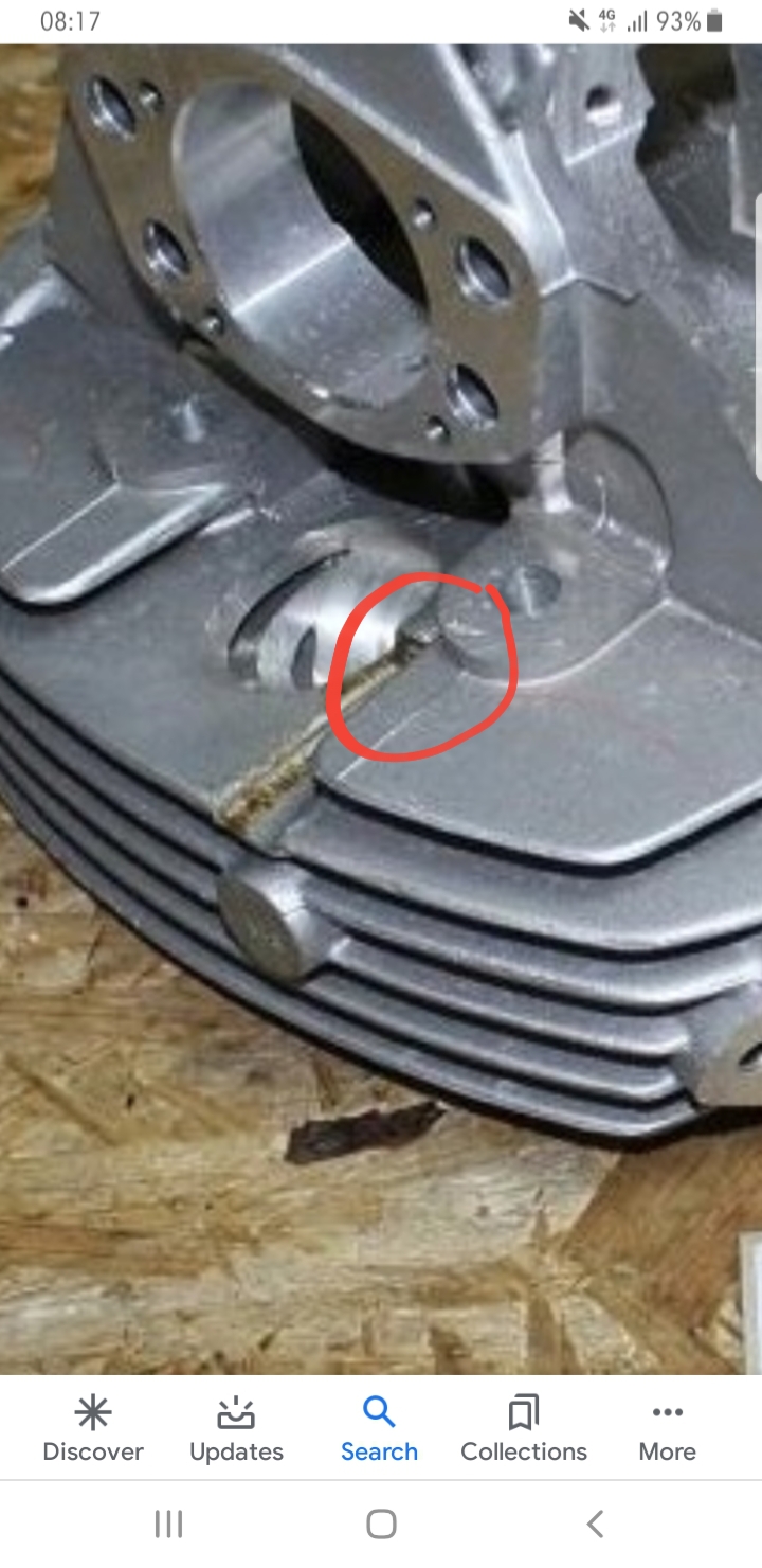

  14. Have you checked the heads? There 2 screws on mine that block off oilways where they have been drilled, near to the spark plugs....
  16. Front mudguard mounting screw ?
  17. It shouldn't be, they should be mushroom head.
    How about mirror mounting screws (2 to each mirror)?
    Or rear brake reservoir mounting screw?
    Rear brake hose clamp/guide to swingarm?
    Front brake hose guide clips to front of bottom yoke?
  18. many times i've found a redundant screw when stripping a major-ish part of a car/motorbike that's almost certainly been dropped into a nook or a cranny by a previous owner and they've then given up looking for it and replaced.
  19. I found a live .22 bullet in a CX500 I had in the 80’s Chris, good job it didn’t go off :-/
  20. Thanks for all the suggestions. I've checked them all but everything is present and correct. Maybe it was a lost rogue from the past as Chris suggests. I think I'll try ingesting a drop or two of Balvenie and see if that jogs anything...
