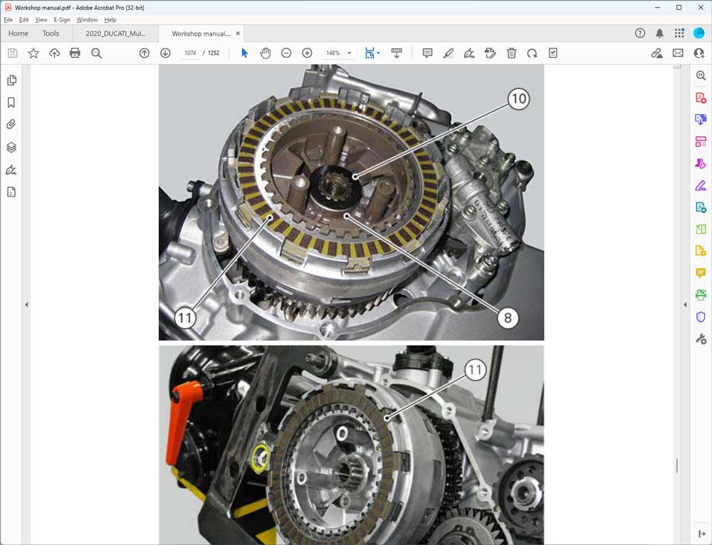

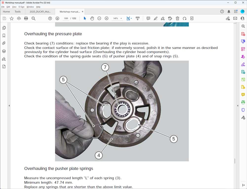

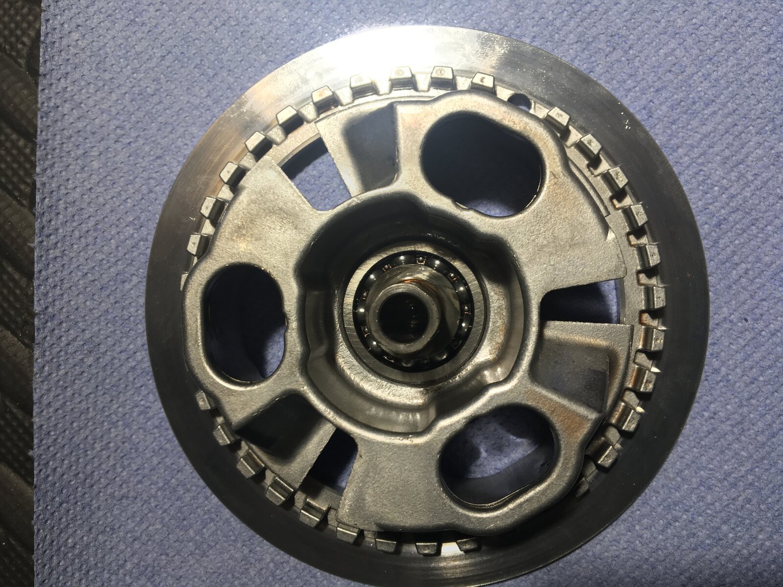

  8. Other than the sales brochure I couldn't find official mention of the slipper clutch for the 1200, this video for the 1260 Enduro mentions it though. The illustrations in the workshop manual for both the 1200 and the 1260 show the same clutch mechanism and there are photos showing the ramps on the pressure plate and drum. The following are from the 2015 > 1200 DVT manual.

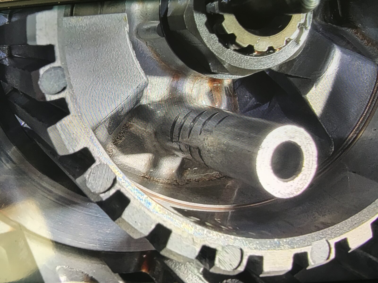

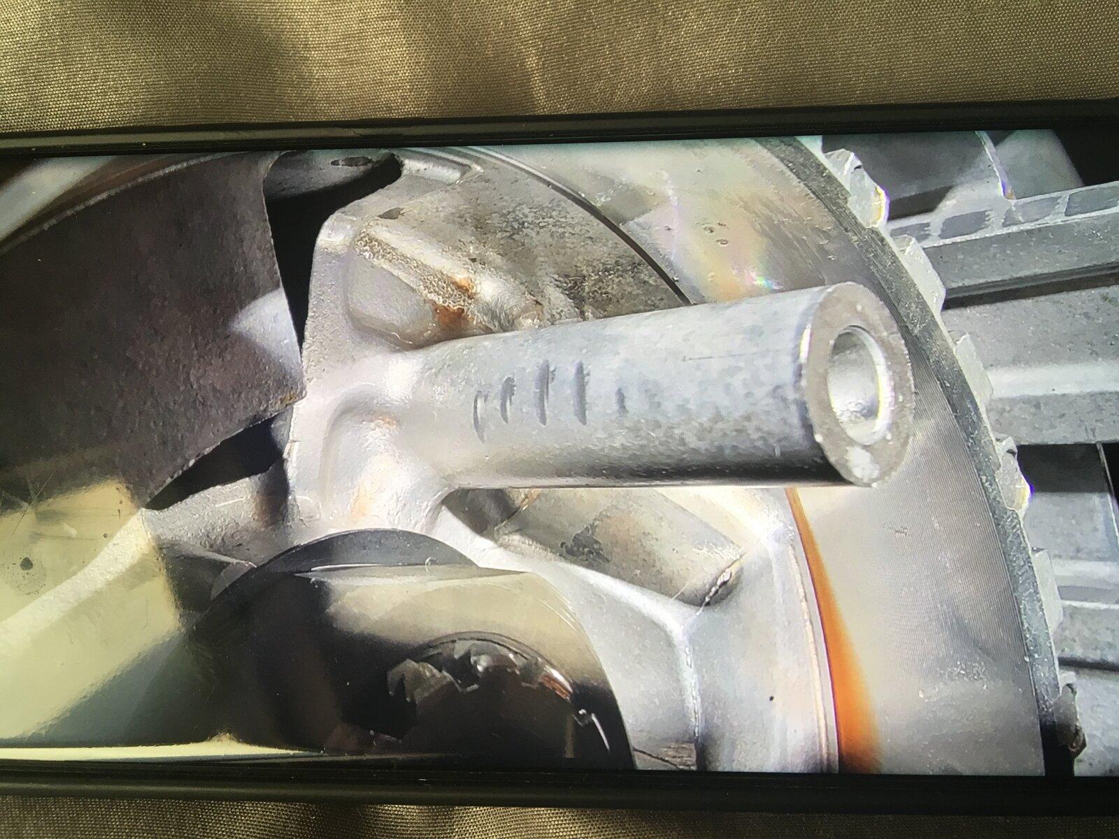

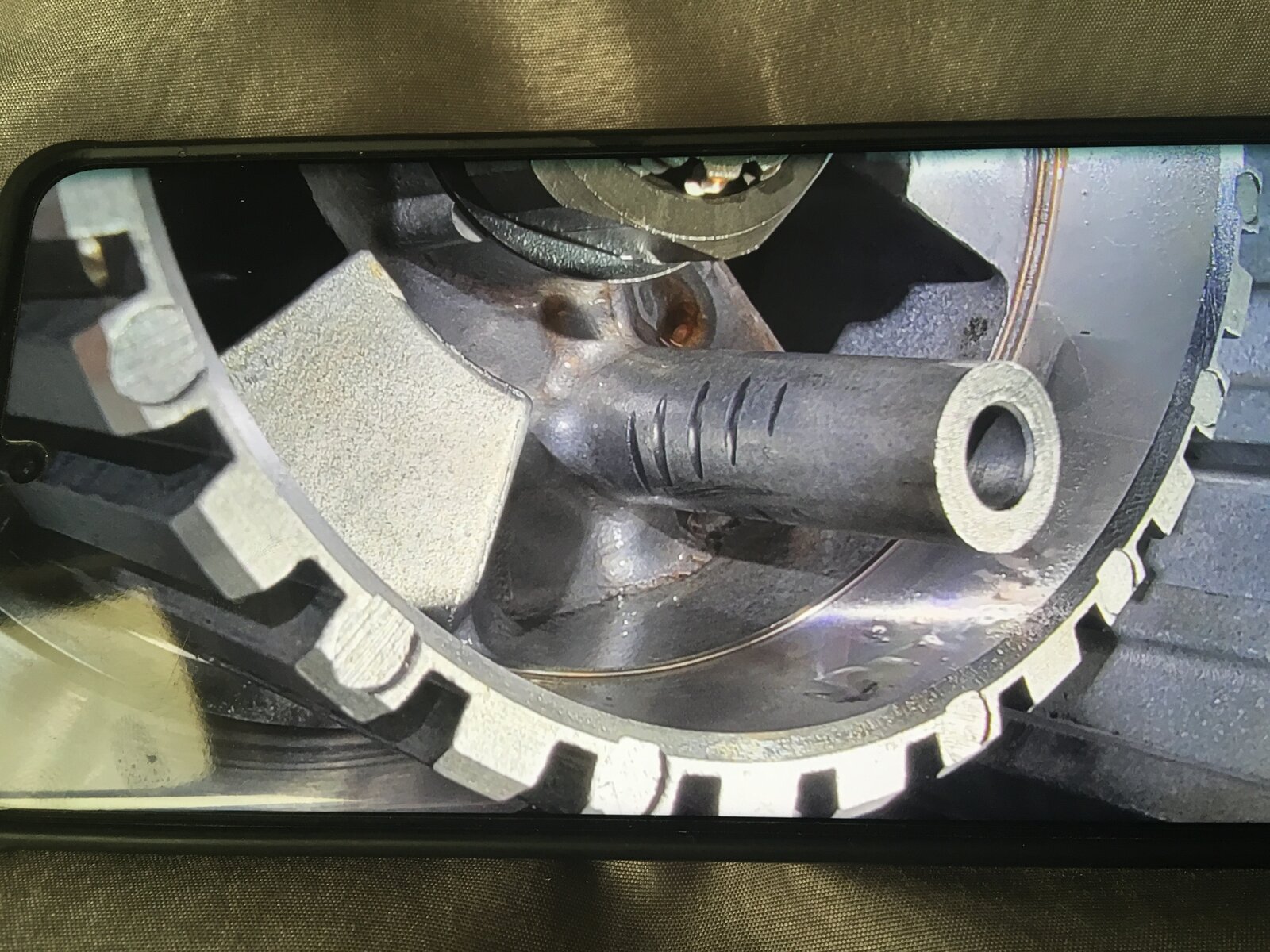

  10. This is what the hub looks like !
    There are many substantially deep grooves worn into it, presumably by the 3 springs.
    Am I corrcet in thinking these ridges/grooves are causing erratic disengagement of the clutch, creating the sudden clunk and forward progress of the bike on pulling away?
    Also, how could that have happened ?

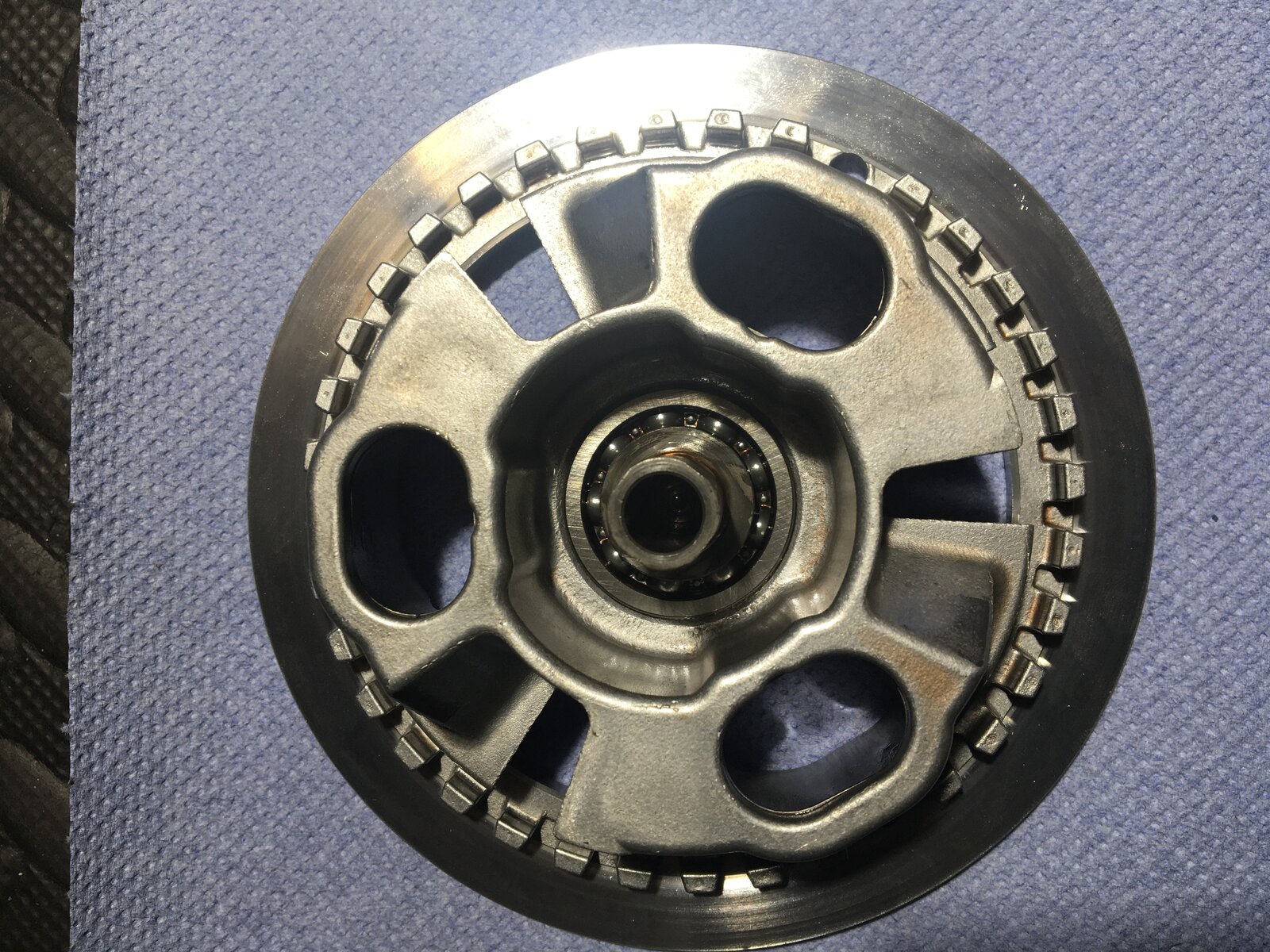

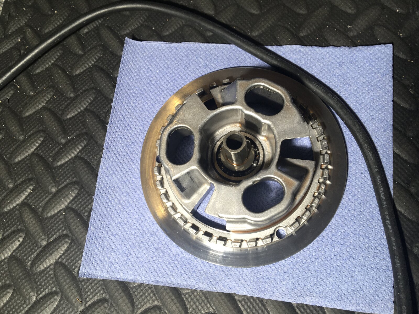

  11. From the photos it looks like a slipper clutch i think. Are the ramps OK?
  12. The appearance of wear marks on them but nothing to the touch.
  13. If the ramps are smooth I think the groves worn by the springs could possibly be the issue with your occasional grabby take-up of drive. As there's relative rotational movement between the drum and pressure plate giving some lateral force on the springs. This could potentially be the cause of the grooves to start with and also cause the springs to catch and release as the "self-servo action on drive" from the opposing ramps move them against the posts on the drum.
    A new drum is around £335 inc VAT :astonished: If the grooves worn into them aren't too deep I might be looking into the option of redressing those posts with a file...
    The drum is common across quite a number of Ducati models (go here and enter 19610532C) so finding a used one, maybe a complete clutch, shouldn't be too hard. Something like this. Of course with used parts there's always a risk of buying one as bad or worse than your existing one...
    Goes without saying that you should also be checking the condition of the steel clutch plate grooves on the outside of the drum as well as the friction plate slots in the basket. Any notches worn into those can cause similar gabbiness in the clutch action. Also the smoothness of the clutch push rod and slave cylinder. Though all of these would likely give relatively consistent poor clutch action.

  14. The basket is grand.
    I will just bite the bullet and buy a new drum. The 3 springs are out of spec by about 0.6mm so they will be replaced too.
    Thanks:upyeah::)
  15. Out of interest how many miles do you have on your Multi?
  16. Just short of 18K.
  17. Odd how the springs have had that much contact with the posts to cause that amount of wear, it looks likely to be the culprit though, bit like a worn basket on a traditional clutch will catch on the plate fingers.
  18. The 'claim' isn't marketing bullshit - I've the same (wet) clutch on my Hyper939. It has a very light action which is facilitated by the self-servo action, plus the slipper works really well :upyeah:
    Interesting to see those spring-wear grooves tho' :poop: I'd assume that'd make the action 'grabby'!
