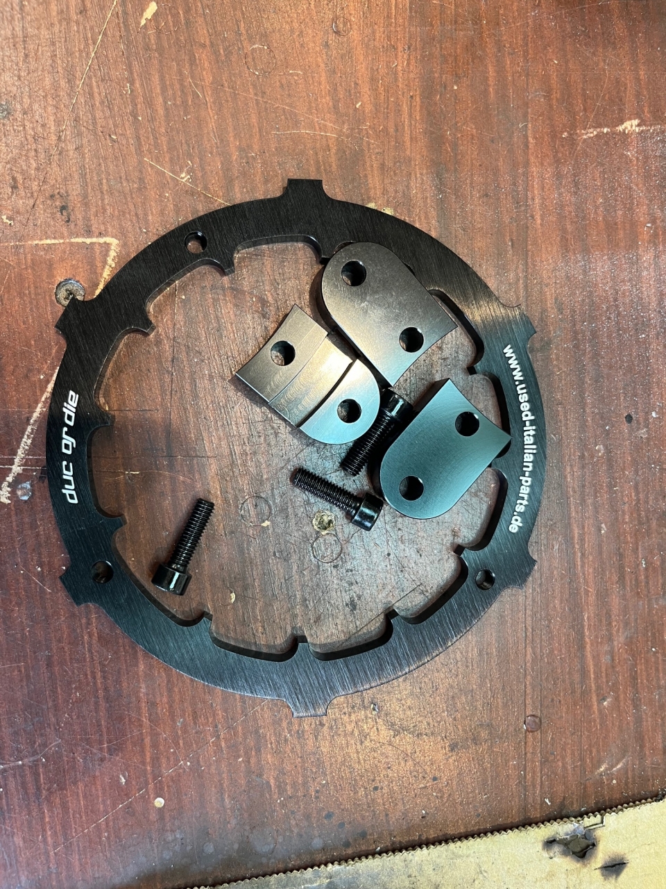

  4. Regarding clutch tools, I just bought a new basket & plates for the Monster after discovering how badly worn it was.
    The seller included an alloy version of the bolt-on holding tool that looks like it might be a better option;
    I didn't try it as I used the old school tool but it looks to be an improvement over the plastic/shortbread version anyway.
