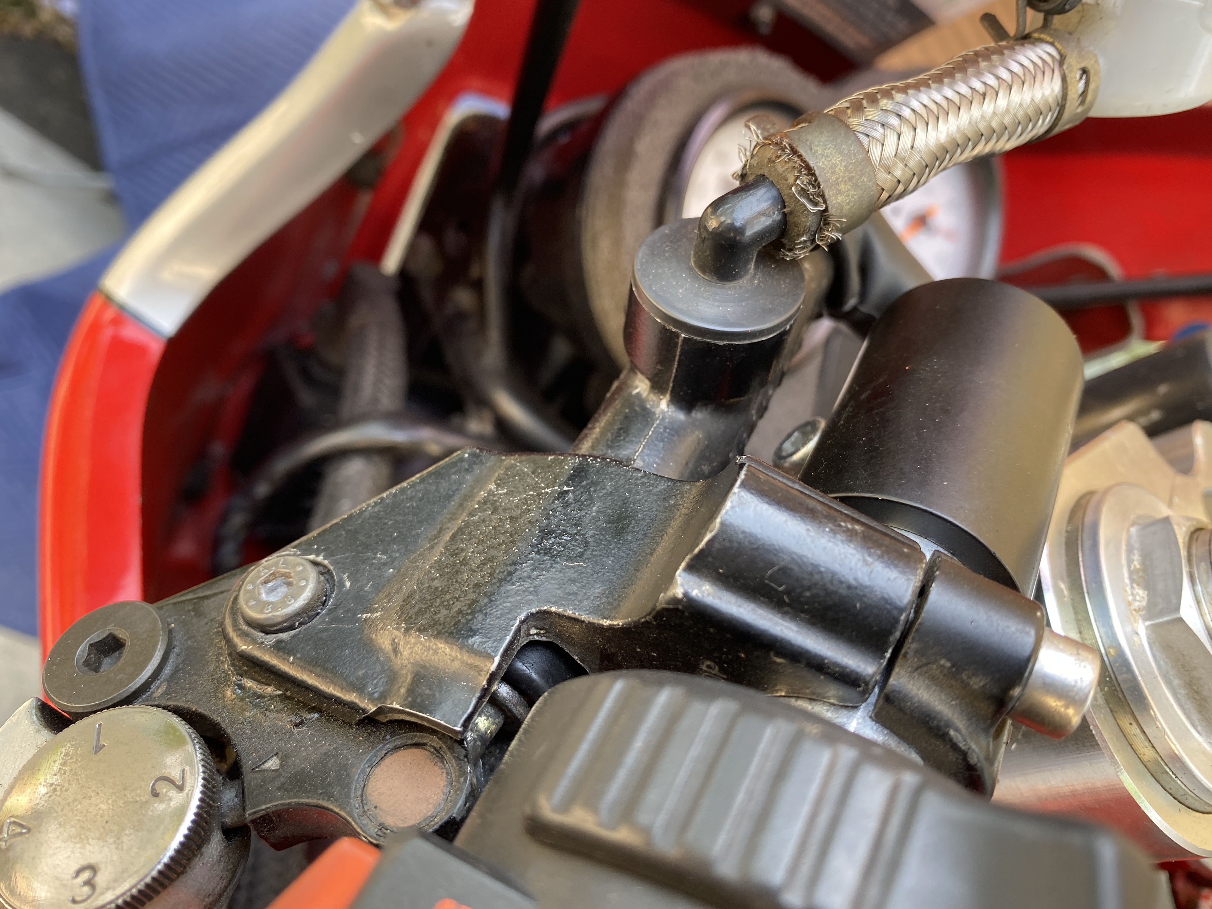

  1. The Clutch MC has given up the ghost on the '88 750 Sport. When I went to local Ducati guys they said it was likely a Yamaha. Was this a common upgrade or did the previous owner just cheap out!? Any good replacements that are used on 900ss etc? Anyone recognise it?
  2. Don't recognise it, I would replace with a Brembo one. I prefer the ones with a remote reservoir. Most are rebuildable with readily available parts so get one secondhand on eBay?
  3. Yamaha and the japanese stuff used a 14mm master, your ss will have had a ps13 as standard.
    Widely available so picking one up shouldn’t be a problem :)
    It’ll have 13 stamped on the underside. :)
  4. Thanks guys. Turns out it was the banjo bolt that had loosened and was breaking the system! All good info though and I will likely replace then anyway cause they are fugly!!
