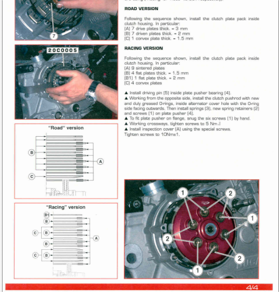

  10. I needed to reduce the pack thickness on my Monster's clutch as it was a tad too thick and dragging, making finding neutral whilst stationary impossible. I replaced some 2mm plates with 1.5mm, the only 1.5mm plates I had at the time were dished so I used them and it dragged the same - got some flat 1.5mm plates and problem solved.
    If you think about it a 1.5mm dished plate is over 1.5mm thick due to the dishing and yet doesn't make full contact with the friction plate when clamped because it's not flat. I don't see what advantage they give? Clutch takeup is fine without them and I can only think them more likely to slip, so I don't use them anymore.
