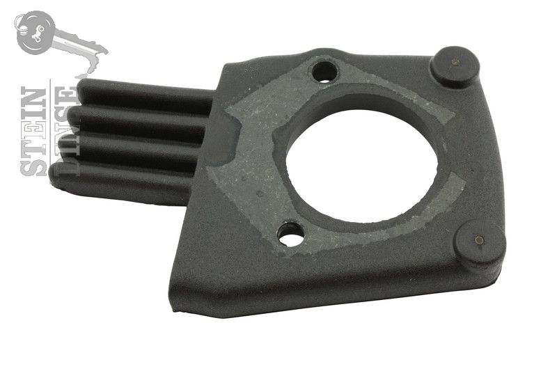

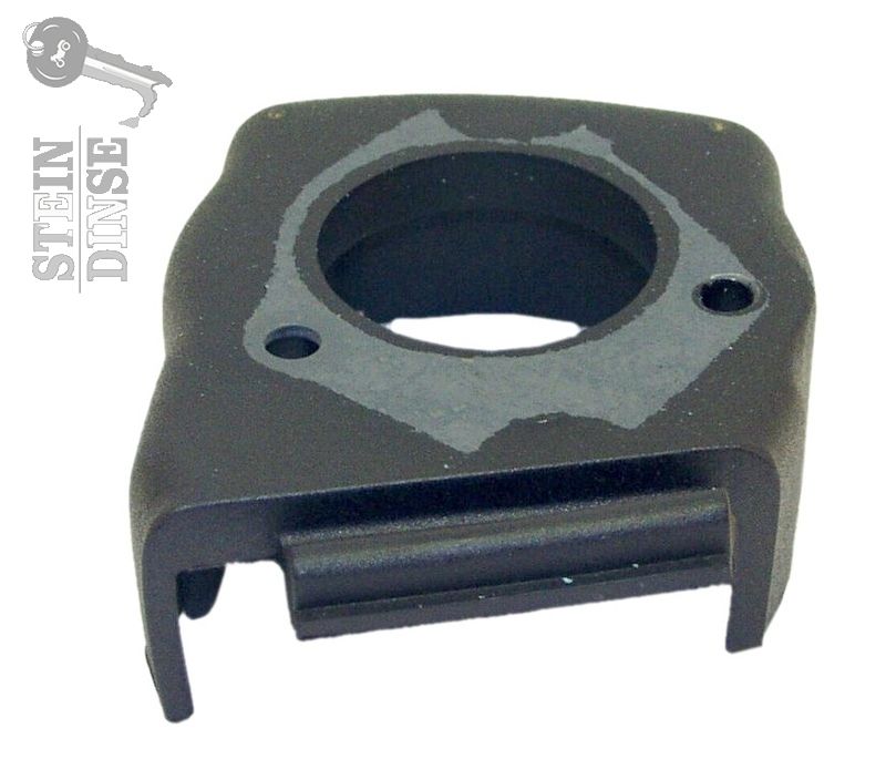

  1. ....and that is the problem. I luv it.....I can see that if the issues are sorted, I've got a really nice bike. Just a bit gutted, that's all. Are those rubber pulley housings readily available?
    I'll give the dealer a ring on Tuesday to see if we can come up with something. So now trying to run down some decent used parts.The hard plastic belt covers. Or are they cheap enough new?

    Not sure what you mean with the rubber pulley housings. Got a pic?
  3. Here you go...
  4. And as an added bonus, the lower rear cover attachment point gone as well.....

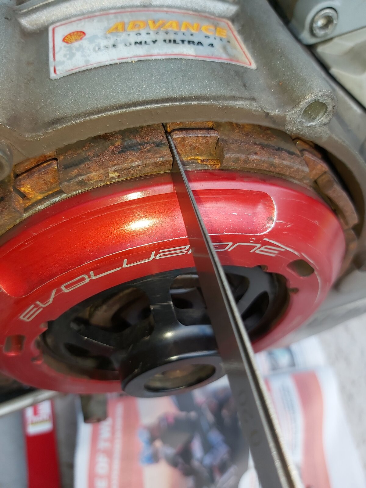

    • WTF WTF x 1
  6. Looking at the rust on that clutch it would definitely benefit from stripping, a dam good clean & new plates ;)
  7. tbh i have seen worse, open cover, salty roads ...
    if the slipper drum and ramps arent too hammered, get an stm or EVR 48tooth ally basket and plates set, they are far superior the 12 tooth design
    hard to tell from that photo but the belts look pretty new fwiw
  8. Rubber grommets, although not brill, look very simple to sort.
    Ditto clutch. Looks shagged but parts may be salvageable.

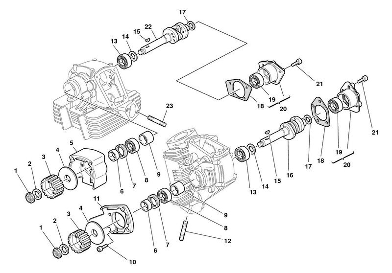

  9. stein dinse website is a good reference for parts as the diagrams are the same that ducati dealers use
    parts are showing available
    would check local ducati dealers for price you might be suprised
  10. To me, it all appears as normal wear and used condition for a 20 year old bike. It just needs a bit of love and a good deep cleaning. I do not see a dealer do that. It’s too time consuming and customers are rarely willing to pay for this many hours to get a dealer restore this type of bike. SSie are quite low value at the moment. It makes them affordable at purchase, but they are still Supersport Ducati’s, and require proper maintenance to run well. Which does not come cheap.
    Now you, as the new owner, are the ideal person to tidy your bike. You’re not a mechanic? Get the books (Ducati Shop manual, Haynes, LT Snyder D2/D3 maintenance guide), read the forums, watch videos, and slowly start discovering what your bike is made of. You can find pretty much every spare parts online. Stein Dise is one example. But there are plenty of others.

  11. Hi Ricky, It was a bit difficult with lockdown, etc. As I said before, maybe I read too much into assurances of 100 point checks and specialists....I suppose strictly speaking, just because you check something doesn't mean that you actually do anything about it!
    Given what's happened so far, I suppose the only thing to do with the clutch is to whip it apart and have a good look at it. But I'm guessing at least a new basket and friction plates.....

  13. Clutch's are fun to do. Because they're relatively simple and they're on/off in moments. (as long as you have the right tools) I use one of these as a holder tool. But you can also take an old drive and plane plate, drill some holes, screw them together along with a bit of flat for the handle and make your own. That one of yours just needs a good clean and service. I'd be inclined to buy new plates myself but they may be serviceable. They do stand up well to abuse.

  15. Your basket doesn't look that bad to me, I've seen worse

    @Speedy23 dismantle the clutch and see what can be salvaged before shelling out money, you’d be surprised what some 400 grit wet & dry paper and elbow grease can achieve :upyeah:
