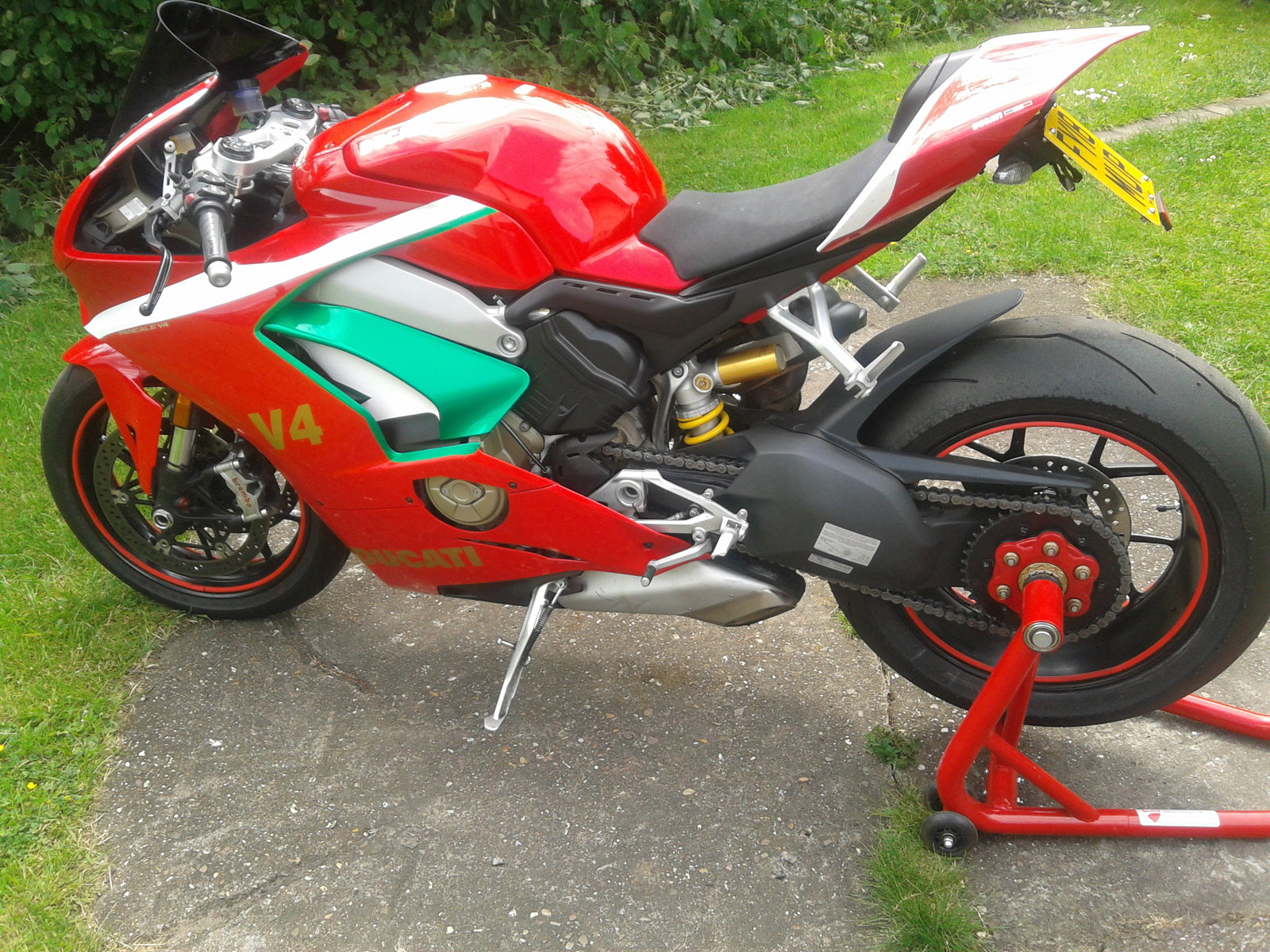

  9. mine is almost imposible to get out of gear wen the engine is running now its dun 1000miles & 2 track days, so wen u have to show ur wrist band before u go on track I have to switch it off, it has been bled twice so I hope this up grade sorts it out, wen I had my 1098 that was always needed bleeding I think a cable clutch is the best 20180614_140008.jpg
