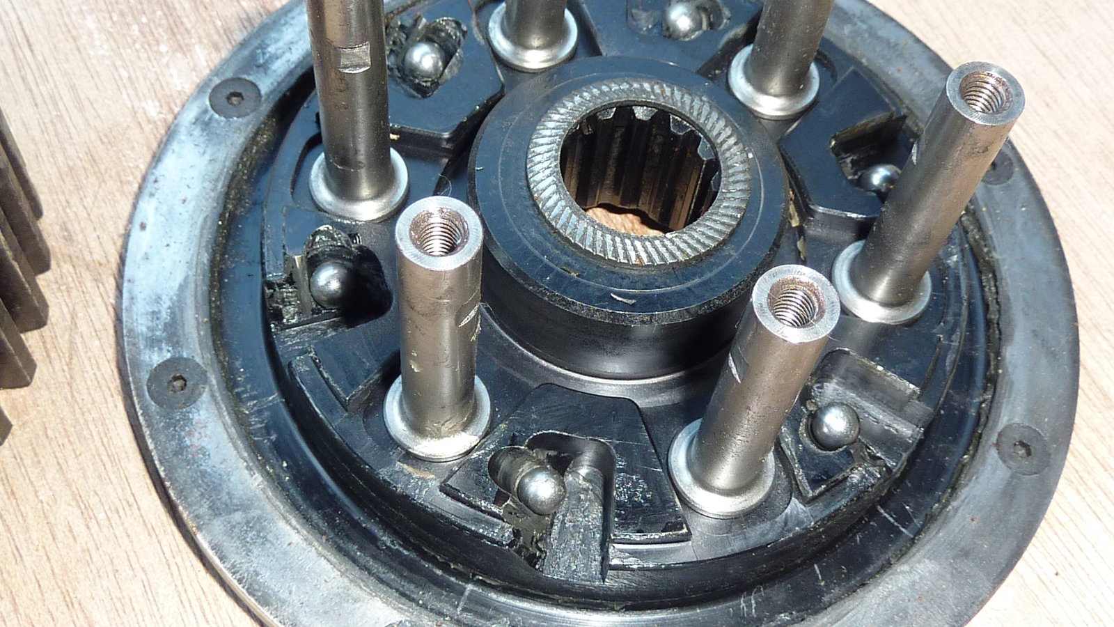

  6. Your instructions say that too high a stack can cause the ball bearings to overflow from the ramps.
    That sounds as though it could cause damage and putting a plain plate in first will probably push the stack up the basket

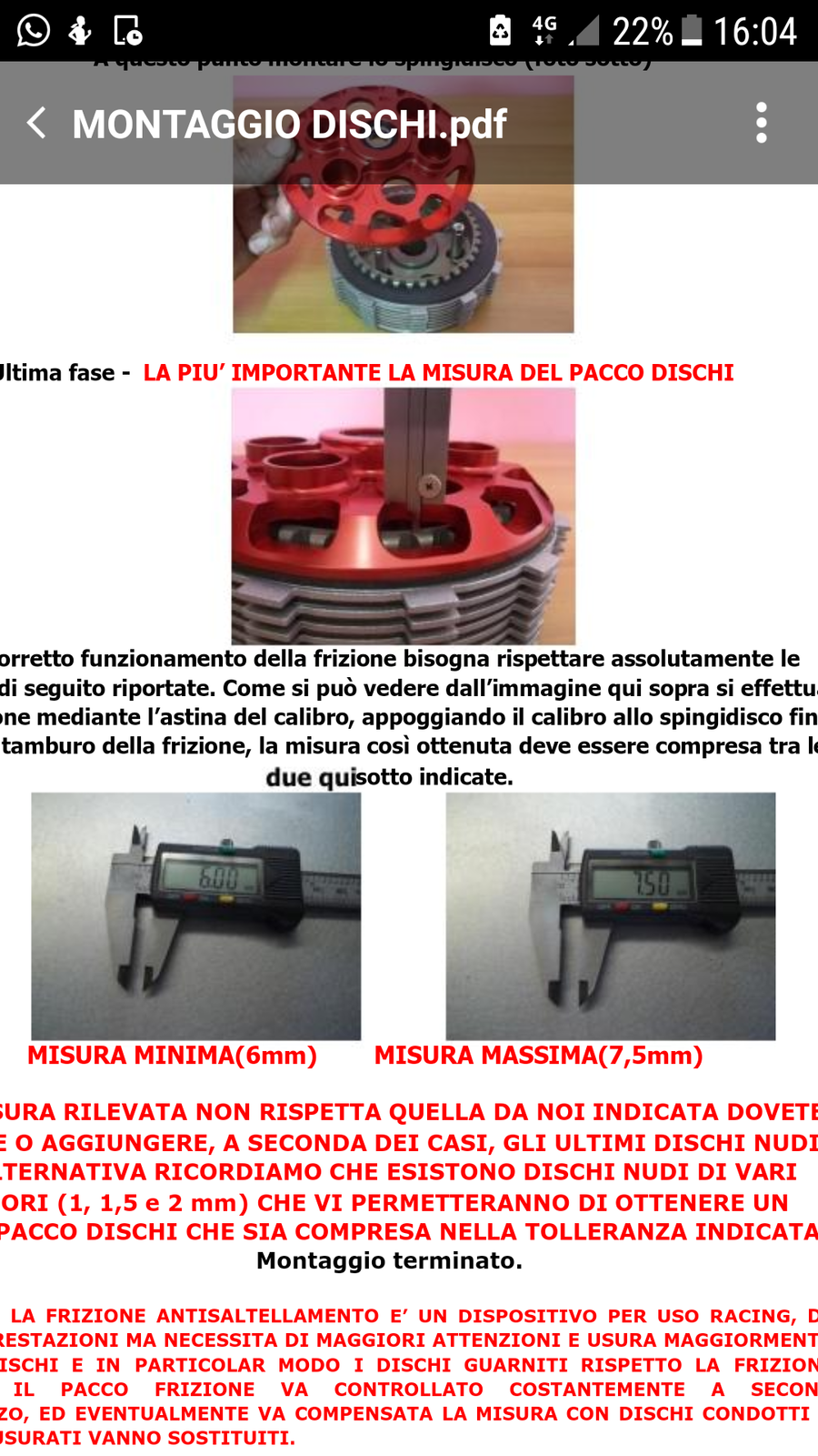

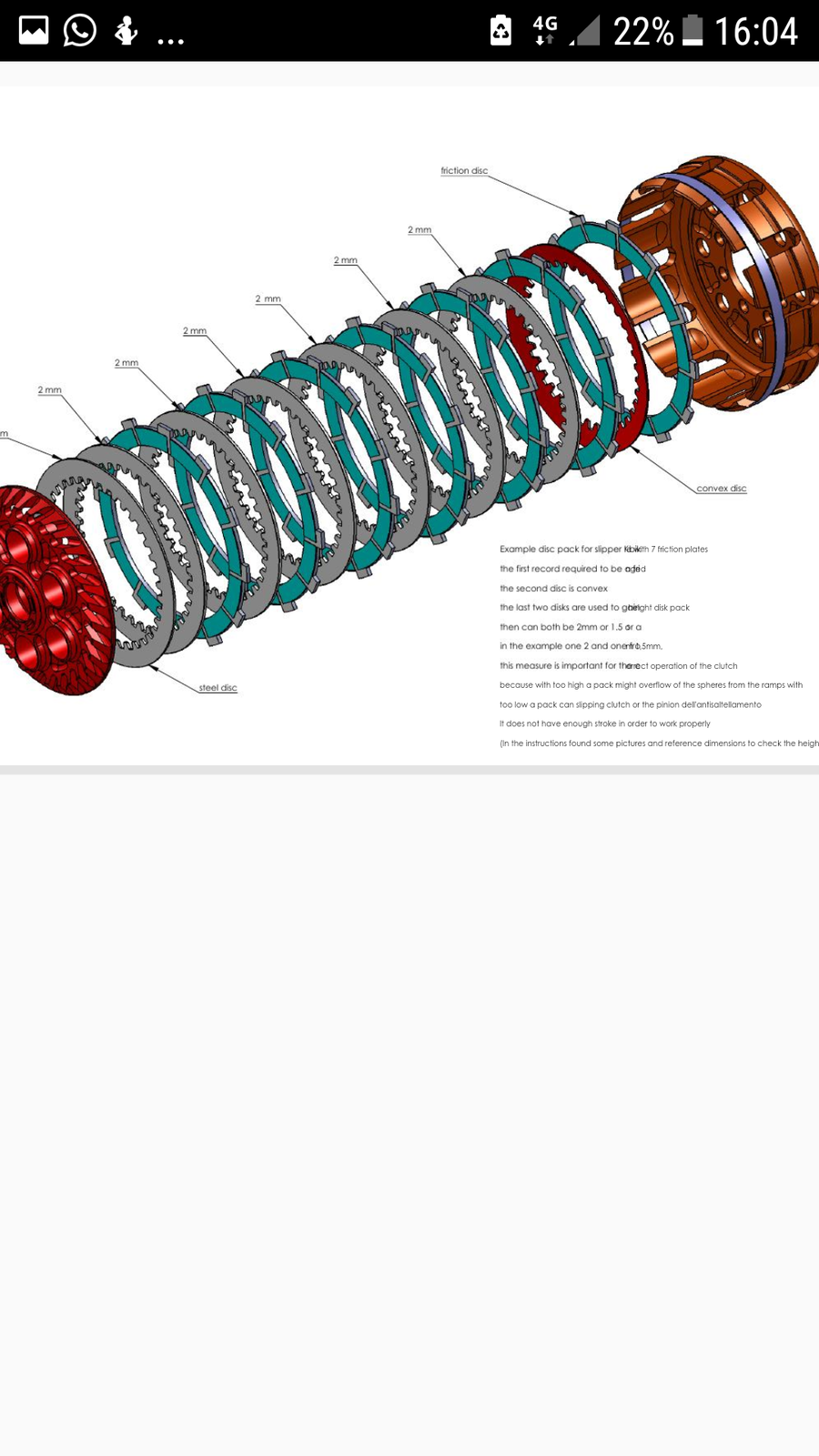

  8. As you can see the instruction have an example with 2mm steel plates? So im thinking maybe try it with 2mm plates?
    Also iv attached a measurement that is included in the instructions but not fully sure what that is.
    Really wish i didnt bother with the slipper now more hassle than its worth

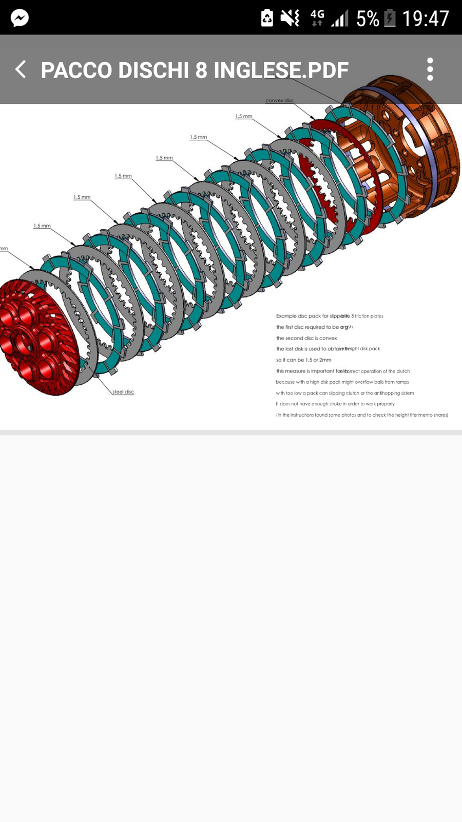

  9. I know bugger all about slipper clutches but you have posted 2 different sets of instructions. One with 7 friction plates and 2mm plain plates, the other with 8 friction plates and 1.5mm plain plates, entirely different set ups. If you swap all the 1.5mm plates for 2mm ones and retain the 8 friction plates the stack height will surely be too high.
    I'm running my 907ie with 1.5mm plates throughout which enabled me to fit an extra friction plate and achieve the required stack height. The greater surface area of 8 plates seems like a better idea to me. I would keep the 1.5mm plates but swap some with 2mm plates until you get the desired stack height.

    The toothed hub rises up on the ramps, if a steel goes in first when the hub rises the steel can drop of the back of the hub which can then jam it up altogether.
    Steve
