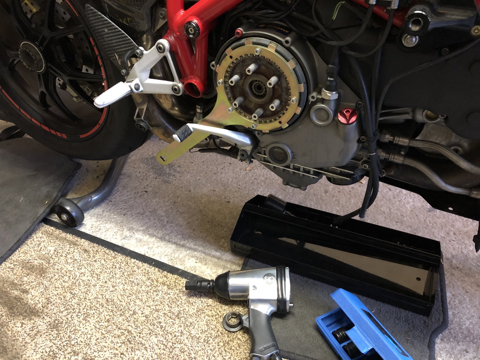

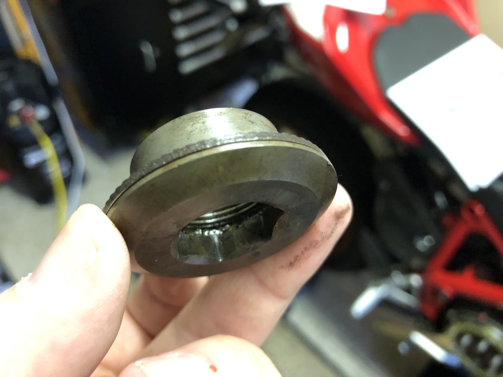

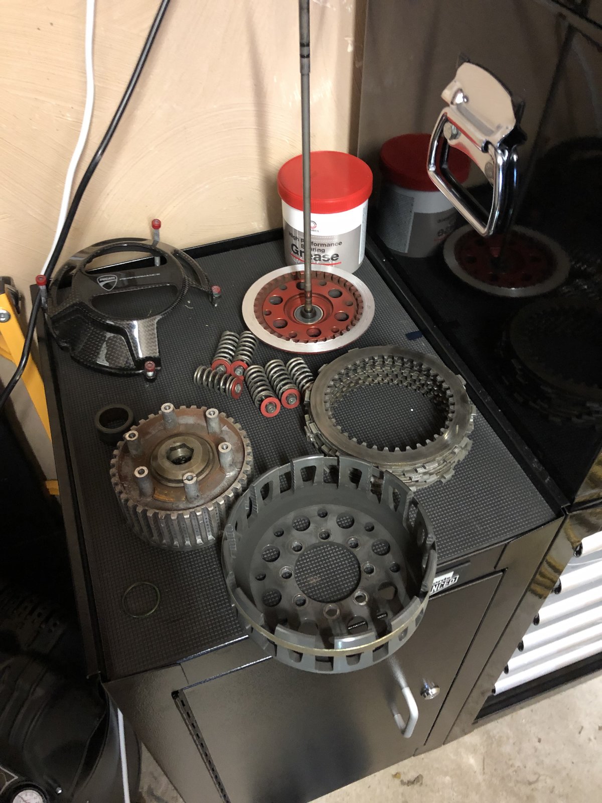

  7. AADACA79-36C7-48FD-BC71-FC18CD30FD40.jpeg 0DF75C83-6125-4796-A0C3-8E7385BDB35F.jpeg 0DC3439C-85A1-46C3-9A1B-56C450DCC359.jpeg D969EDC9-C18A-4E4F-9636-D4637D8A9FED.jpeg Shit old clutch removed and uneven wear of the plates have been observed thank god i’m changing it.

  19. I am using the information supplied with the clutch as I am replacing the whole assembly or are you referring to tooling then I am using vernier callipers.
