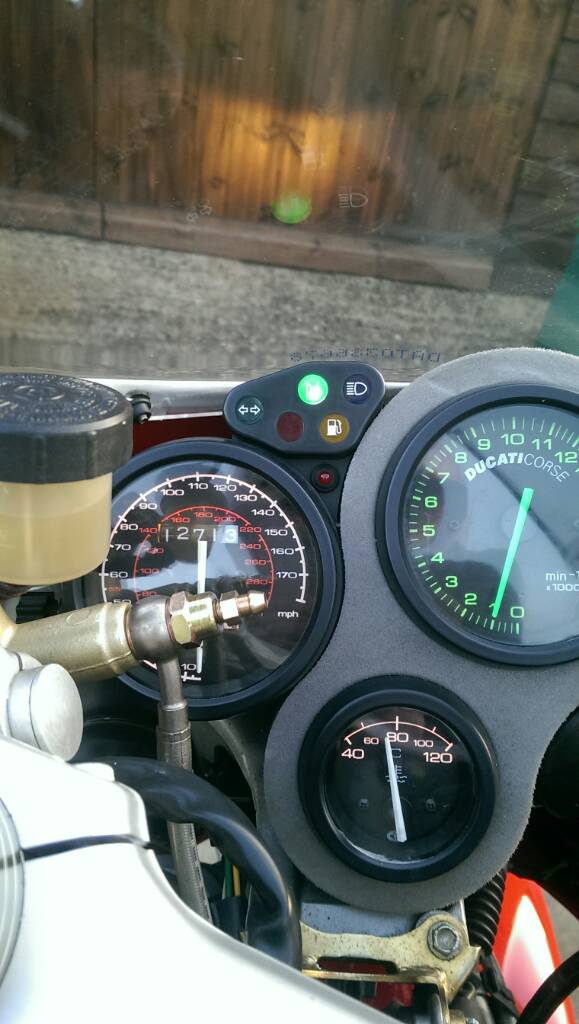

    Bought a banjo with bleed nipple for master which I'll fit when T9 back on road. I don't like both bikes in bits........
  6. Neutral FIXED!
    Fitted the bleed nipple banjo, quick bleed at top only and BOOM!
