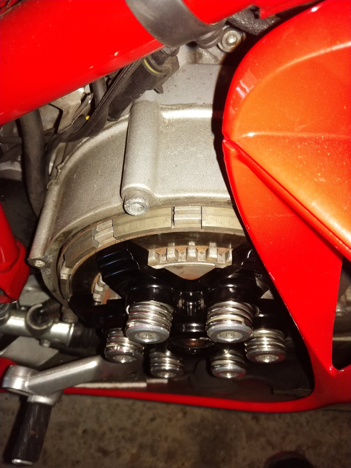

  1. As in title what is the correct clutch stack height and count of plates to use? Want to sort out my clutch ASAP as put new plates in and drag as hell.
  2. Ime, thats likely to be the new plates binding in the basket slots as the clutch warms up.
    Cure is to put some of the old worn plates back in at the top of the stack to allow the clutch to clear.
    Once the new plates at the bottom have run in a bit, you can put them at the top and your not run in ones at the bottom.

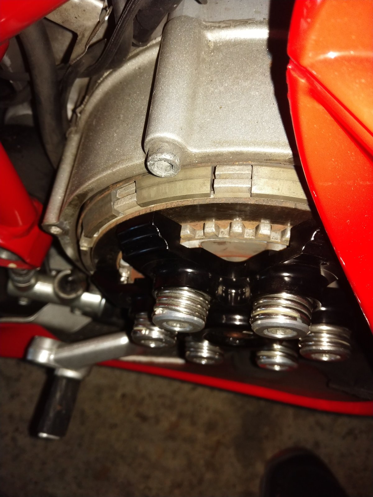

  3. How do top plate tangs look sitting in the basket slots? Are they flush or “under flush” and by how much?
  4. Ok so I have stack height 38.32 to 38.38 so all good.

    When I change gears now I can force them in while stationary but it is a force in. No way to find N till engine off or rolling.
  5. Flush when clutch disengaged sticking out a bit when clutch pulled in
  6. Chris maybe even slightly under flush by a 1mm max

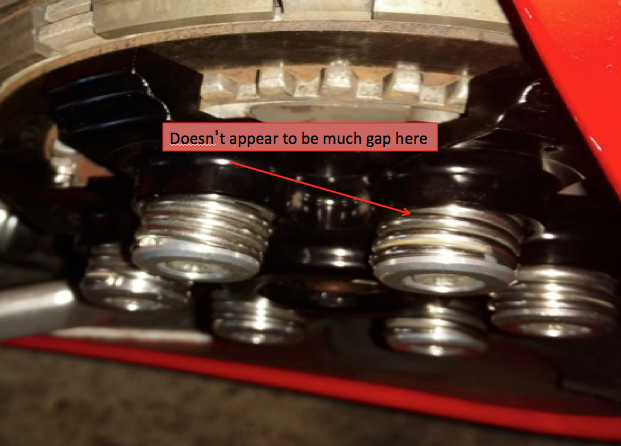

  7. 1) the springs in your pictures look almost coil bound..

  8. Andy what do you mean by point 1
  9. Coil bound means the springs are fully compressed and touching each other...
  10. so when you squeeze the clutch in there isn t enough gap in the coils to get the full movement for disengaging.
    Are they new springs, what about the height of the spring caps too ie how tight did you have to turn the cap screws in before the caps bottomed out...
    both of these would restrict the amount of disengaging you are getting with the clutch........or of course the clutch pack height is too tall...

  12. @Lucazade assuming it is a non slipper clutch: have you fitted the pressure plate correctly so that the teeth engage correctly on the drum? That may explain the coil bound springs that @andyb kindly pointed out.
    On a standard plate, one needs to line up the cast triangle on the plate with the spring post with a notch.
  13. Ha forgot about marker will check thx.
    Caps are same as stock.
  14. Severe drag can also be caused by new (aftermarket?) friction plate tangs binding in the basket slots as they expand with the engine warming up.
    Symptoms for this are clutch works fine at start up with a cool engine but suffers increasingly from drag as the motor warms up.
    Have we established if this a slipper or conventional clutch? Pressure plate looks unusual...
  15. we have established ive lost the will..does that help?:upyeah::)
  16. Hope you find it soon :( yet to write mine.
  17. That's not a slipper.
  18. Ok it was not aligned. Moved in in morning will test tonight or tomorrow.
