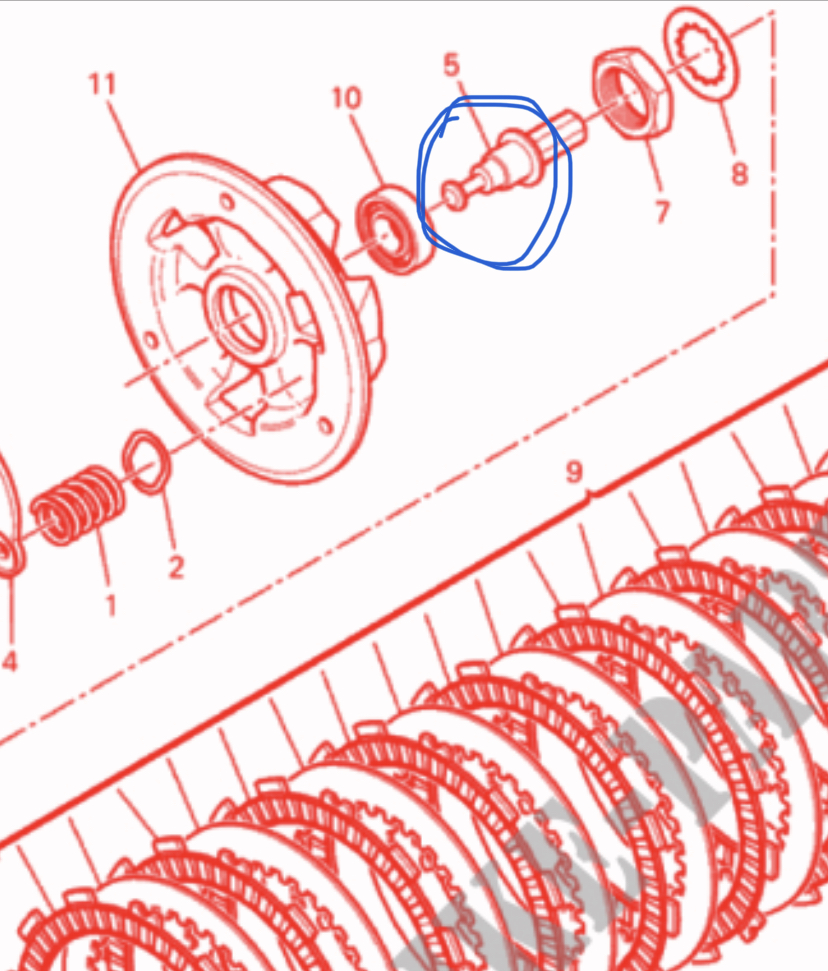

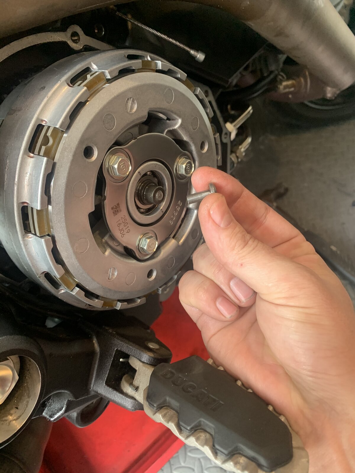

  4. From some research and logic i think it looks like the lifter pin has snapped or the end of the push pin has snapped off.
    circled in pictures
    hopefully a simple fix going forward.
  5. Agreed. That's more or less what I was hinting at in post #5.
  6. Boom! F*cking knew it!!!
  7. At least it's an easy fix. I hope that doesn't happen to my Scrambler or Supersport, both of which have the same clutch operating arrangement.

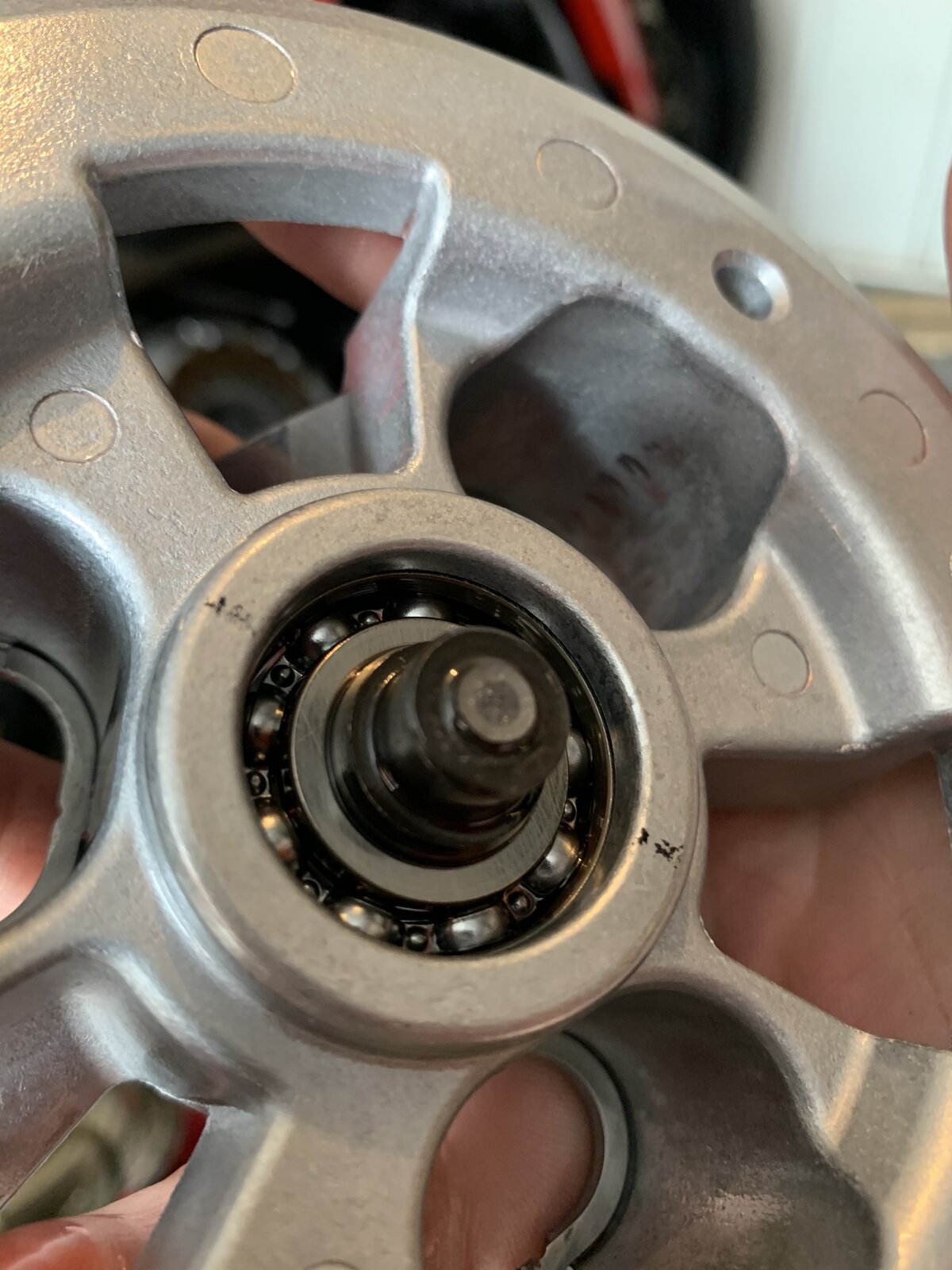

  8. Im now thinking why did it snap?
    should the lifter pin have movement?? I dont want to put it all together just for it to snap again??
  9. I have no idea. I haven't had occasion to meddle with one yet. I would imagine that it should rotate as it sits inside a bearing but I think there would be little axial movement as that would result in lost clutch lift but it should certainly move to compress the springs when it is activated by the lever.
  10. Manufacturing defect? :thinkingface: It's snapped right at the base of where it's been machined.

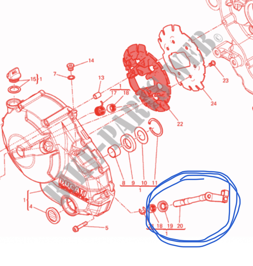

  11. No, i mean number 20 on this image, should that have up & down movement.
  12. Yes. The snap ring at the bottom should limit any up and down movement.
  13. Just checked. The levers on both my Scrambler and Supersport have about 3-4mm up/down movement.
  14. So it must be normal then.
    Cool

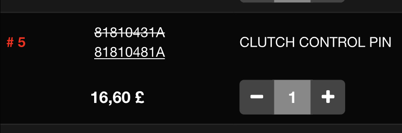

  15. Not happy that it broke at 3500 miles and the bike has full history.
    Also noticed that the part number has changed.......wonder if they improved the part because of failures......

  17. No apparent recall or notification either for my 2018 939. Any clue when the part number was changed?
  18. That's exactly why i asked about the movement in the lever shaft, the up & down movement will cause force up & down maybe on the part that snapped.
    I haven't a clue why the part number has changed, i will be speaking to MotoRapido tomorrow so hopefully shed some light.
