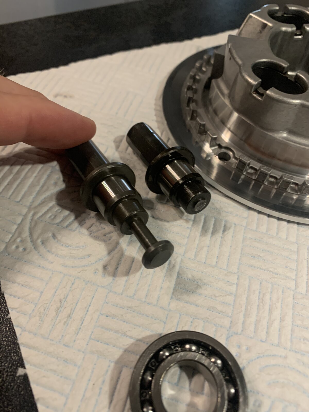

  2. Parts ordered today:
    Black ThreeBond
    Clutch control pin
    Bearing
    £59

  7. exactly that....just incase bearing got damaged on removal. I used a socket to rest the inner race on so when I pushed snapped pin out, the bearing didn't follow etc. So bearing was not used.

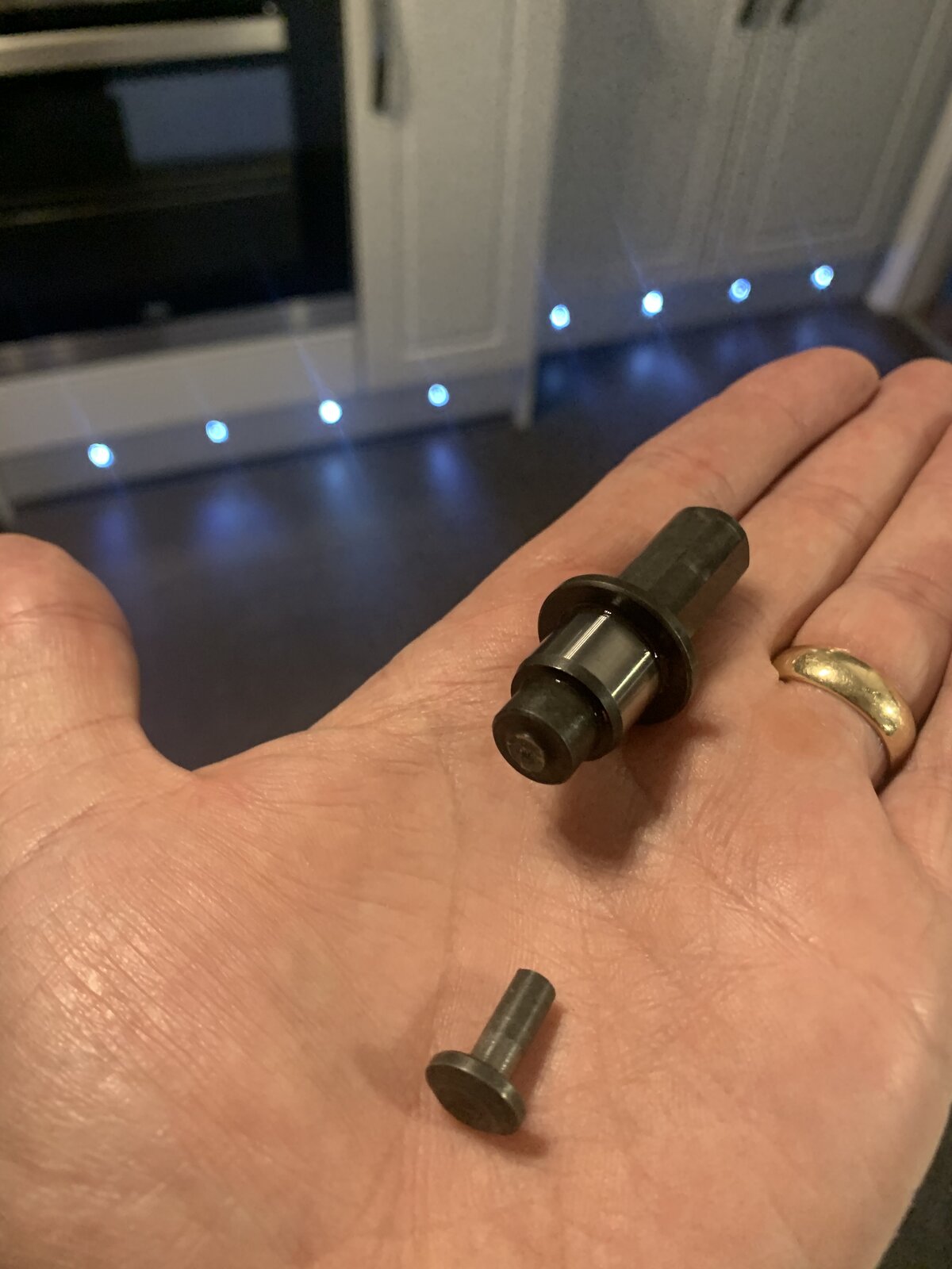

  10. Hope you found the broken pin bit...;)
  12. Sweet. Better out than in... Any clues about why it broke?
  13. Not a clue......
    Hoping it was just because manufacturing fault etc
