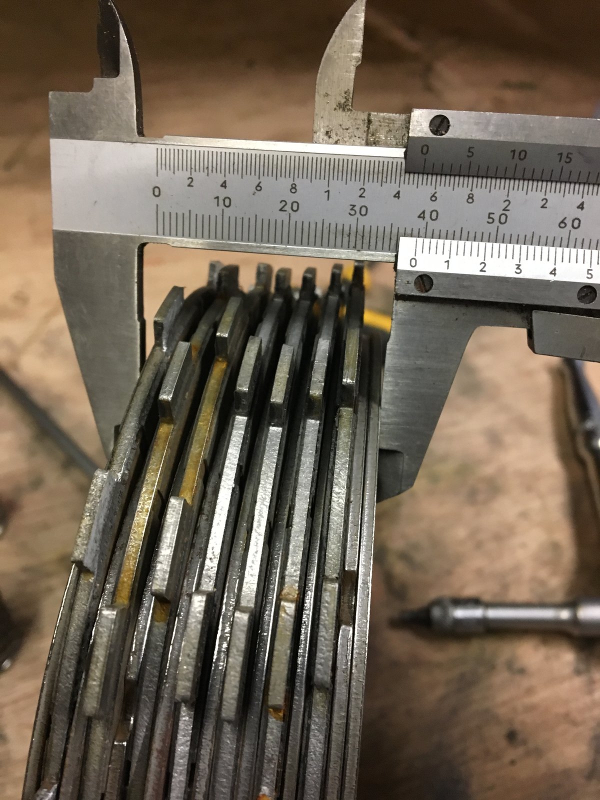

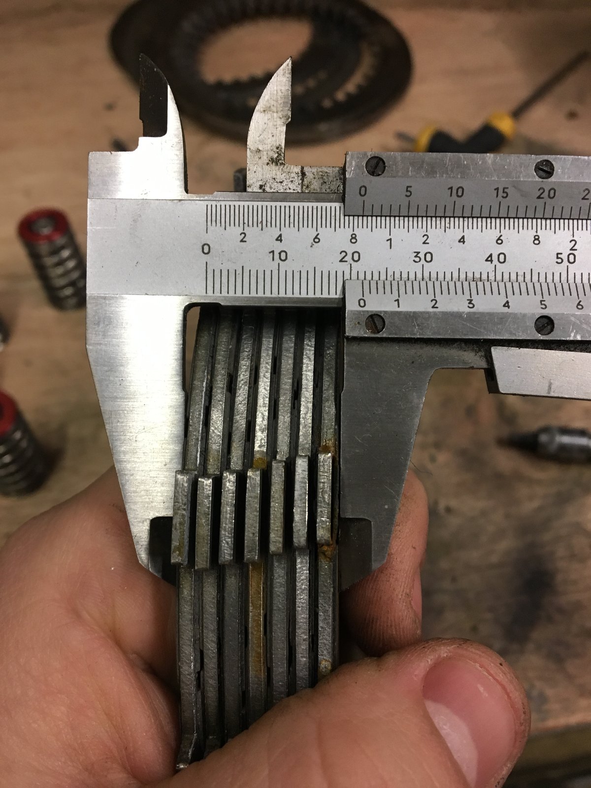

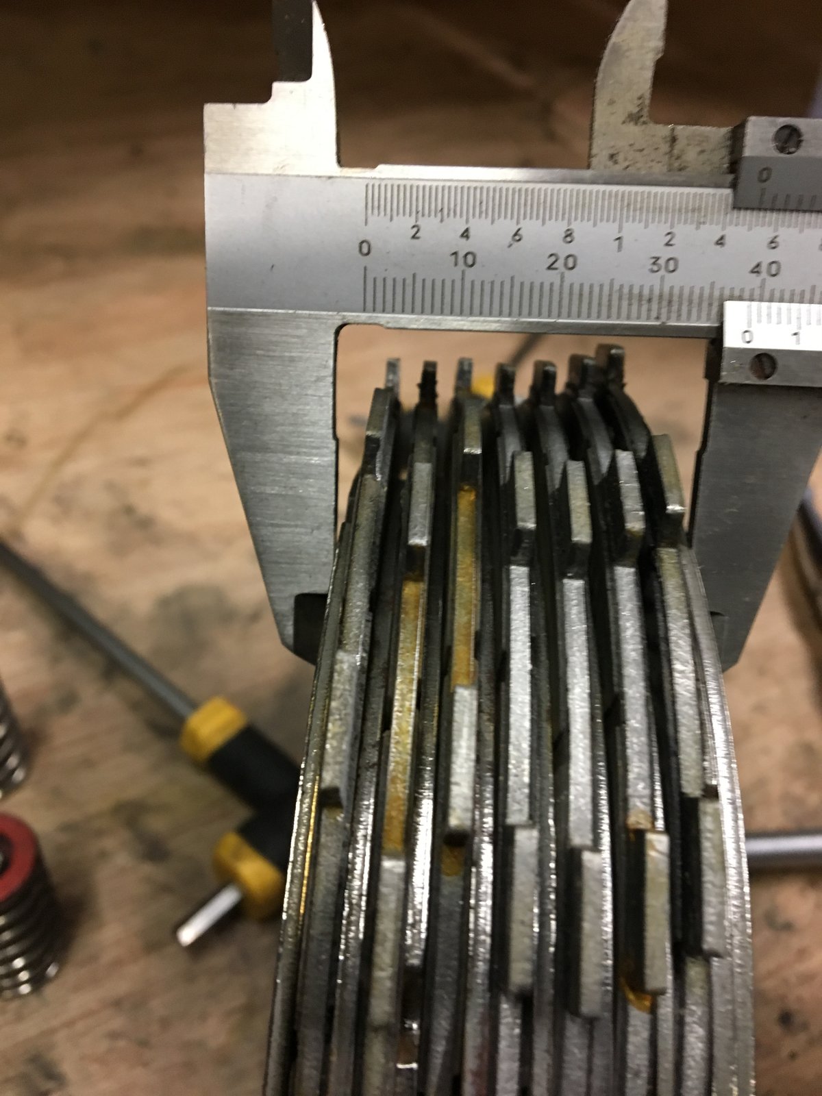

  2. I’ve taken it apart and cleaned and rebuilt. Few steel plates were rusted and sticking.
    Went out today again and the last plate has jumped out again
    Also, there is some binding when on the paddock stand and pull the clutch in, quite hard to turn the back wheel.
    From suggestions, thinner steel plates worth trying?

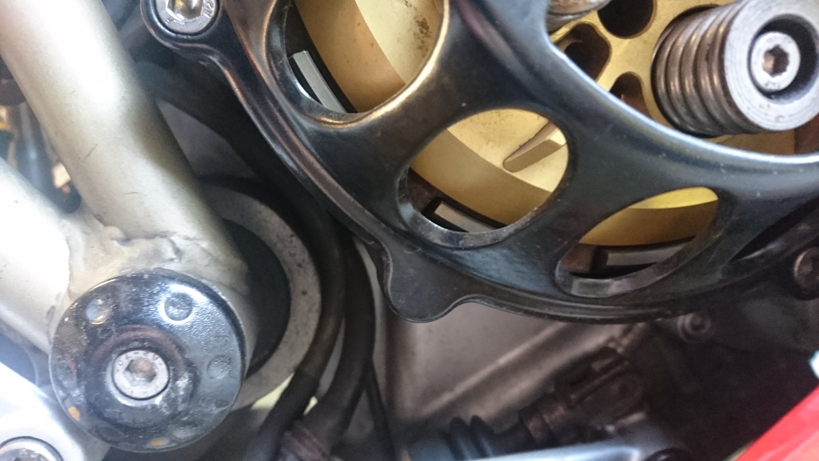

  3. You have something wrong with your clutch stack, in your very first pictures you last friction plate is almost flush with the edge of the basket, so when you pull the clutch lever it will jump out of the basket.
    When you take your plates out is there one stuck in the bottom of the basket ( someone trying the quiet clutch mod)?
    My picture isn't very good but you can just see how my last friction sits in the basket.

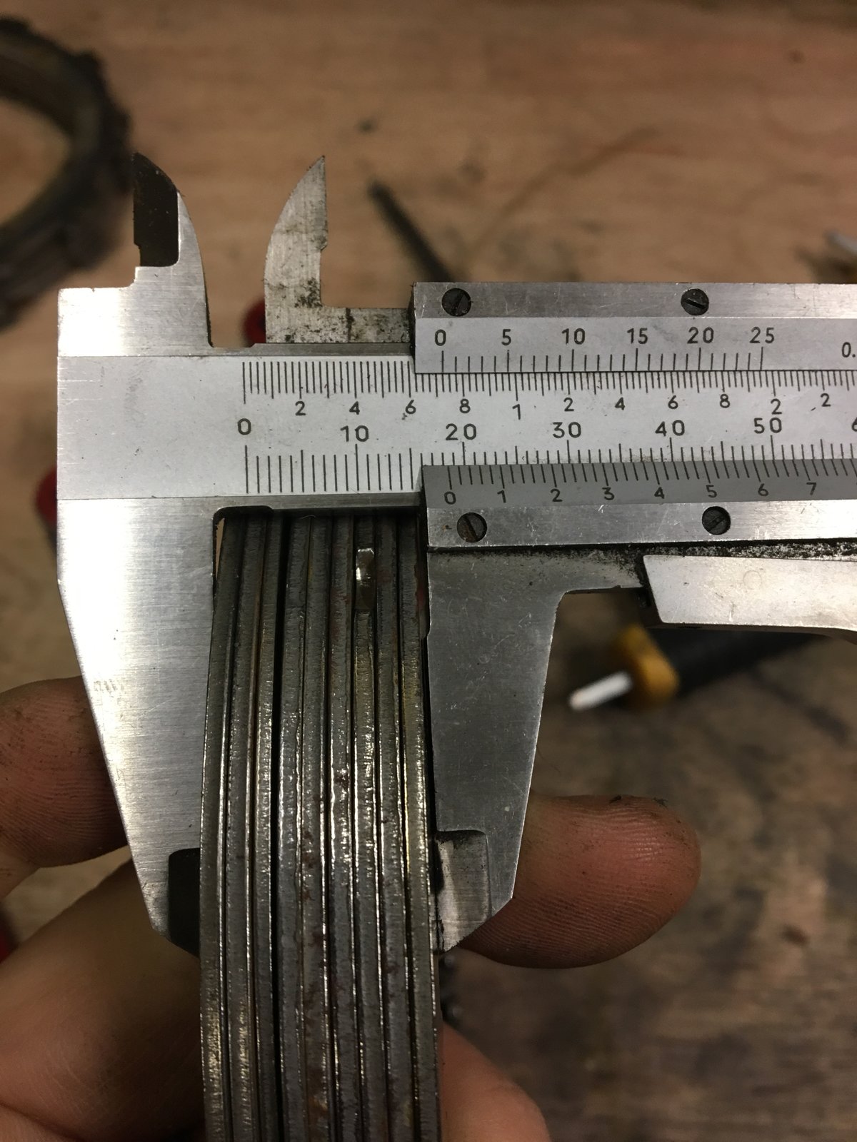

  7. Just a quick update, took 1 of the 2 2mm plates out (1st in) plates not flush on the edge of the basket now.
    Took it for a quick 4 mile run up to 80ish. No problems.

  8. So a bit under 38mm stack height... ;)
  9. More likely to be more like 34mm so I don’t expect it to be correct just yet
  10. If you can locate some 1.5mm plain plates, then some careful swapping with 2mm plates you can get the stack height you want.

  17. Afternoon mate.
    I stripped it back down and in the end I have removed one of the double 2mm plates.
    I did this on the 1st day it started snowing, nipped out for few miles and seemed fine.
    Unfortunately the weather has hindered a more substantial test but I am hopeful
  18. Tried today. Still slipping
