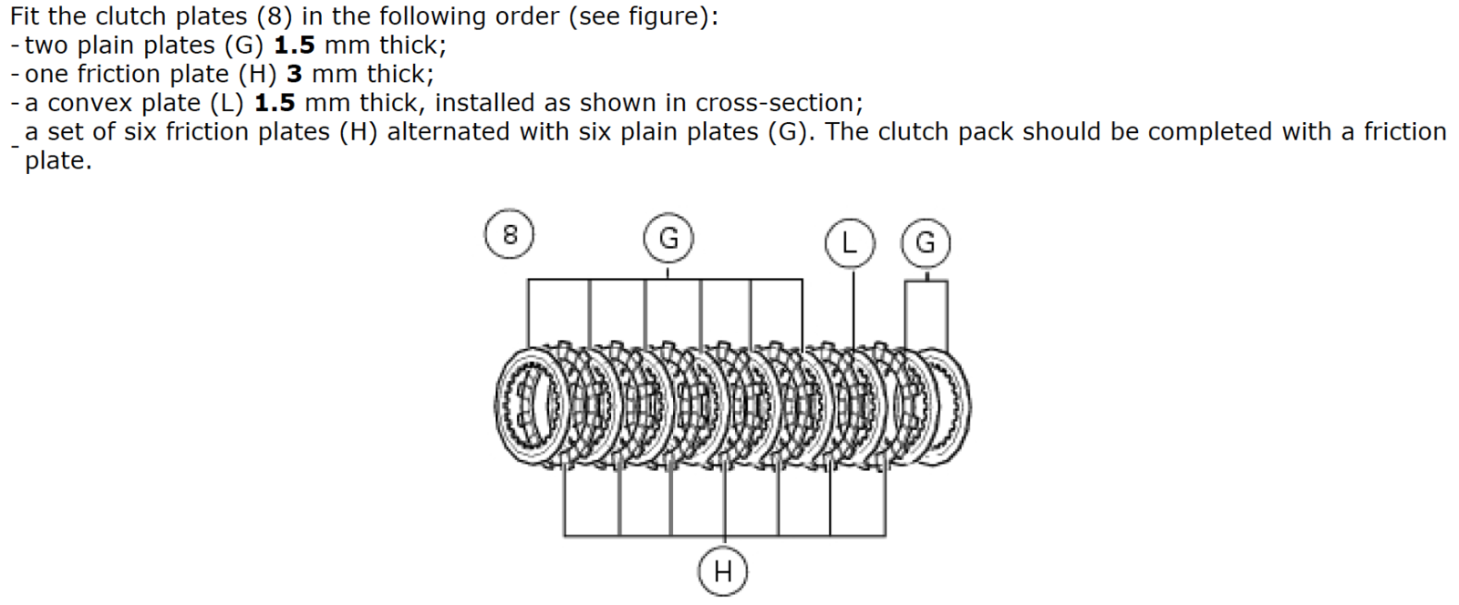

  1. Starting to see why ducati,s are a love hate thing, begining to hate the sodding thing, pulled the clutch apart as it was layerd in dust, looking at the plates they were worn, so just orderd a new clutch from germany, cleaned it all out, fitted the plates as per instructions, tried it and its clunky to get into gear and i cannot get neutral whilst stood still, adjusted the clutch lever and bled the slave, twating thing is still the same, but i havent had a run on it, doubting that would make getting nuetral any eaisier?, i didnt measure the stack heights of the new and old unit, clutch feels heavy, before it was a little rattly with the clutch out, now its a little rattly when its pulled in.

  4. "New clutch from Germany" ? Ducati genuine parts or aftermarket ? Slipper or not ? How many friction plates, how many steels in 2mm, 1.5mm ? Any dished plates ? Broadly speaking non slipper starts with steel then friction, slipper starts with a friction then a steel. Aim for a pack height of 36.5mm +0/-max 0.5mm. Andy
  5. Its an aftermarket non slipper, 1 dished,9 steels,8 friction
  6. The steels should be a mix of 2mm and 1.5mm. If your existing steels measure up you can reuse them. My preference is to run 2 x 1.5mm dished plates either side of the same friction plate although some use 4 and some don't use any. If your frictions are sintered you'll probably need all 8 but if they are organic you might only need 7 and make up the pack height with 2 steels last under the pressure plate. Andy

  8. The new stack is 39,6 the old is 38.2 thats with all the right amount of plates in each stack
  9. Take a doubled up steel out.

  10. Ended up taking one of the double steel plates out, still not quite right, but tabs on new frictions are a lot tighter in the basket compared to the old ones, i,ll give them a bit bedding in time then try the doubled plate back in, thanks for all the advice, but still havent fallen in love with it yet,
  11. Don’t bother putting it back in. As I said, aim for a lower rather than higher stack height.
    Doubled plates run together and don’t move relative to each other, so perform no special function other than to increase stack height.
    Putting old non-binding plates in at the top will allow the clutch to clear and not drag.
