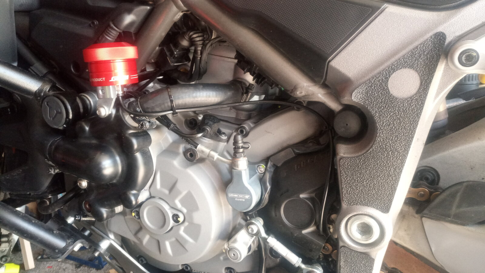

  7. Finally got round to fitting mine, really pleased with it, seems to work well.

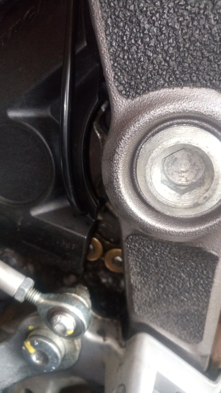

    My solution for mounting the feed pipe was just to drill a hole in the sprocket cover and poke the pipe through. Pipe's a tight fit but I'll glue it at some point.

  10. Mine hasn't come yet, bought around the same time, could you do a few more pics of the install, please??
  11. Reservoir is just on the water pump bolt at the moment, need to find/make a better bracket so it's pulled in a bit really. 15879969205712911067015974184161.jpg

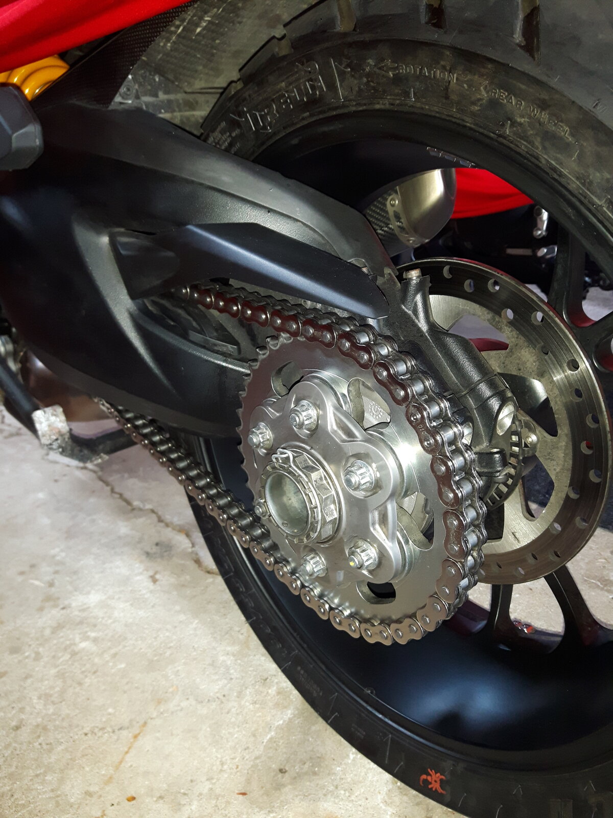

  13. You missed a bit ;)
