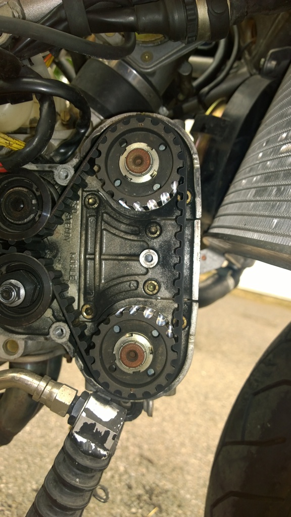

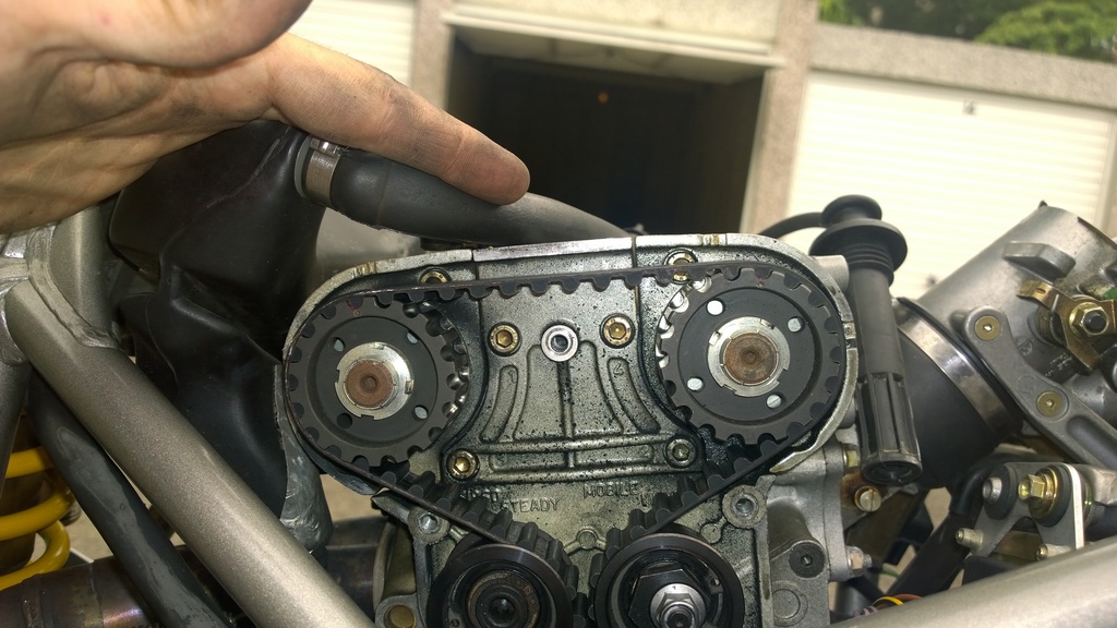

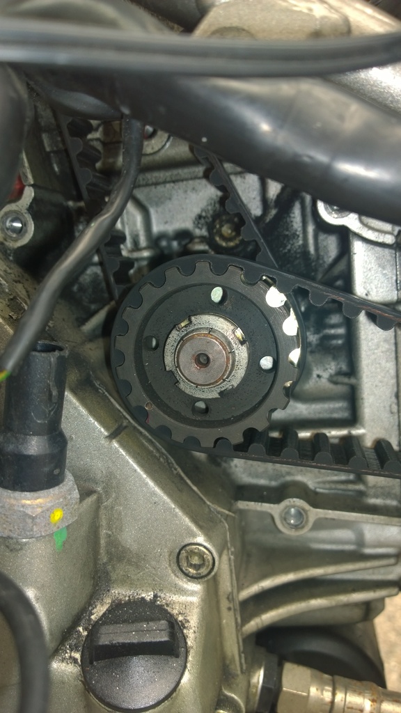

  5. Right, checked the timing:
    TDC:
    (didn't take a picture of the window on the left hand side of the engine, but was spot on)
    Horizontal Cylinder:
    Verical Cylinder:

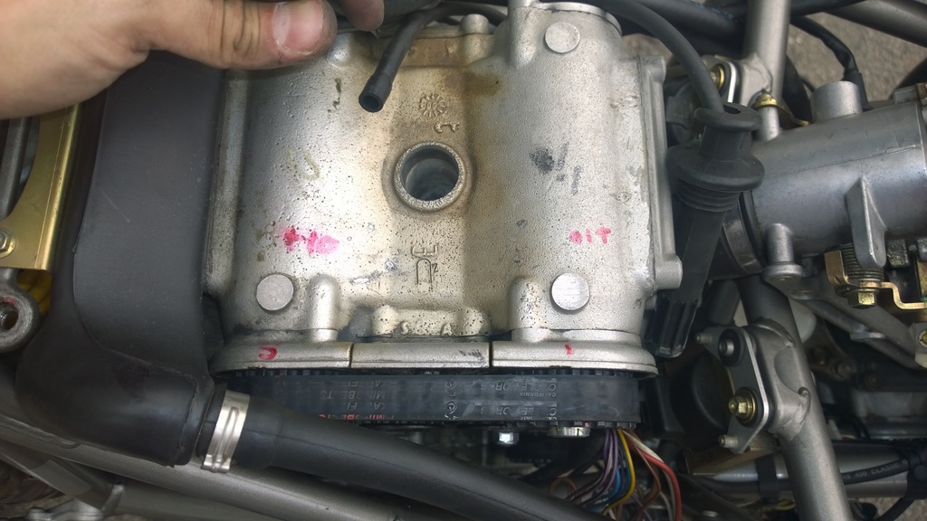

    now I know the intake cams are (or at least appear to be) offset by 1 tooth, and I am 90% sure that is how I found them when I replaced the belts as I remember having this exact doubt back then, and the reason why I left them as they are is found on the cylinder head cover, that reports 01T on the intake side (see below)

  7. I can't think of any reason for the cam on the vertical to be one tooth out, I would be inclined to refit the belt with the cam marks lined up correctly and turn the engine by hand to make sure there is no contact and if OK start it up. This could well be the reason for low compression and poor running on the vertical cylinder.
    Steve

  9. Urto, looks to me like your horizontal cylinder is timed OK and the vertical one is a tooth out. Also the markings on the cam box could easily read +10 perhaps a cam timing adjustment in degrees. Not sure anyone would be adjusting cam timing at the belt and even if they were surely both would be set the same.
    Curiously enough many years ago a friend of mine bought a 2 year old Morris Marina as a spares or repairs car for £200 which had 30k miles on the clock, was pristine but was a really bad runner. 5 minutes looking at the engine revealed the timing to be one tooth out. That too had sooty plugs and had been 'serviced' by unspecified persons only three months before. He went on the fix the timing issue within 90 minutes and ran the car for 10 years then sold it on for spares and repairs for £200!
  10. I know, that surprised me as well ...
    Ridesafe,
    Matteo
  11. Looks like +10 to me too.

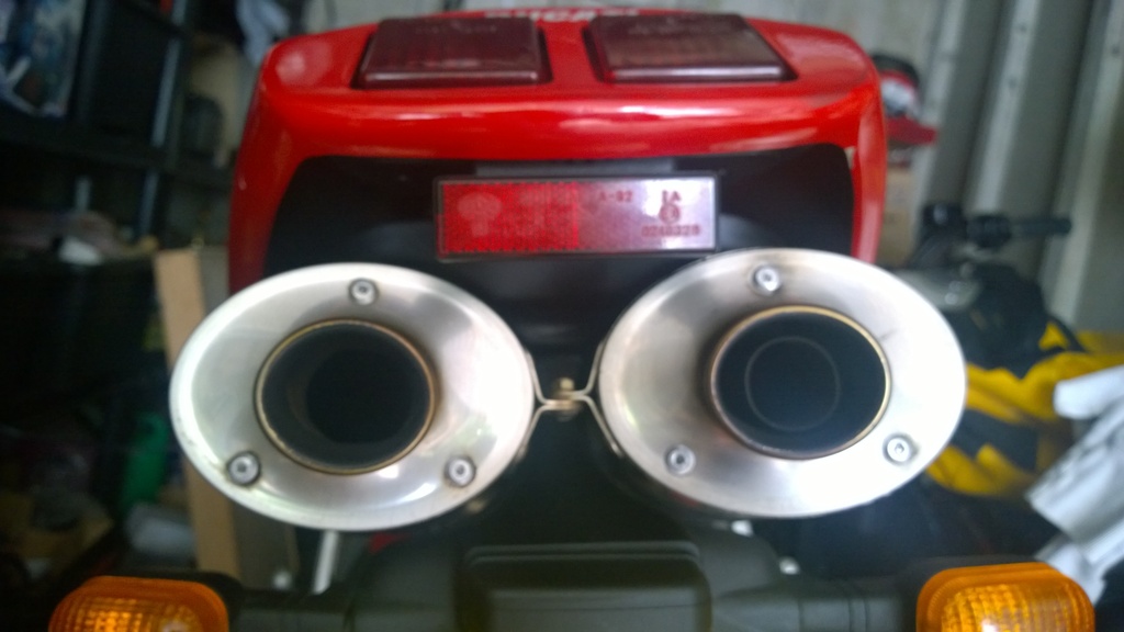

  12. I just realised only one exhaust has been "emptied" (i.e.: the end of the can hasonly the outer pipe, not the inner) .. the left one!
    I'm sure this explains it.
    I'm currently in the garage resetting the pulley, but as soon as will be back home I'll show you what I mean.
    Ridesafe,
    Matteo
  13. Here's what I was taliking about

  16. The intake cam is definitely not right, it's one tooth retarded so the intake valve is opening and closing too late.
    Hopefully it hasn't caused any damage (I doubt it would hit anything being retarded) so it maybe a case of setting it right and away you go (fuel leaks excepted). :upyeah:
