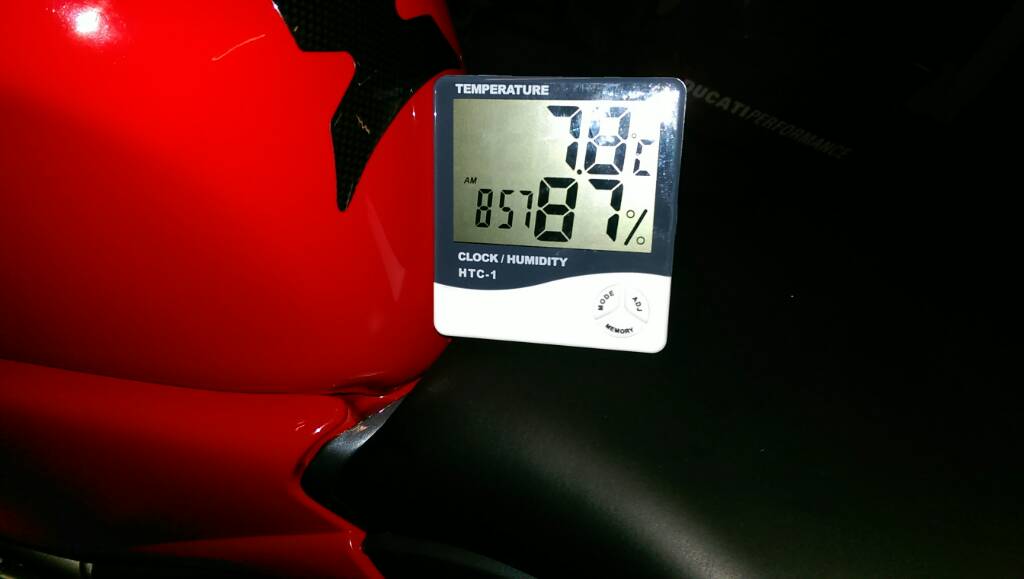

  2. Fair point
  3. It's vented outside AC
  4. Good news, dry bikes this morning and humidity dropped from high 90's.
    Maybe it was just the hot damp bike with a cold night and warm day?
    Will check lunchtime to see if having the sunshine on the roof all morning makes a difference.

  7. Well, just been to check mine again. The 996 is bone dry and the GSXR has the slightest hint of moisture on the tank, you really need to look for it and can only just feel it.
    Now, this may be due to the bike still being slightly damp and dirty from Saturday.
    However, last night i surrounded the 996 with 3x Compact Silica Rechargeable Dehumidifier
    I left them plugged in and they get warm to the touch. So, while I don't think it is a long term solution it may have been enough to take the edge off.
    Anyway, i bought one of these which are advertised on other sites as greenhouse heaters:
    Buy Hylite HHT210 Slimline Eco 500mm 55w Tubular Heater White
    And I bought the dehumidifer from ScrewFix as above. I know its not good enough as explained above but between the two hopefully it will get me through until I can insulate the place.
    I shall let you know how tonight goes..........

  11. All bikes are bone dry today :upyeah:. Dehumidifier been running solid since 4pm yesterday and probably got about 1 1/2L maybe a little more, in the tank. Its bloody cold in there and the air is humid/damp outside so i'm fairly sure the bikes would b wet today without it.
    To check the math:
    I pay 10.853p per kWh
    Power Output is 265W
    Running costs: 2.87 pence per hour
    Monthly costs @ 24hrs a day: £20.70
    So if I run it flat out from 1st Nov to 1st March that's £80. Better than a wet pair of bikes. More than i'd like to pay.
