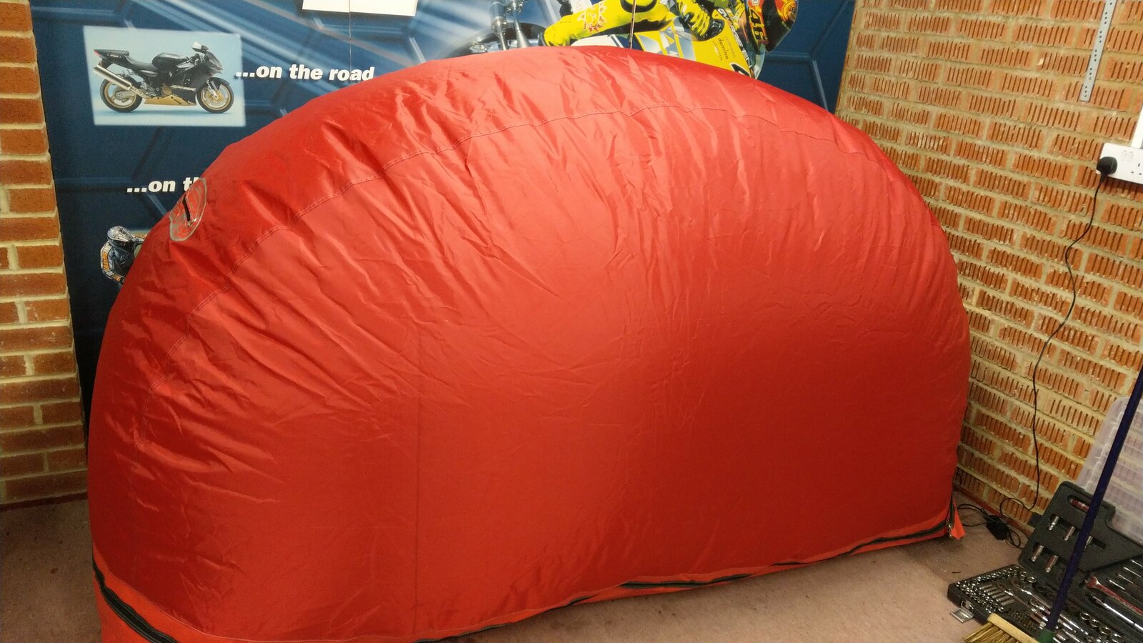

  14. I have a couple of those bike bubble things. My garage is damp in the winter and these babies keep my bike very dry and safe... The newer red ones look pretty cool too
  15. The vacbag I linked or those expensive big bubble things?
  16. Well I got mine from the bay at about 120 each. I bought in the summer and got a good deal. They work super good and keep the bikes dry and very clean into the bargain.
    Not expensive really and a good investment for keeping the bike looking good. ..
  17. I do have a vac bag for my k1200lt but it's a right chew getting it in the thing. They seal up OK with a big cable tie.
    I definitely recommend the bike bubbles mind

    The bubbles push air through the bike 24/7 so there's no chance of condensation
