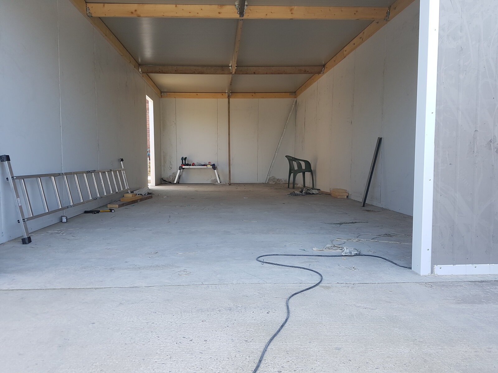

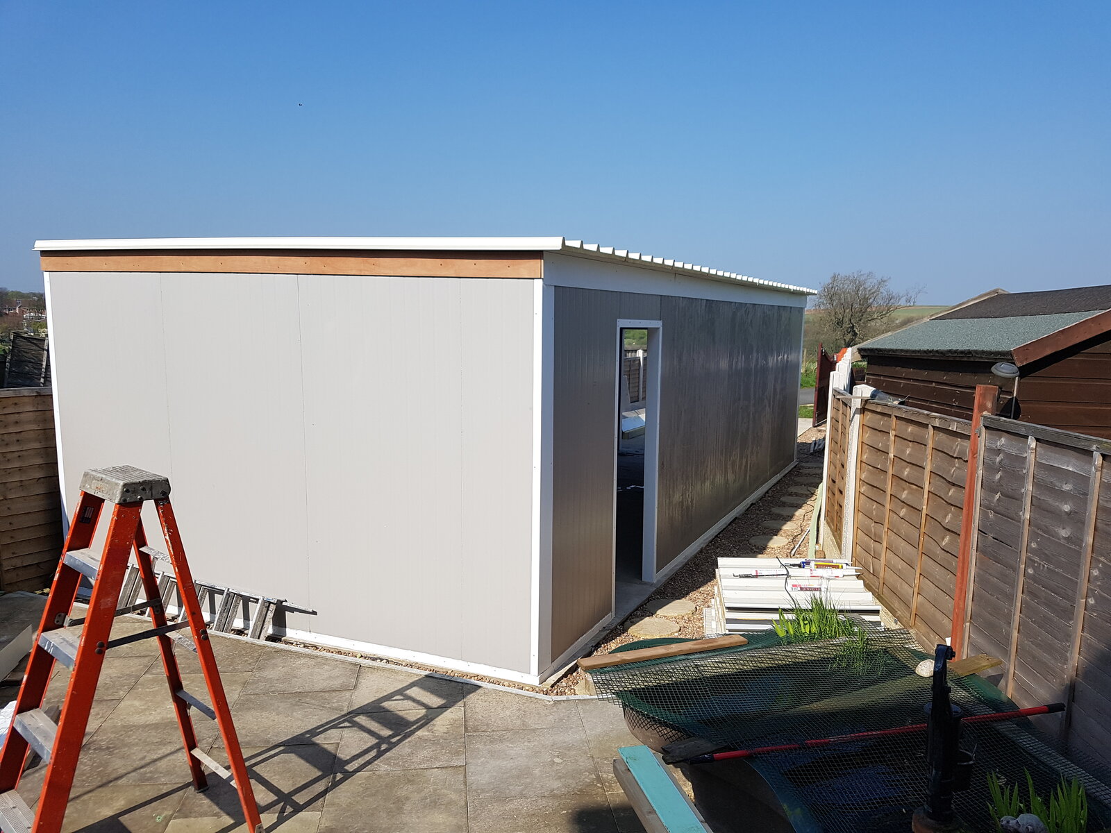

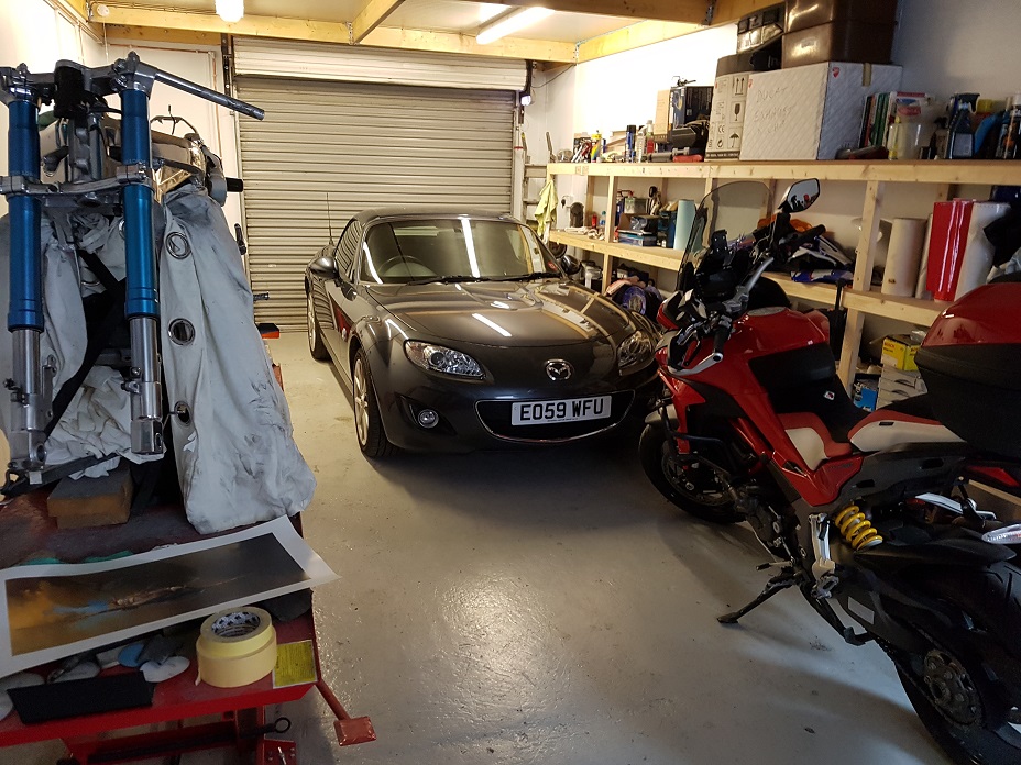

  3. Always had these problems in mind when deciding what to use for my new workshop 2years ago. Ended up using unconventional method that I had experience with through working with Fridge units in factories. The walls are 100mm thick polystyrene with plastic coated steel both sides. The roof is 30mm polystyrene insulated with again steel with coatings each side. Concrete base with floor paint. A few pictures. Sourced all the materials from the net. The roof was new ordered from Foregales at liversidge. The walls were 2nd hand from a fridge disposal company. All delivered to the door. Base & drive was 13 tons of concrete mixed at home with electric mixer. All in for a 4 metre drive & garage at 9 metres long by 4 metres wide cost under 4 grand. All work done solely by myself. Cheap garage & dry as a bone winter or summer. 20170408_145409.jpg small car.jpg 20170408_145452.jpg

  5. Forgot to say all the panels are interlocking so its just a track on the floor & panels slid in. Took me about a week to put up but that was by myself. Guess with a mates help you could get the shell up in a day. I,m an old codger now 66 so you can guess I spent a lot of time drinking coffee. I reckon for a small bike shed without doing 6" reinforced floor it would only cost a few hundred pounds. My theory was the fridges keep the cold in so also keep the heat in.

  8. Looks spot on that. Nice and neat. I used the same roofing from foregales on a concrete garage. It works well and easy to use.
  9. Its good stuff & no CONDENSATION. :p:p:p
