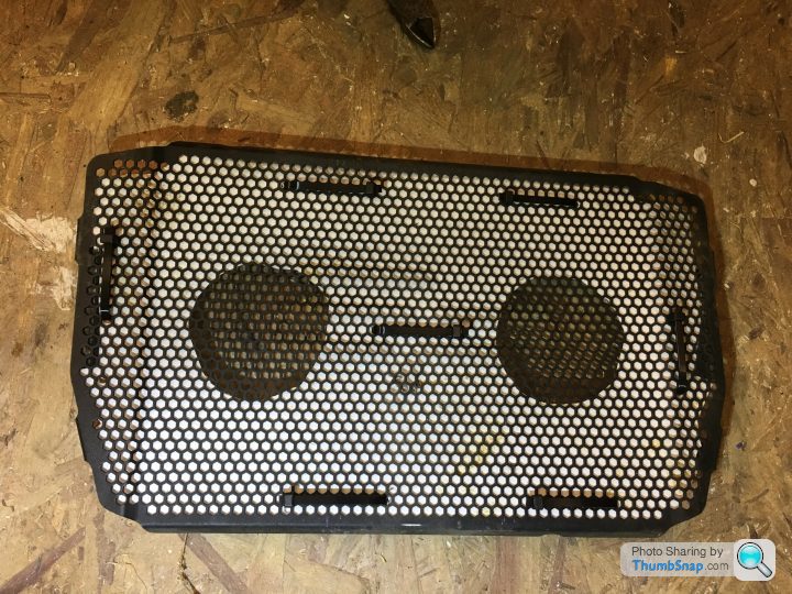

  8. Yes I looked on way home it is C. About 70 odd on way home as warmer ambient now. Clearly causes the issue. I’ve bought a new oil and filter and will probably change it this weekend, and try and block off the oil cooler.
  9. Yesterday I fitted some plastic to the entire radiator area and front cylinder guard. This morning it caused the temp to climb, eventually to just about a hundred on the motorway which was ok. But then to 104 and fans kicking in on normal roads after the motorway. Touched 109 in traffic in the way home so too much (7 C ambient; a bit chilly).
    S otnight I have cut 2 holes where the fans are to let some air through, and enable the fans to work a lot better if necessary. I will see how temps act tomorrow morning.
    Edit:
    The 2 holes made it about right. Temp on motorway up to 90; and then approached 100 when on slow roads near destination
    Pic whole area: (this was the full one before I cut fan holes):
    #49 Coolhands, Jan 8, 2019
