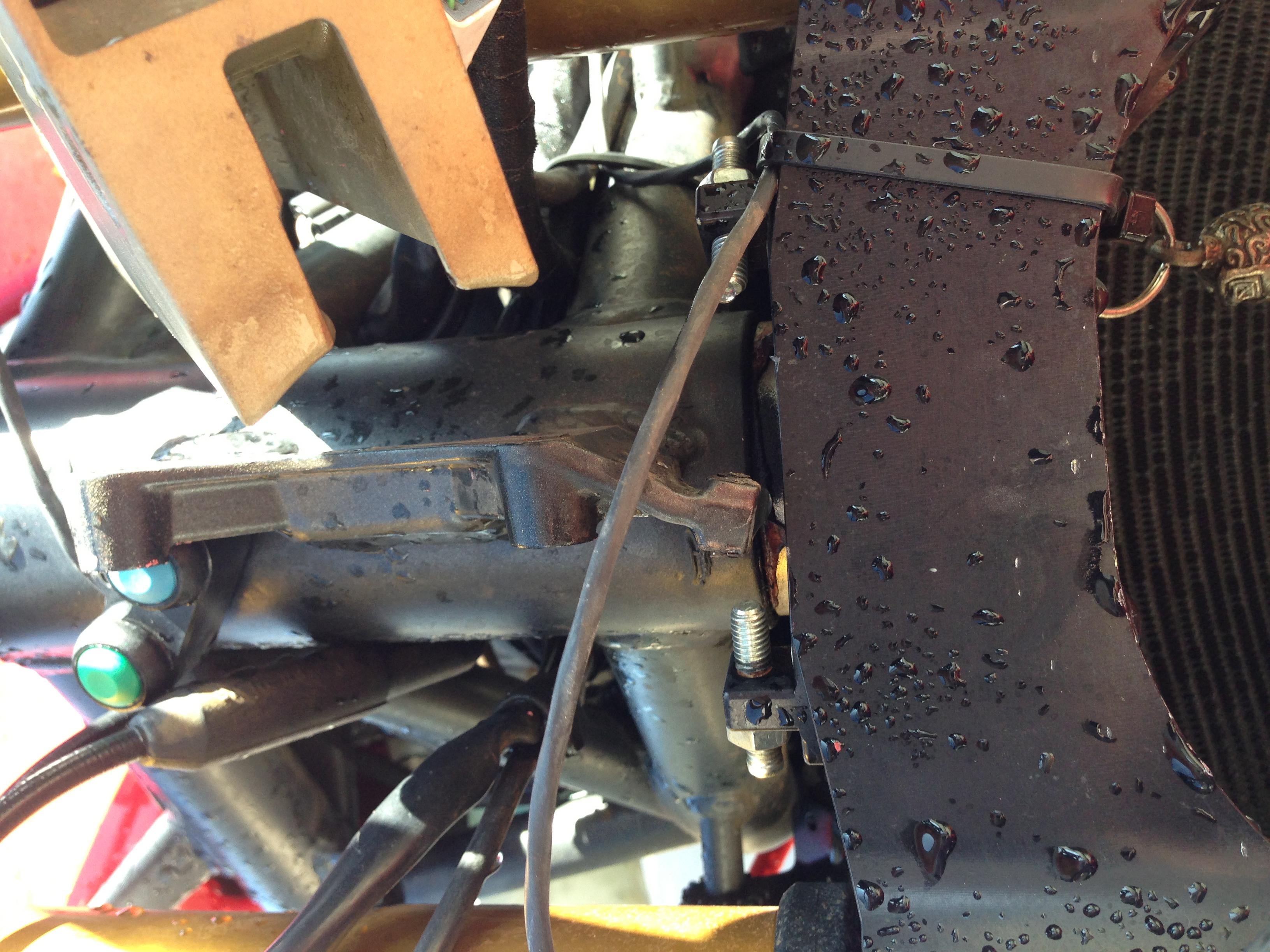

  13. Off topic, Is that a lucky charm hanging off the rad?

  16. saw that also but wasn't sure what it was! - not my bike, just found it on Google to show in detail.
