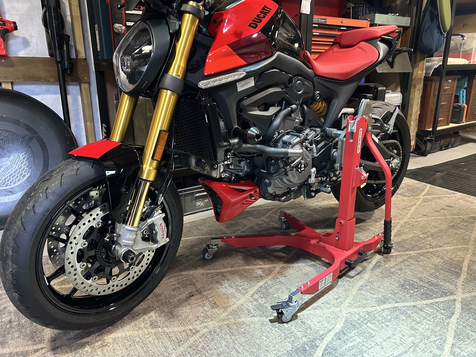

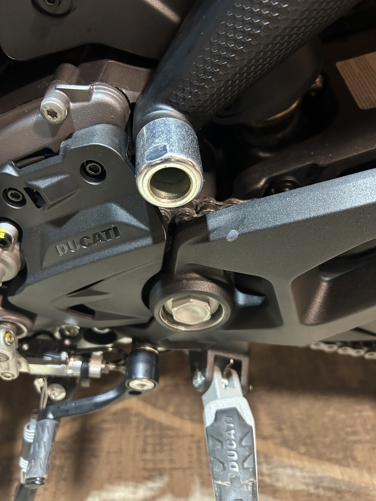

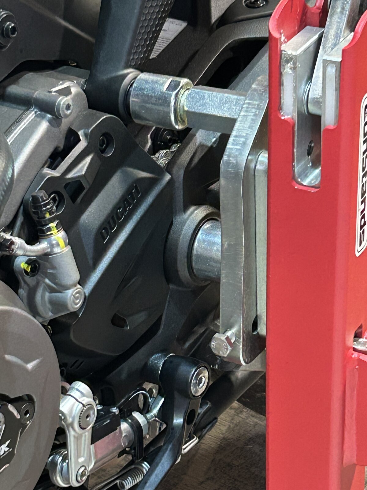

  9. Thanks Steve As it happens I had one delivered today, I decided to give it a try as they offered 35% The stand was £167 and I had to pay £52 tax/duty.
    I bought the one for the 937 and 937+ as the sp was't listed but it fits albeit with a slight lift to initially mount it to the bike

  10. Well done! Try dropping the mounting plate a hole lower and you shouldn't have to lift the stand to get it on the bike. it should still get both wheels of the floor. Use petroleum jelly rather than grease on both the mounting pegs and the corresponding mount holes on the bike, that way it doesn't ruin your biker gear.
  11. Turns out the fixing that attaches to the bike has a thread issue have requested a replacement but I'm not so sure thats going to work either . TBC
  12. I can confirm the constand listed for the 937 and 937 plus will fit the Sp although when lifted its 40mm lower with the sp.
    Have installed the connector and the stand works and will be useful when cleaning etc although
    I find it quite awkward to connect up and I would have been happy to pay a little more for a better thought out connection that looks better on the bike maybe using nylon bush as it would be a kinder to the bike when having to wiggle it on and off. Mine cost £167 with the 35% discount motea offer if you add it to your shopping cart for a day or 2, duty was an additional £60.
