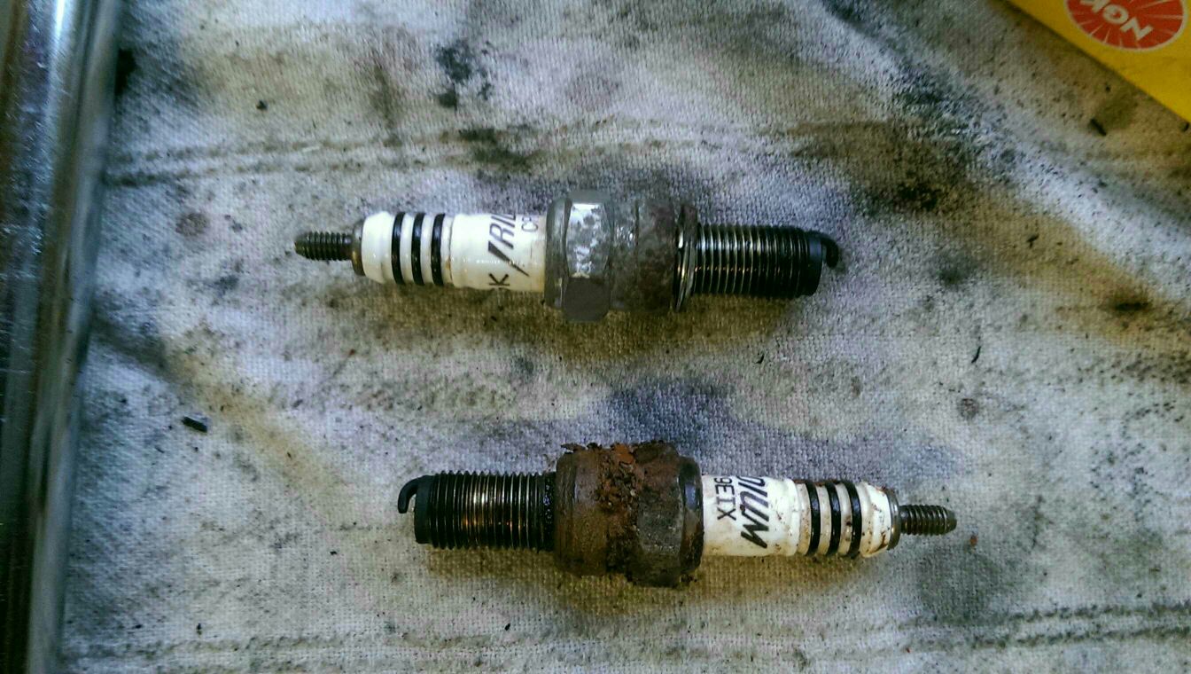

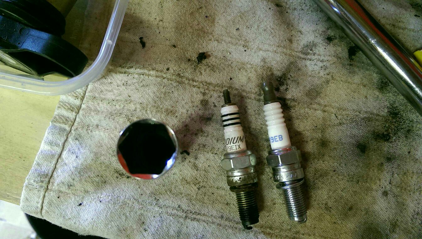

  6. She worked!!!
    Next question: plugs I bought have the bulbous end which won't unscrew. The ones I'm removing have the screws showing. Are both ok without modding the coils?
  7. Excellent news that the plug spanner fits - perhaps you could put a post about it on the 749/999 section?
    Are you sure the top doesn't come off the plug? I can't help thinking it's probably just very tight.
    If the coil is working properly with just the the threaded portion, I can't see how it can work with the top in place.
    The iridium plugs you've taken out are designed to last for tens of thousands of miles without attention, so although they look cosmetically rough, I'd be inclined to just stick them back in. If you do, do not alter the gap!
    They should give a fatter spark than the others, so improved starting, idling and throttle response .
  8. Some plugs or version of the same plug type, Nippon Denso being an example, have moulded tops to the plugs and these will not unscrew as they are solid.
    If it is clear that you do not have a removable screw top to the plug then you will either have to "modify" it in some way, change the cap or machine off the top of the plug cap and either thread it as per an original or machine and knurl the top of the plug so that the cap will fit over the plug correctly and grip it in the correct manner.
    I have been caught out like this before so it is always best to check the top of the plug before purchase.

  11. They do look as though the bikes been running a bit rich.
    Steve
  12. Good point. I'm guessing the really bad one came from the front...
  13. Nope top. I was surprised.
  14. Wow, must have been used in loads of rain... :/
  15. I think it was put away wet/dirty and left. For years at a time. I'll make her whole again.
