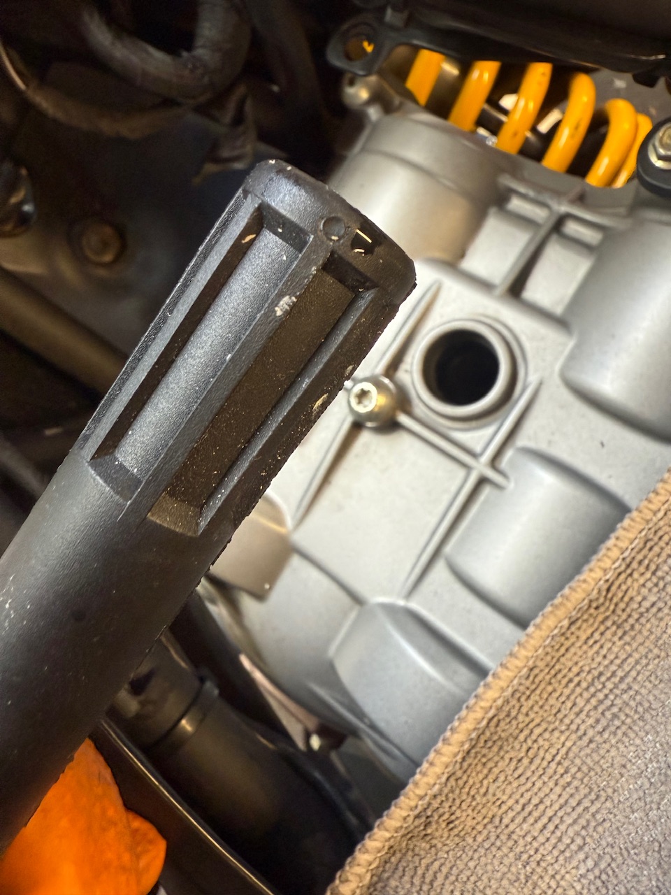

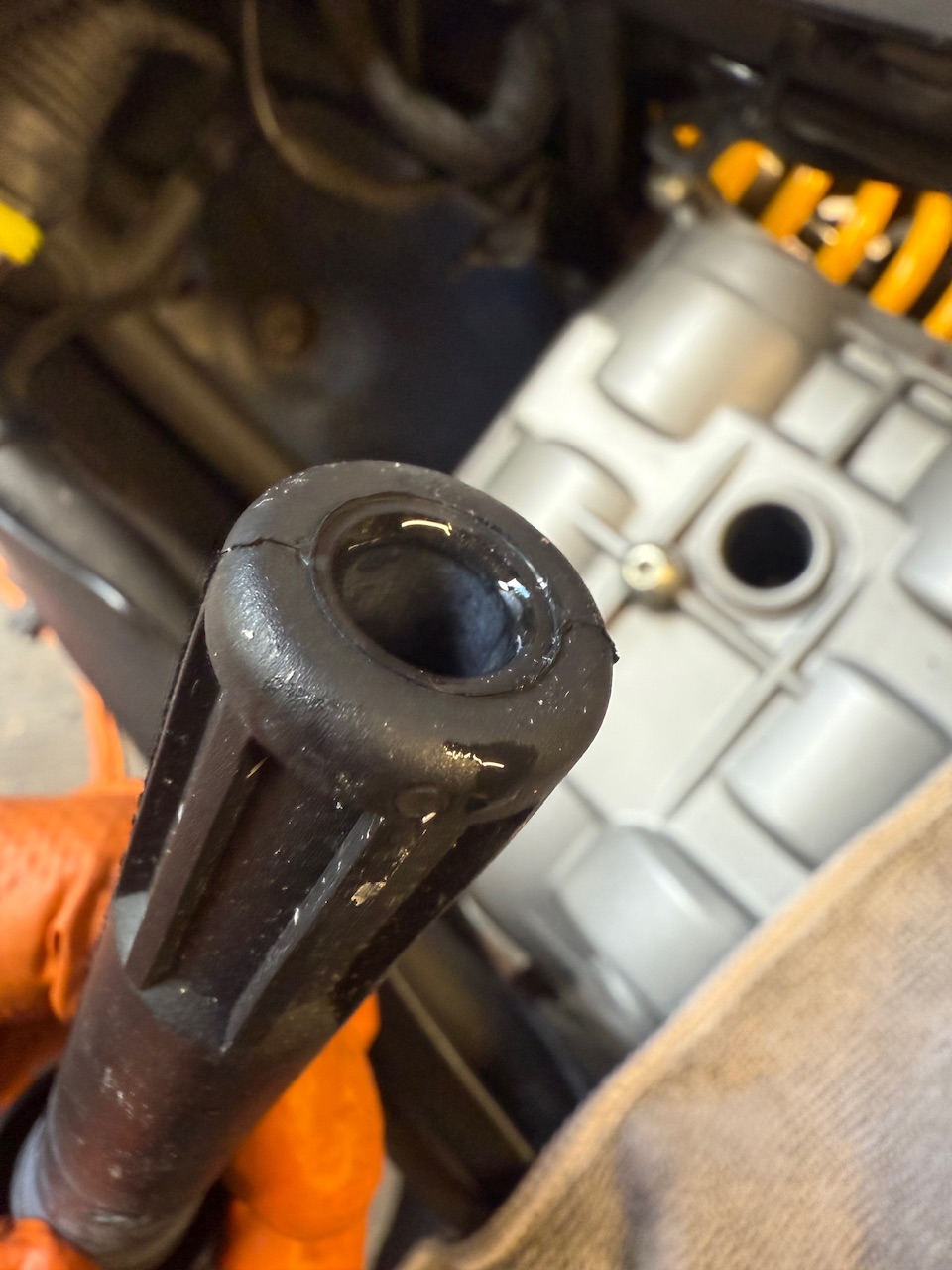

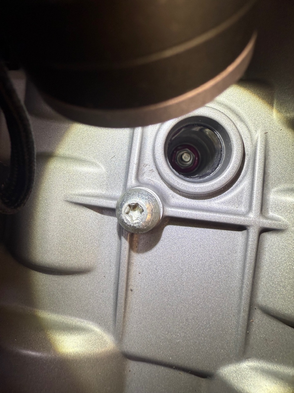

  1. Here’s a novel one. 2015 Panigale 899, 12200 miles, same owner since the bike was bought when it was 6months old. The owner has reported coolant keeps getting into the spark plug channel on the vertical cylinder. You can see the wet marks on what was a bone dry, and clean, plug cap plus if you zoom in on shot down the channel/hole you’ll see the pink coolant collecting around the spark plug.
    How can that be?
    I’m struggling to understand how coolant can get there, other than be getting into the combustion chamber, not being burned off, but being forced up and around the spark plug threads - a tall theory perhaps, but read on.
    The bike also has either a faulty thermostat (Squirter unit as Ducati call it on that bike) or a failed water pump - due perhaps to the plastic drive wheel having lost all its teeth. This is evidenced by the engine temp rising, the fan coming on at 105c as it should but the temp keeps rising until at 120c I switched it off. Both rads were only just above ambient air temp at 27c.

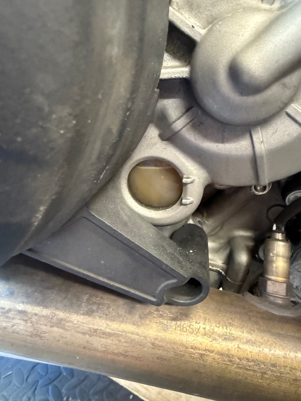

    And, judging by the oil window there’s coolant mixed with the oil.
    So, I’m thinking, blown head gasket.
    I’m also thinking running an excessively hot engine (he uses this as a track bike and it was news to him when I informed him its overheating, but I guess he’s focused on the track ahead not the flashing HI on the dash) has caused the head gasket failure but would that explain the coolant in the plug channel ?

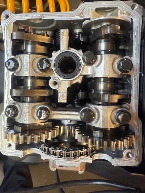

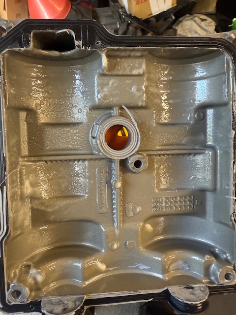

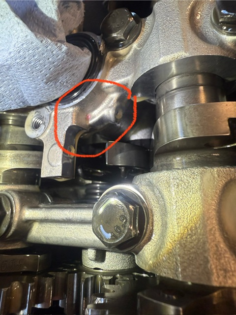

  12. I’m going to put up a load of photos here. I took the V valve train cover off today.
    As was expected it’s full of watery emulsified oil.

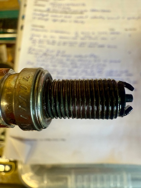

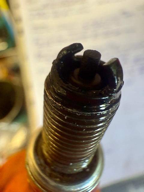

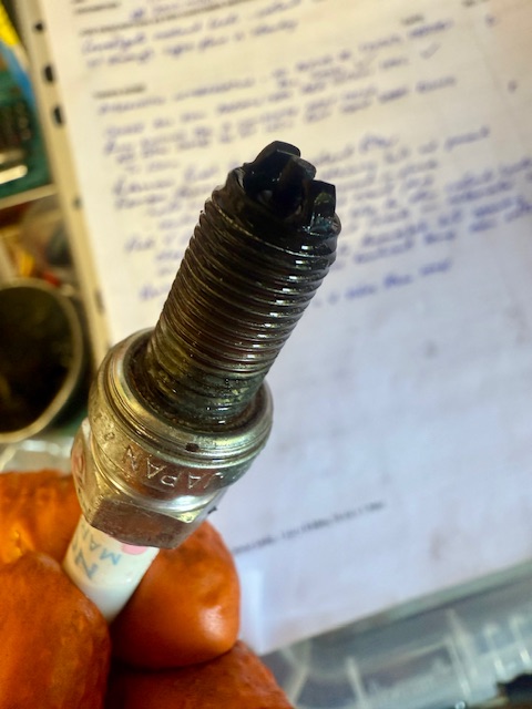

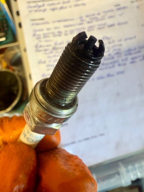

    Having dried out the spark plug hole I also pulled the plug, it was soaking wet, wet with what suspiciously looked like coolant and not just wet at the electrodes but over the length of the thread too.

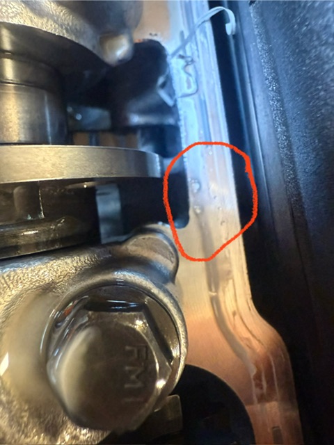

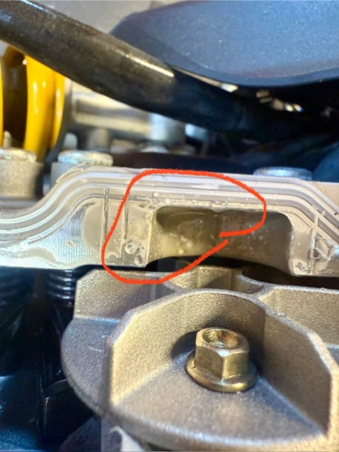

    Inside the valve train were droplets of what looks like water and a distinct droplet of coolant.

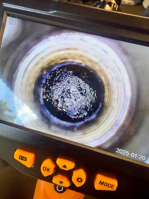

    And, the head of the piston is soaking wet too.
    That’s taken with the borescope down there.
    Yet, the V cylinder runs [​IMG]. I checked the manifold temp yesterday, it’s the same as the H cylinder, about 270c.
    There are no obvious and apparent cracks I can see with the borescope. I suspect the head gasket has gone hence unbuned coolant in the chamber after the engine is turned off. Clearly it’s f&&ked big time [​IMG].

  13. Pressure test the coolant system to locate your fault. You’ve got a multitude of problems there. coolant in the head = cracked or porous casting. Water in the combustion chamber = either head gasket or cracked/porous casting.
    Is the water in the combustion chamber from when the plug was removed? If the head gasket was leaking I’d expect the combustion pressure to overcome the rad cap pressure relief valve and it would piss coolant out. Either way. TLC needed.
  14. Ok, stupid question coming up... why are there (separate) water & coolant droplets in the valve train?
    Can these come from different sources or do they both come from the coolant (leak)?
  15. Good question.
    Perhaps it’s condensation from the moisture heavy mayonnaise like oil. That causes the propane glycol antifreeze mix to separate? Or the water has vaporised and left the antifreeze behind then reformed to look like clear water droplets. I’ll be honest I’m guessing.
  16. No, I was very careful to soak up all the coolant, which had formed around the spark plug, with workshop roll before removing the plug, specifically gr dude I didn’t want any of that coolant to drop down into the combustion chamber.
