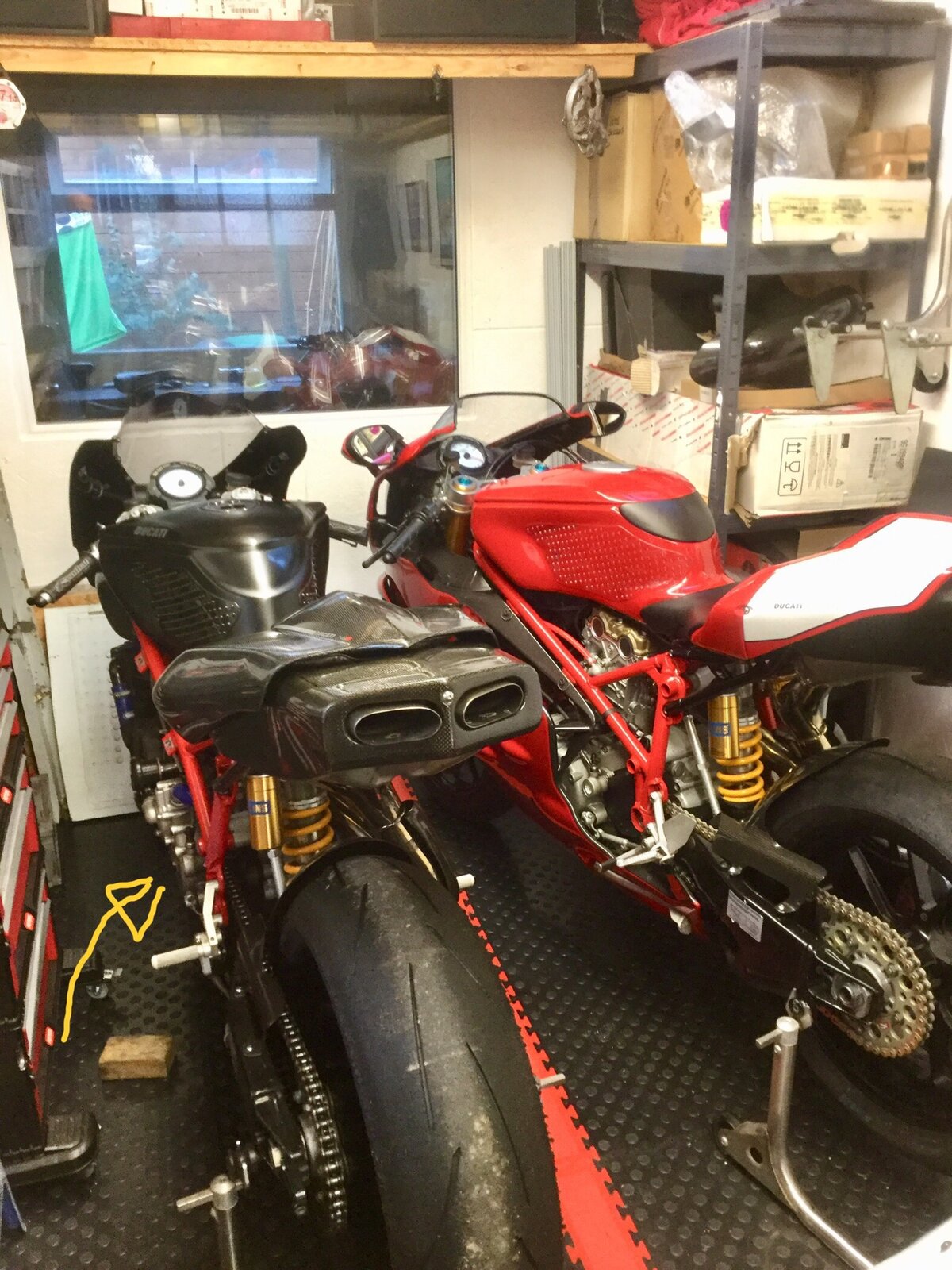

  2. Arrow shows the location plus blatant excuse to show my R’s(e)!

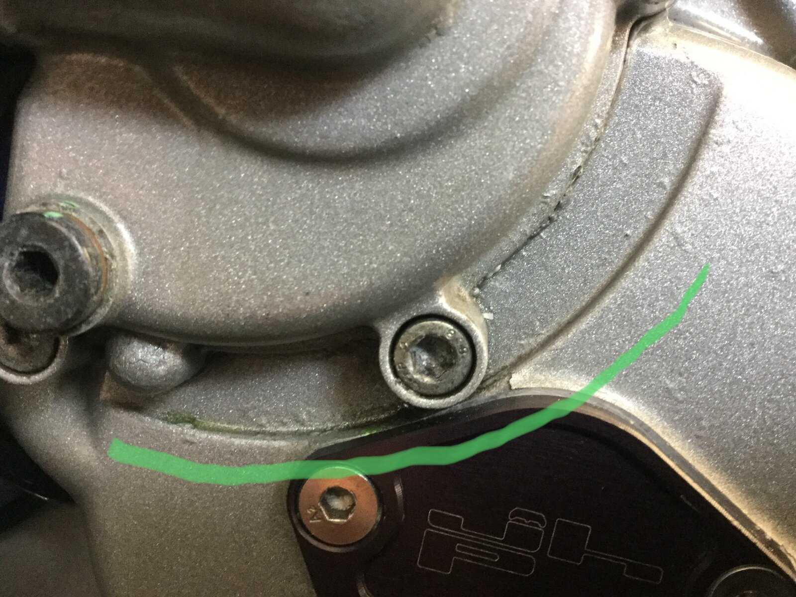

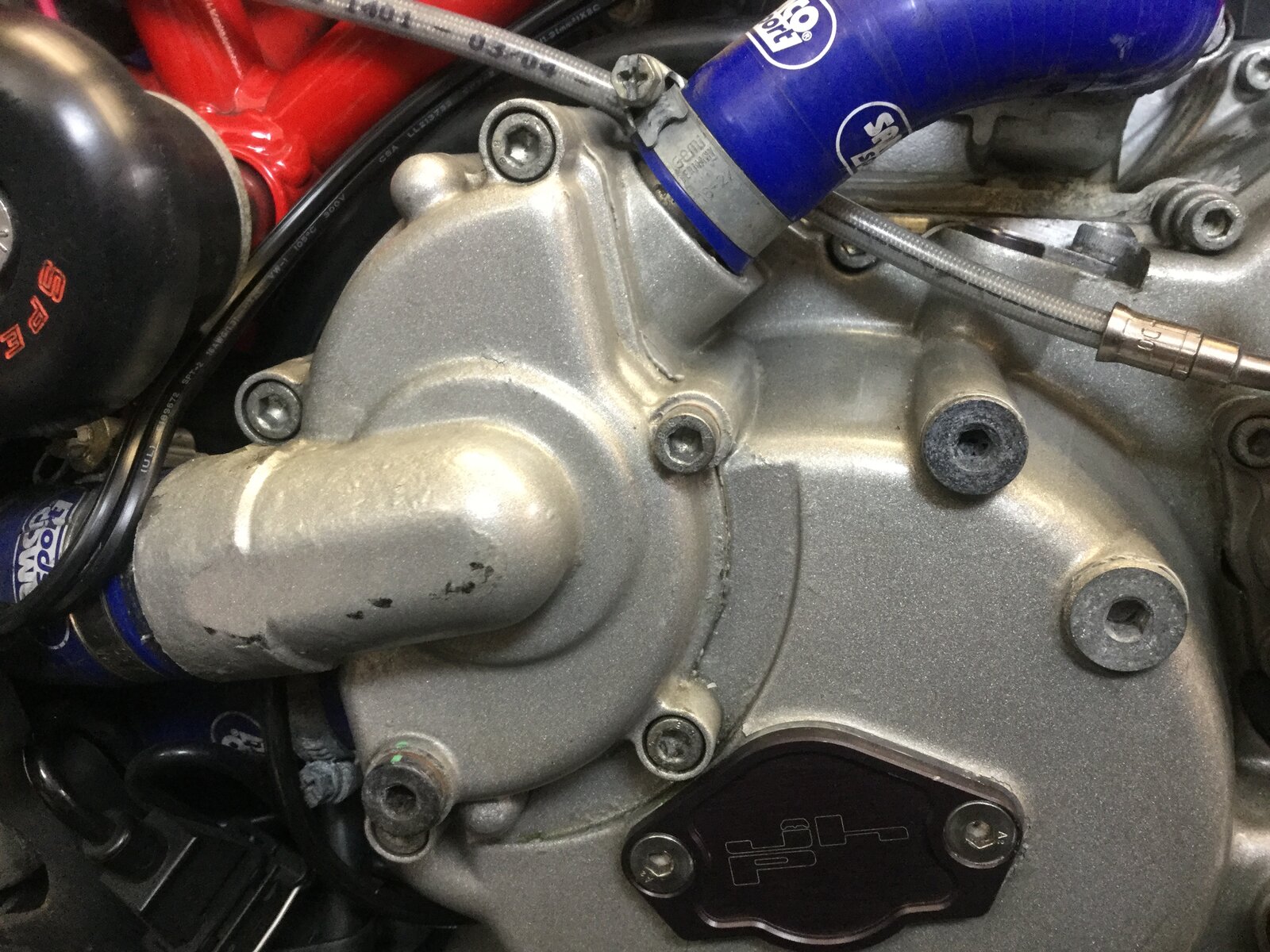

  4. It’s not coming from the drain plug. It’s further aft than that, along the curved rear edge.
  5. A closer picture...…… Please......
  6. C3A21F09-310B-42EC-979C-833C602ED886.jpeg 6BA5DA21-4870-4E84-BBD2-FFB042B99539.jpeg
    Here you go. Coolant is greenish, resting along the curve in the casing.
