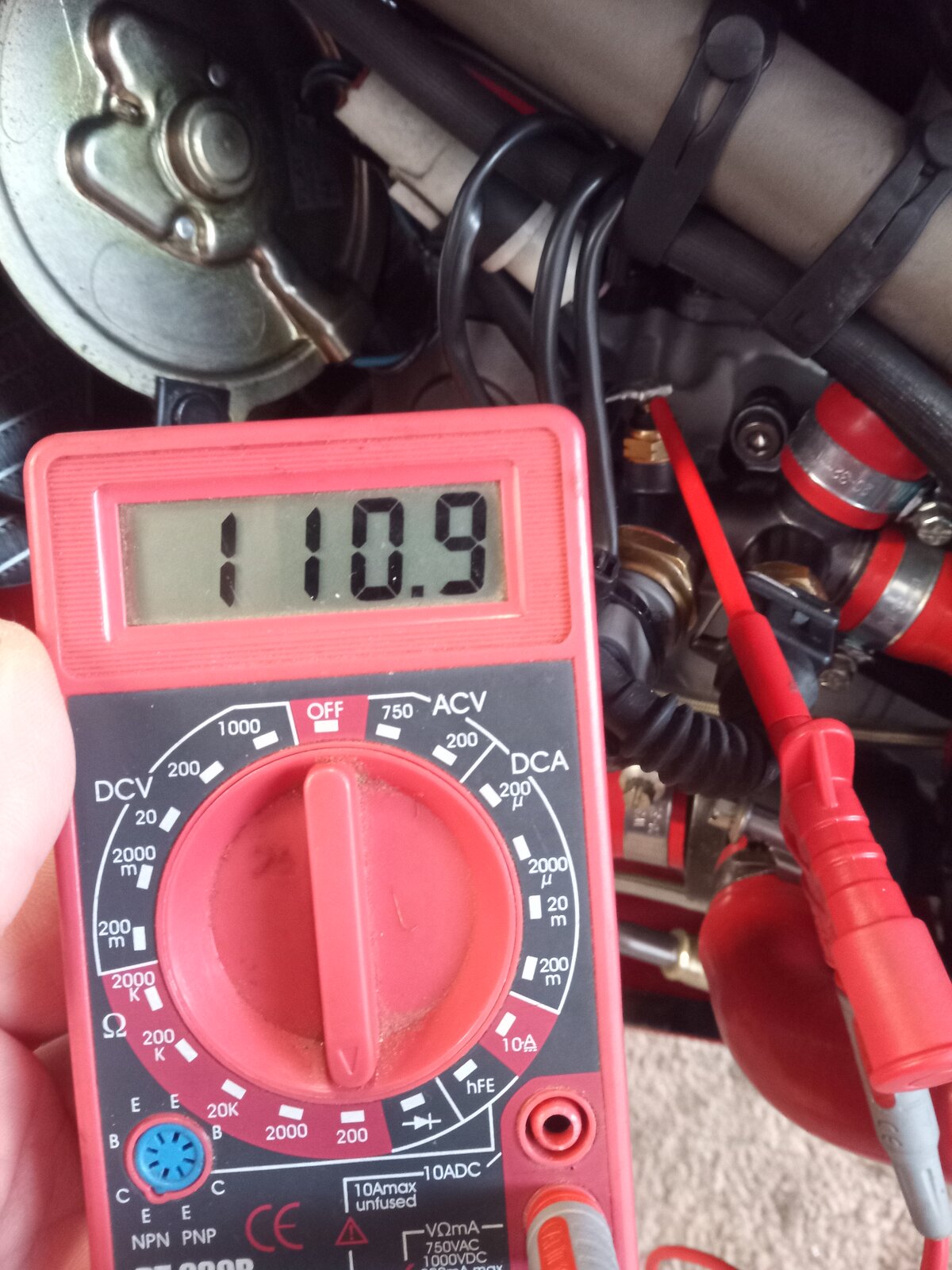

  6. Took me a while longer. At ~12degC I measure 110 Ohm. IMG_20240331_140511_604.jpg
  7. Cheers for that mate. I’ve ordered one of the ones you gave me the link for.
