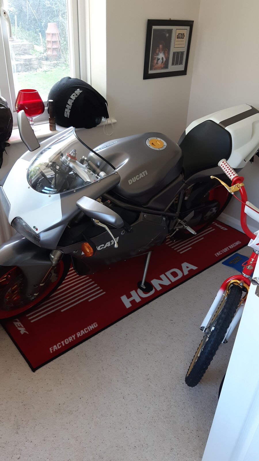

  5. lol.... it's only temporarily sat on this mat..... ducati one will follow in due course.... cleaned myself out on the ducati.
  6. Thanks! I am very pleased with it.... tinkered yesterday and got the temp gauge working ... seems the earth is a bit iffy.... odd as you would think it would earth fine to the rest of the engine .....earth strap is intact... just seems that the piece the sensor screws into is insulated currently.... will fiddle more once paddock stand is ready for use.

  8. That is nice .... I need to get the red pinstripe perhaps for rear number boards .
    It's a shame the previous owner hasn't popped up.... would love to know what happened . To the bike and the service history!
